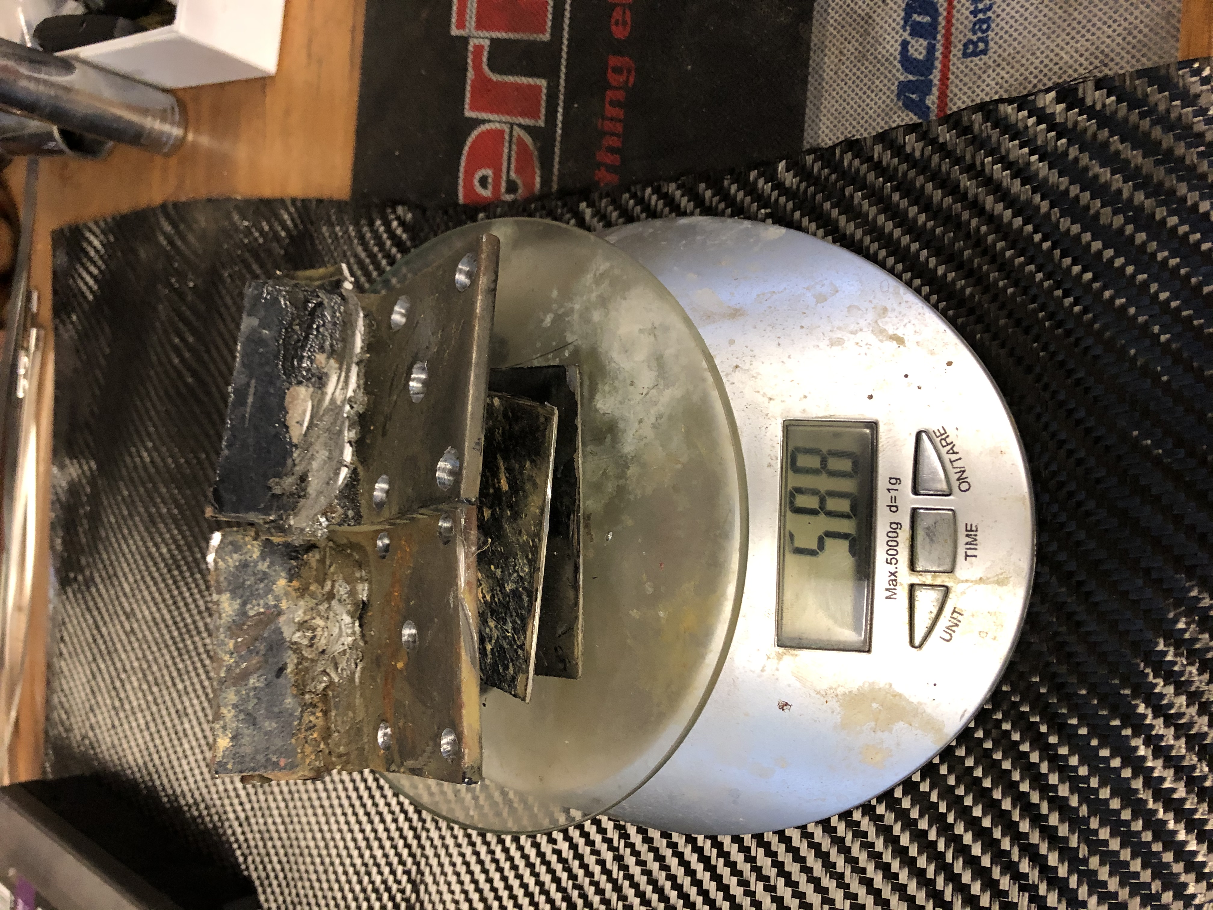

I've also been collecting and modding parts to build another gearbox (getrag) with only first, second and reverse. The parts that I get to toss so far add up to 12kgs
The carbon fibre matting in the back ground of the first pic of the last post is to experiment with, I'm going to start simple and make a new roof number plate.

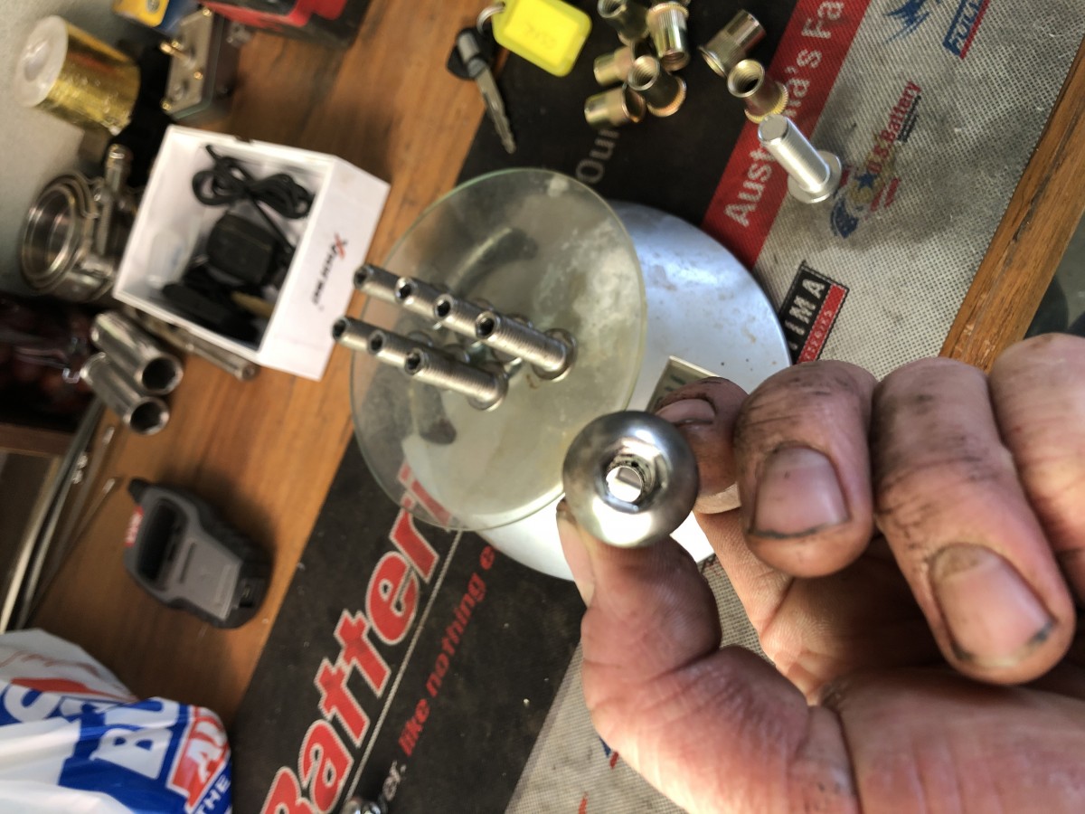

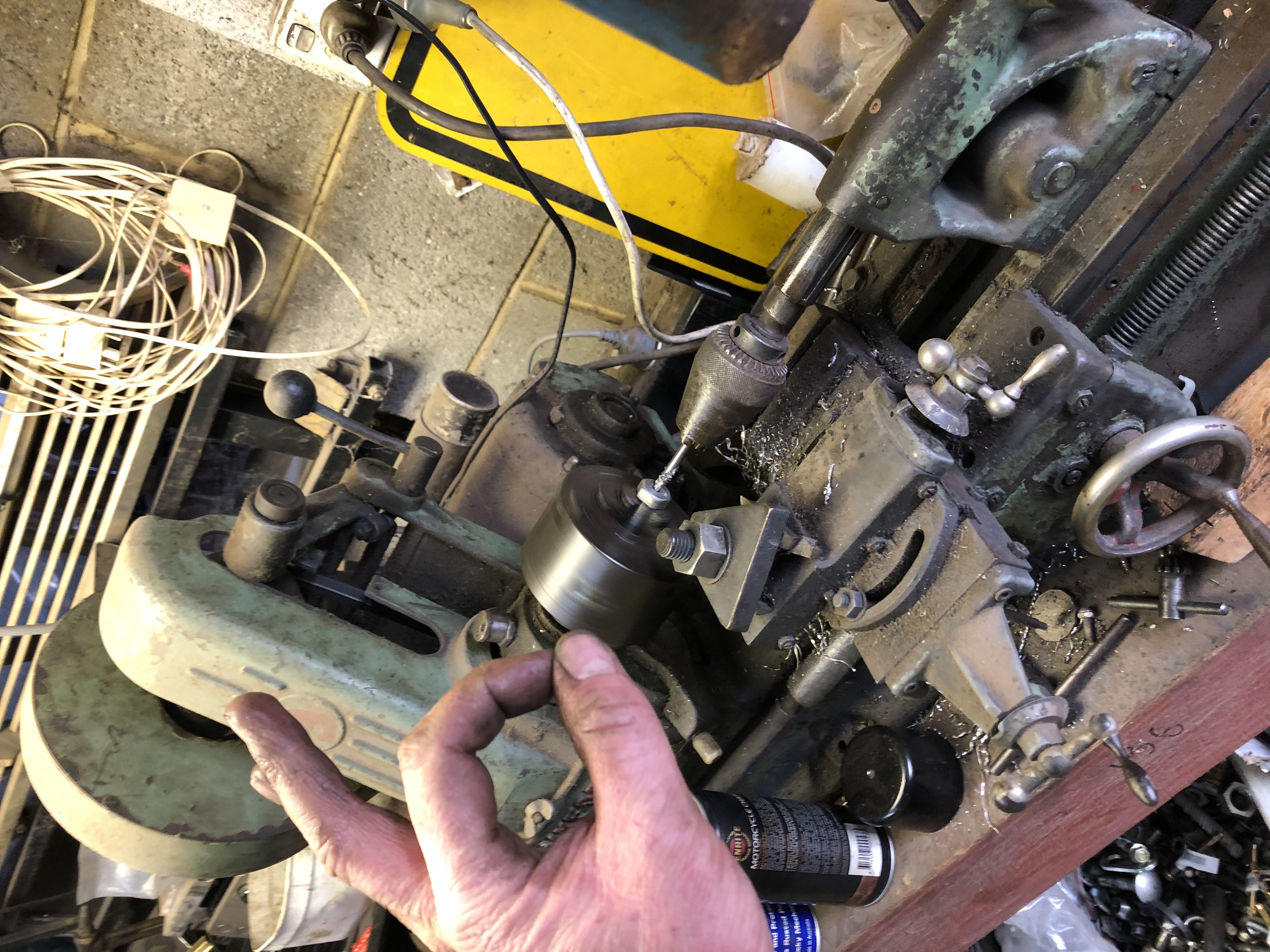

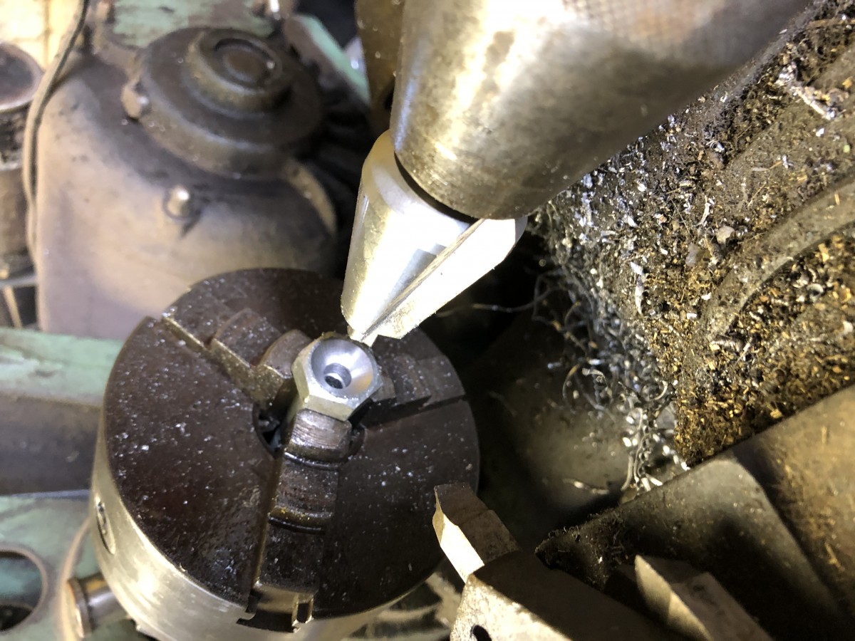

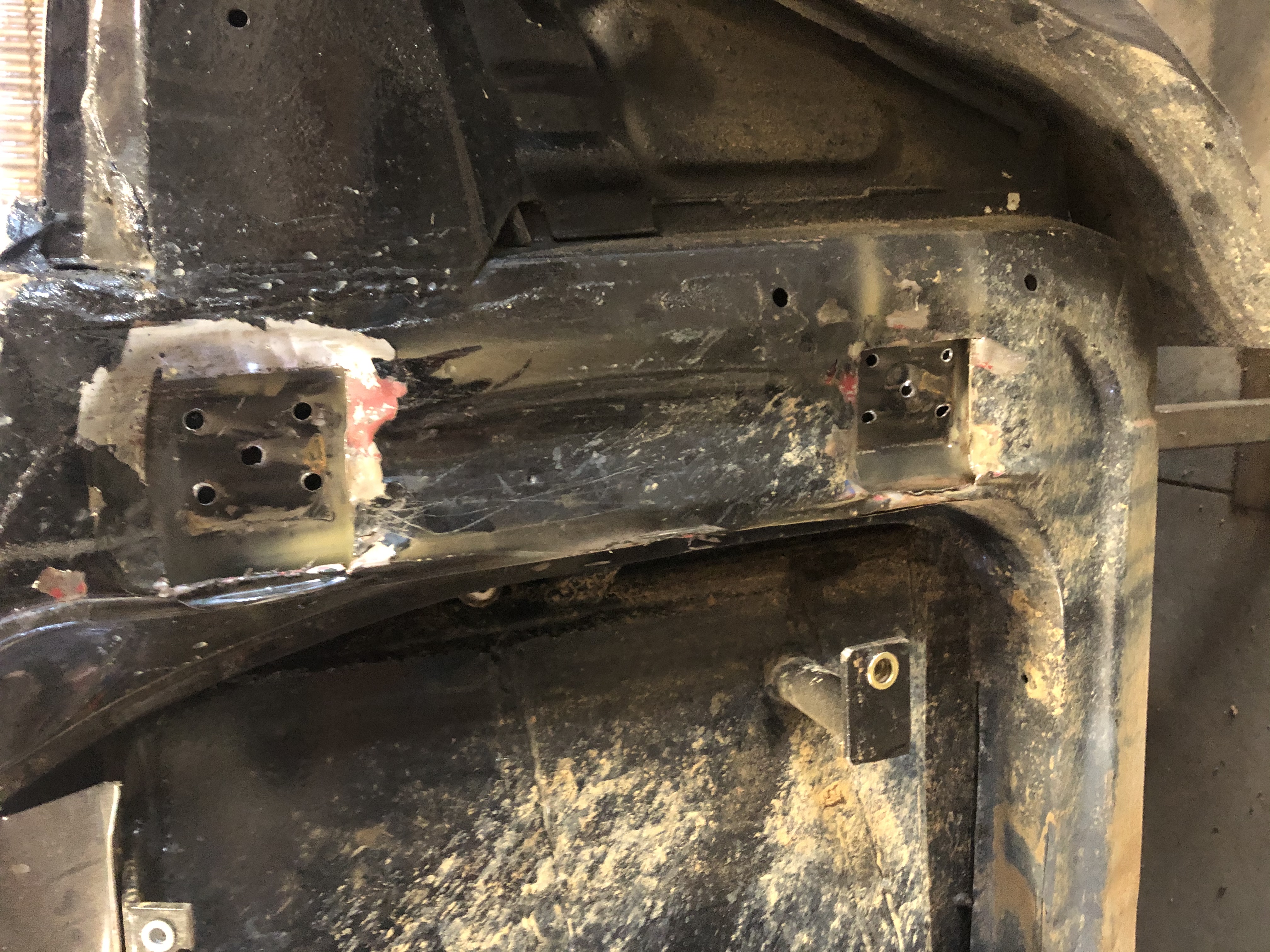

I have replaced all body attachment points that would have had nuts on the back of them with rivnuts, this achieves two things, less weight and easier servicing.
