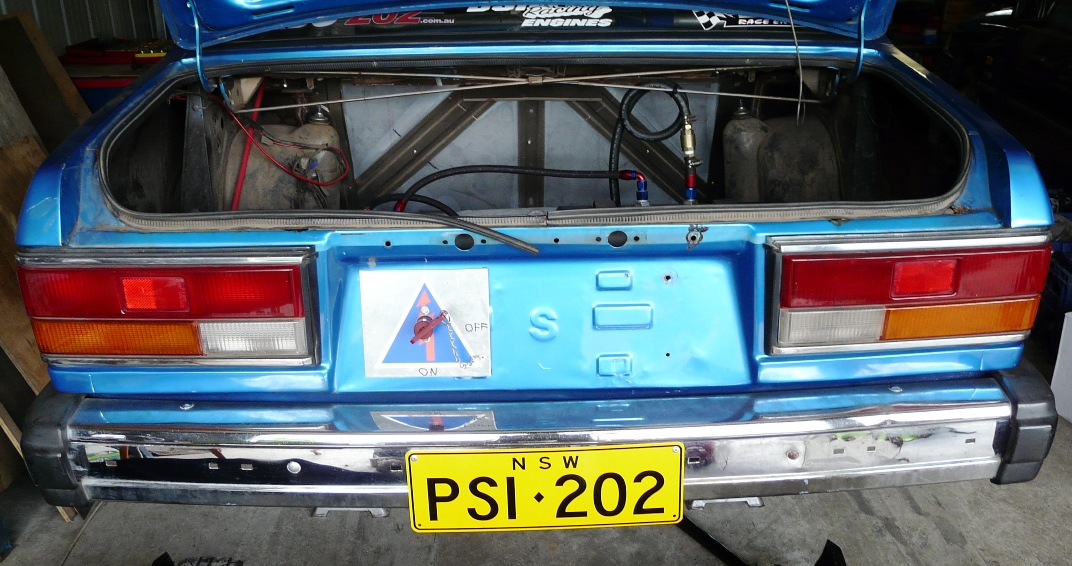

ahahaha correct delzowizzid, $50 each they are and from what I've seen the Y joiner is too, my plan is to put it in the top of the filter and then double the current pump to filter hose!!
and I can tell you now, just the surge tank, pumps and fittings I've had to get to change it all is approx. $800! that doesn't include any of the rest of the fuel system! but the speedflow fittings sure make it look tidy and are easy to work with!

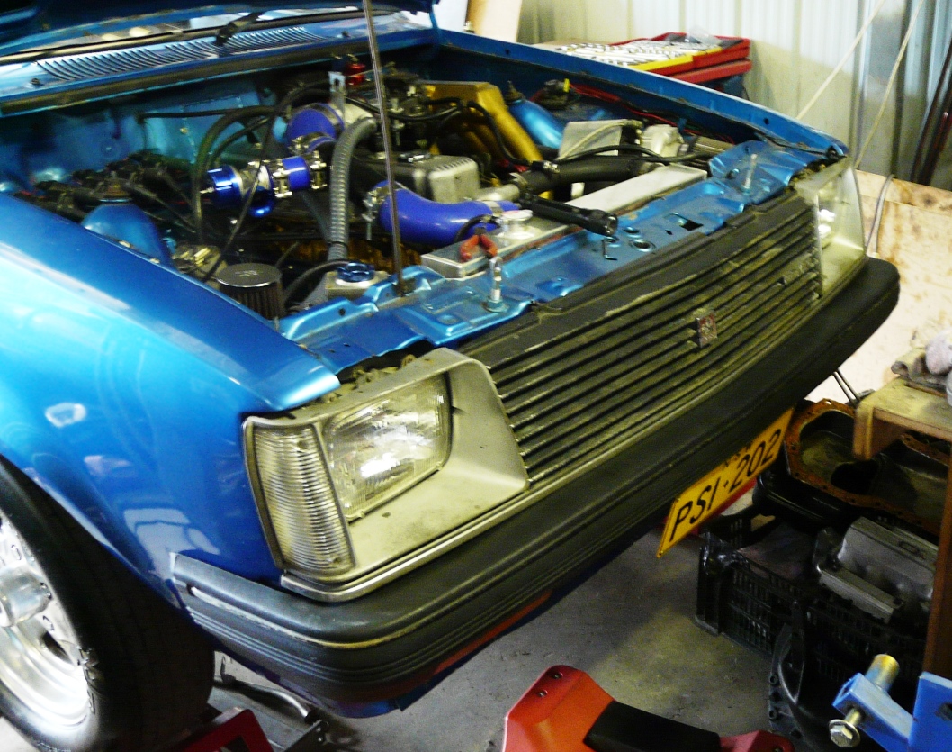

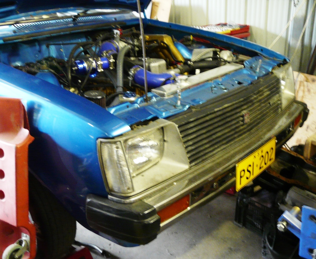

well I got some pretty cool presents for Christmas, but most don't relate to cars or delcos .... but I did get some bumpers for the Gemini!
when I originally went looking at wreckers I only found one Gemini suitable and it was a TE, my car is a TG, no real issue other than I reckon the TG bumpers look better plus they are all plastic so more suitable for a race car!!
so anyways my brother managed to find a set of pretty good condition TG bumpers in Sydney area just in time for when he and dad went to Sydney to pick up a new caravan 4 days before Christmas! So I now have new bumpers and probably 10kg weight saving :punk:
now all I need is a mint TG Grille and i'll be laughin!
