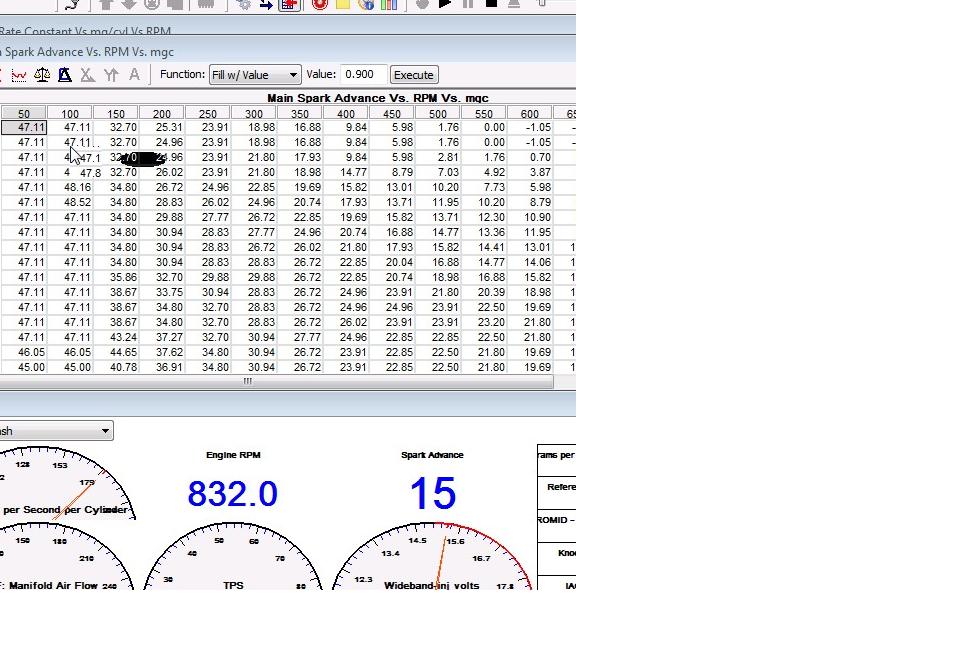

202 theres no timing pulled when its rich. with the updated xdf ive been able to play with all the torque management and burst knock.
with the real time setup working a charm, im planning on booking the dyno (80km trip) for an hour or so in the next month.
been setting up the xdf/adx for full data tracing, but im unsure why the main spark table tracing doesnt seem accurate. it uses the same adx link as the injector constant table etc which works great. title mg/cyl, data type mass a/f, stock units gp/second.
any ideas?
this snap was taken at steady rpm whilst playing with the idle and wotnot.
Re: basics of tuning delco non $12p
Post by krusty »
Ken, there is a setting that retards commanded timing by a negative value under certain conditions. eg if you have commanded 30 degrees timing at a given point and the criteria for this parameter have been met then the parameter value of -10 (eg only here) will give you an actual timing of 20degrees spark advance.
Sorry for all the vagueness but it' caught me out before when setting up idle on a cammed L67
