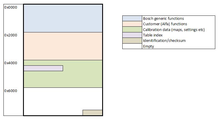

That's a left-over from the first generation Motronics, where the Bosch code ran from internal ROM and the customer code/maps ran from eprom.
This is a very high level overview of the ML4.1 eprom layout (no internal rom on these)

That's pretty much where I'm at now.
IDA likes a program start from X2000h if I run a procedure decode from x20e0h it decodes most of the program leaving the calibration area as uncoded.
The first lcall after x2000h is to x8000h changed it to x0000h and it decodes :-).
There's still some wired stuff but getting closer all the time.
