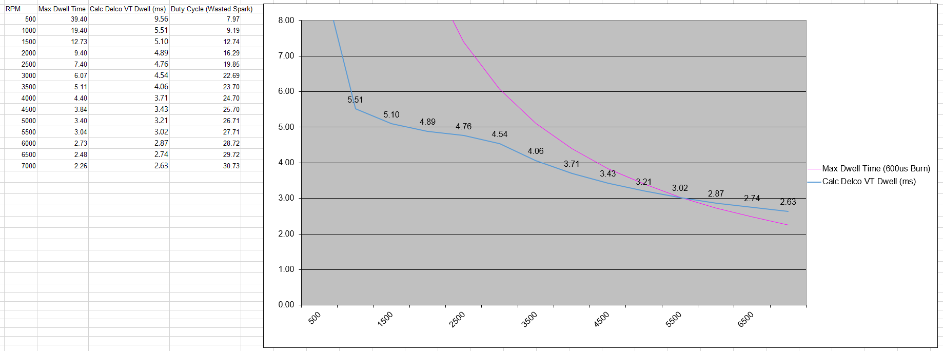

Can anyone confirm the factory dwell time on a VS Ecotec? Setting up VL400s coil driver with some monster coils and treading carefully
Re: LSx Coil Driver
Here you go, all V6s are the same from the bins I have checked of various models ...
