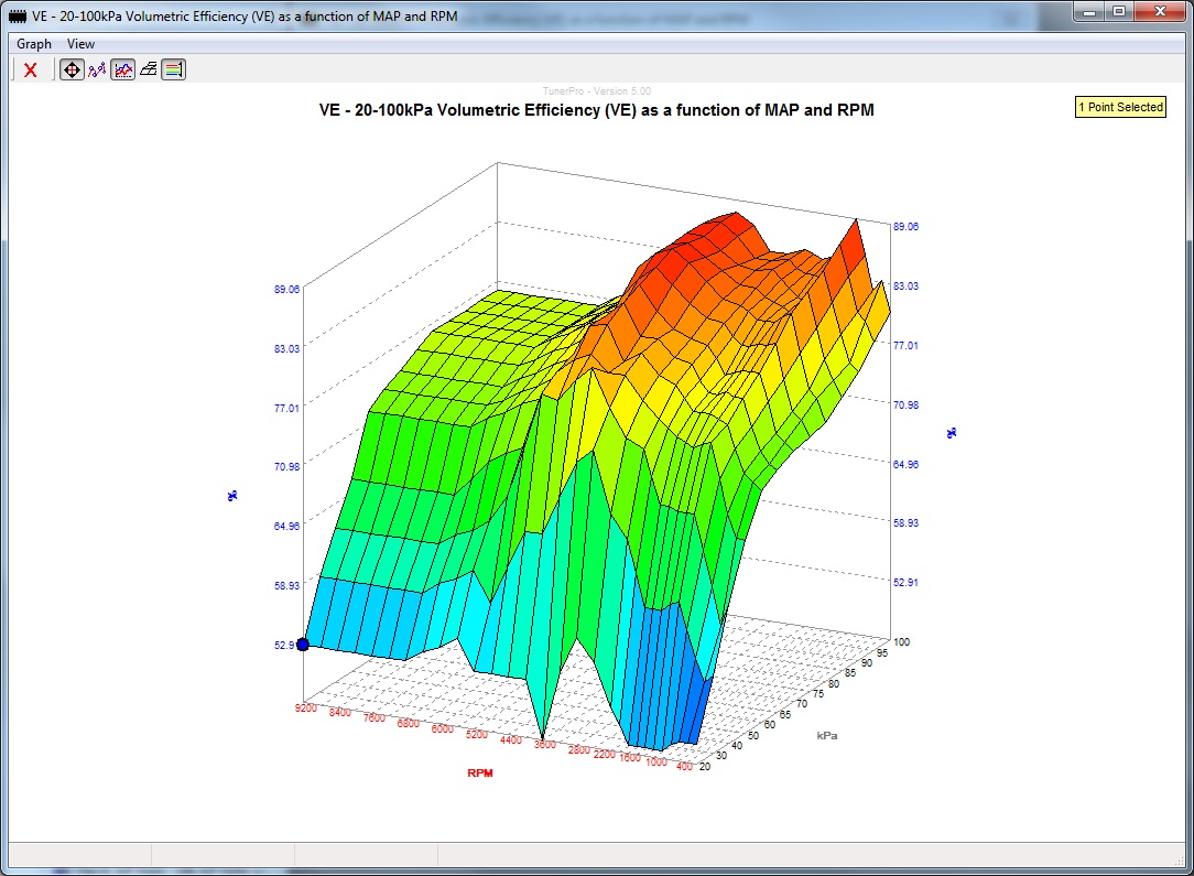

VE Table Help
Re: VE Table Help
This is the one I'm playing with delco.
Re: VE Table Help
for starters, get the entire 5600rpm row and copy it to the rpm rows above it, this will scale your graph to a nicer to use one, and you probably want roughly the same fuel there anyways not none!
honestly i have never used the smooth feature, but in this ones case i would be looking at the dips, if all the dips are the ones that were changed then you probably need to lower the ones around them that wern't changed.
alot of it is just getting to know it, if you lower an area and its too lean you'll really know about it, however if you are unsure about a massive dip, put it back up to match the cells around it and then re-test .... the key to getting smooth changes is a BIG log, with lots of hits of every cell then using the histogram average. this will mean if you hit a cell 10 time and one out of 10 is really leaner than the rest, at least the change wont be as severe as its an average of the 10 hits.
another thing i can see in your example, it looks like 3600-4400 or there abouts, 30-60kpa ?!?! its really low compared to everything around it, so either that whole section has been changed and the rpms below that need lowering aswell, or the rpms below and above it are right in which case that whole area needs to be increased.
just out of interest, how have you come to this result, is it from wideband logs or using blms etc ? then plotting on a histogram ?

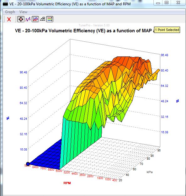

Re: VE Table Help
Yep, holden202t's advice is good. Also the logs get less accurate the more spikey the tables get as the logged data is logged against a cell but the ecu might be interpolating between two very different values right next to each other. Thus the result that ends up on the center of the cell can be affected a lot by the cell next to it. As holden202t said, you need to look at it logically, work out whats meant to be changed and whats been missed and smooth it out. I would do it by hand, but if a tool gets the result, great. Once its smooth, take another log and the results should be less spikey as the table was smoother to begin with. And repeat untill the wideband is good and the table is smooth.

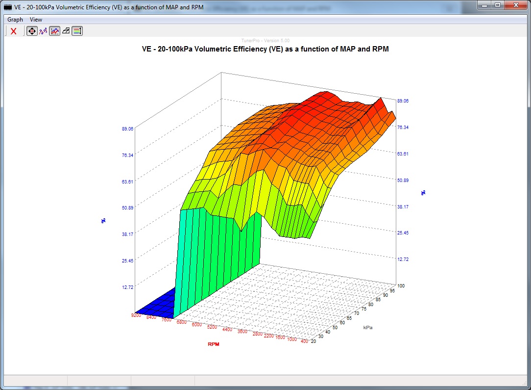

Thanks for your advice antus and holden202t. The previous screenshot is from a standard vn v6 ve table that I changed on purpose to make it leaner. I done this to try and educate myself by doing some wideband datalogs and going through the process to get it back to standard again. This screenshot is where I'm at now. I think it's an improvement.
- Capture2.JPG (75 KiB) Viewed 3683 times

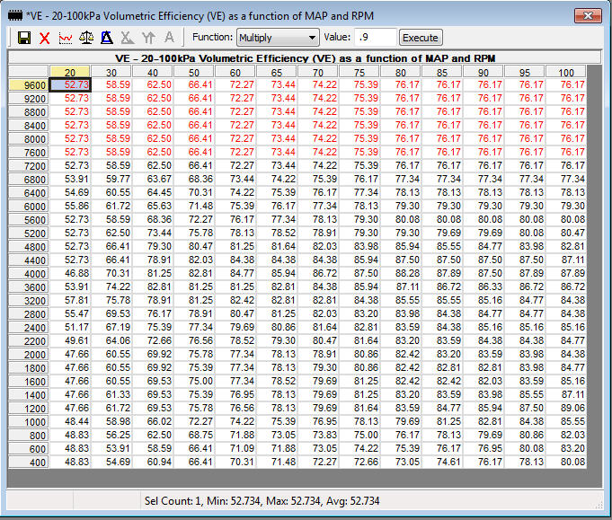

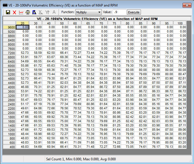

that's looking a lot better.... however the end of the table (left) is not quite what I meant .....
so this is a standard $12P V6 tune, straight out of the zip file, as you can see it has the same drop off above 7200rpm.
so I got the 7200rpm row and copied it to all the rows above, and as you can see below you get a much better scaled graph view to work with.
it may never go to that rpm but if nothing else it much the 3D view look better and it can only mean the engine is rich that high in the revs if you do take it that far!
