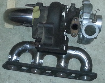

I've been (very) slowly working on building my turbo manifold.
When I decided to go up a size in primaries, that caused clearance issues with the exhaust studs.
My custom brass nuts gave me an extra millimeter which helped a fair bit, but I still had to do a lot of cutting and grinding to give a couple of the nuts enough room to be turned.

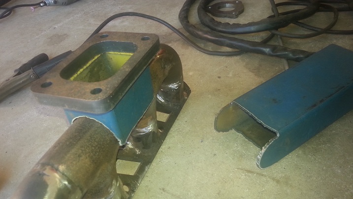

I plasma cut a rough log-to-turbo-flange join from some 50x75 RHS - it will need some trimming once I work out exactly where it will go:
I'm glad I did go up a size in primaries, they still look small:

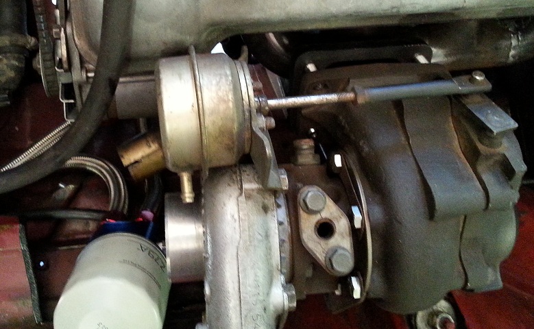

My plan is to use the internal wastegate - either with a solenoid in the inlet line to give some control over boost, or maybe replace the stock wastegate controller with a linear actuator solenoid directly controlling the wastegate from a flex output.

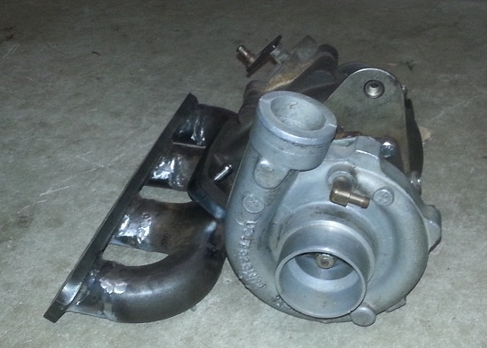

I'll probably have to position the turbo closer to the front of the manifold to clear the brake m/c. Yet another compromise, but plenty of OEM manifolds have the outlet offset to one end so it should be fine.
I don't think I'll have too much of a problem routing the dump pipe, it will only be 2.5" - mainly because that's the size stainless tubing I have on hand ;)

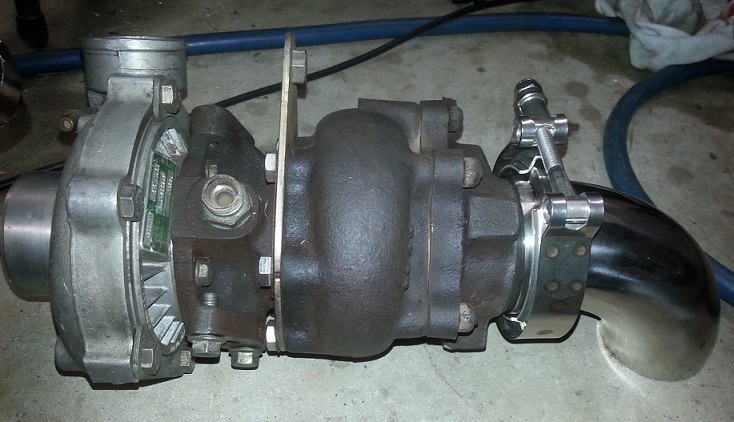

The rear housing of the turbo is a weird one, I couldn't buy the matching flange so I made one, but the housing has a tapered lip on the outlet that I'm guessing would be a complete PITA to get a decent seal, so I'm thinking I'll just remove the studs and weld a 2.5" v-band flange to the outlet.
After mocking up the layout, I'm a bit concerned about snapping exhaust studs from the weight of the turbo. Making it a proper top mount rather than hanging off the side of the manifold should reduce the leverage effect (if it clears the bonnet), but maybe I can add a support rod in somewhere to take some of the weight...
I've started collecting bits for the oil and coolant lines, still plenty of pieces missing from the puzzle though.

Looks great! New pipe dia is much better.
Plasma cutter made short work of what would normally be a PITA cut with a grinder and hole saw!
Re: festy's Alfa Romeo Alfetta GTV
yeah totally agree, plasma for the win!
looks good man!

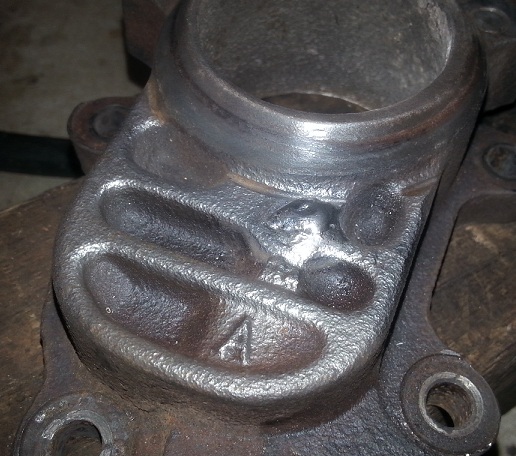

Doing a bit of work on the turbo setup, the 3 studs on the rear of the turbo were pretty messed up so decided to replace them. Actually, the original plan was to make a 3 bolt to 2.5" v band flange, but the stud spacing wasn't quite enough for 2.5" so decided instead to weld the v band directly onto the rear housing. Either way, the old studs had do come out.
I sprayed them with wd40 every second day for a fortnight before attacking them with a camming stud remover.
First one came out easy enough, but the other two stripped the threads in the holes and just spun, refusing to come out and resisting all sorts of violence and name calling.
Drilling them out wasn't an option because one of the holes is inside the housing underneath the wastegate so decided to cut them off and weld up the hole to seal it.
I'd spark tested the housing and it didn't look like cast iron but I wasn't totally sure so this would be a good test before attempting to weld the v band on.
Using ER70S-6 filler and absolutely no surface prep (it was still soaked in WD40) I was surprised how well it turned out:
I'll be using ER308L filler for attaching the V band to the housing, so feeling a little more confident in that now.

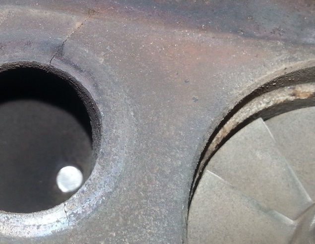

When I went to refit the rear housing, I found a couple of cracks around the wastegate port. Google tells me it's a pretty common issue with these, and not necessarily terminal...
With the studs gone I could test fit the v band clamp:
I then spent far longer than I'd planned clocking the turbo and fitting the wastegate actuator, then re-doing it all a couple more times to get it right. :rant:

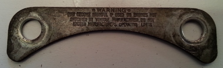

Not sure what to make of this though - maybe I better leave this part off, it sounds dangerous

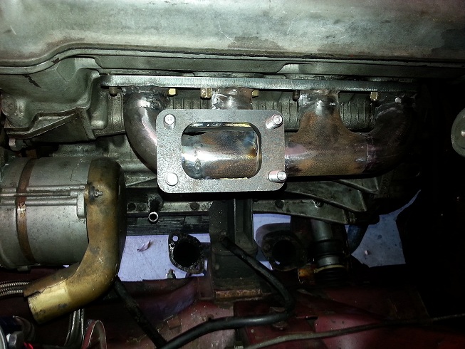

Next step - remove the exhaust and fit the new log manifold, work out the best position for the turbo flange and tack it on. This is the only time I miss my little mig welder :cry:
Then, test fit the turbo to make sure it... umm... ... fits....
:comp: :rant: :wall: :sad2: :rant: :rant: :rant:
Glad I only tacked it on :oops:
