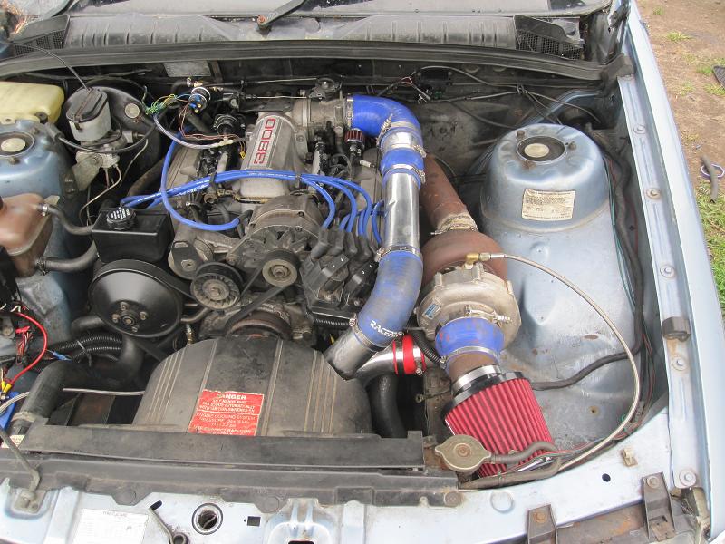

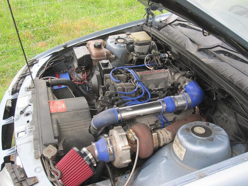

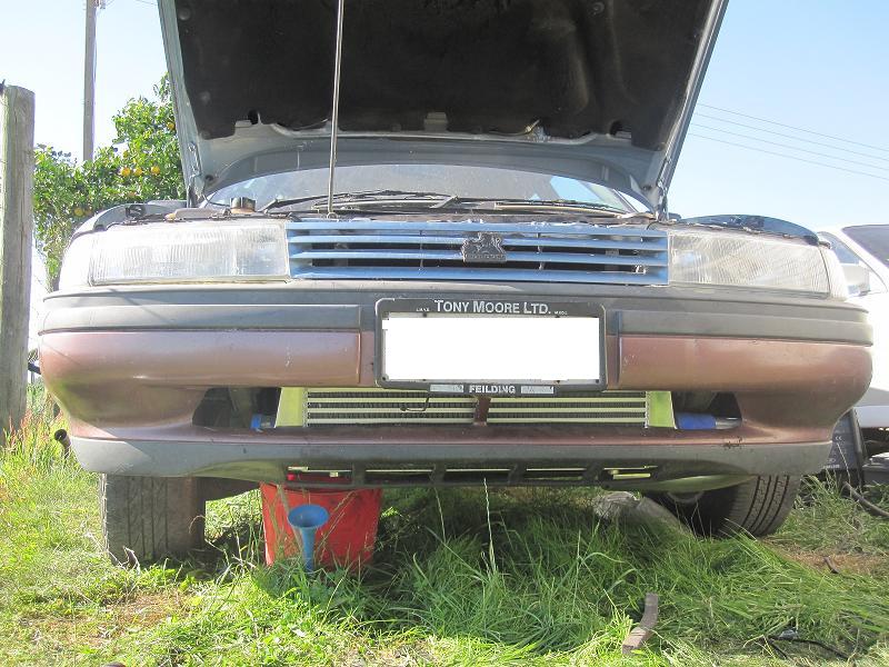

hehe ill be trying to get home with a stock auto in one peice so no huge hills for me will be trying to stay off boost as much as possible till i get my new valvebody and servo.got a little bit done today late in the day after i recovered from a nasty case of arc eye still sore now least the suns not up now think the cheap welding vizor that came with the cheap mig isnt a dark enough grade for a days welding LOL.now have the dump pipe in cooler all plumbed 2bar is in 2bar tune is in shes running great just injectors to go in then ill pull the old exhaust out from under it slap in the wideband and go for a bit of a blast with just the dump then im going to tempory fit a 2 1/2" exhaust to get me running and to get home just untill i can afford a 3" system.I CANT WAIT :driving: ultimate sleeper standard height grandpa spec weapon just what the doctor ordered :mrgreen:

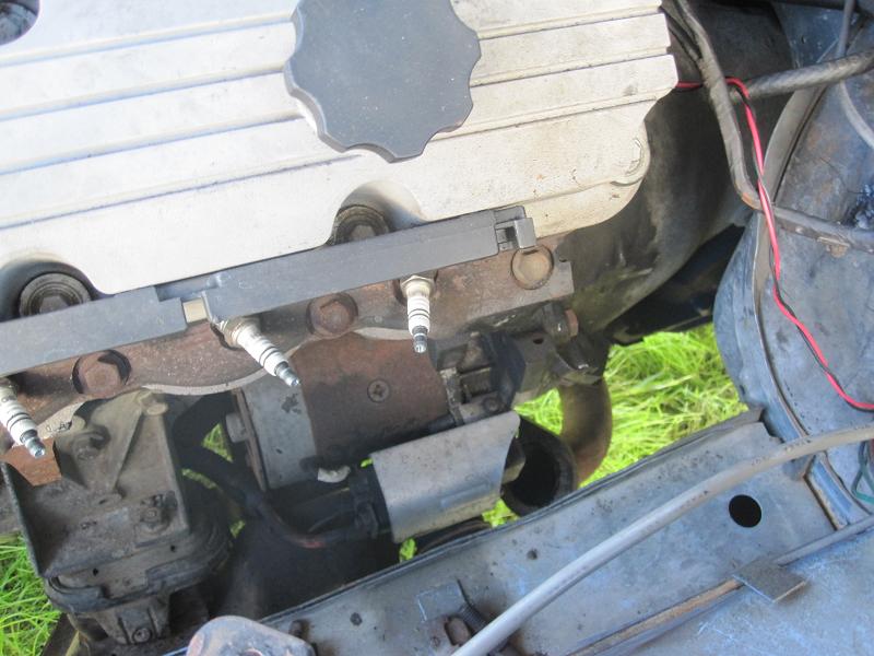

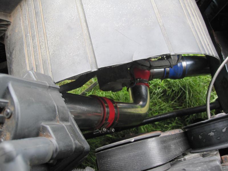

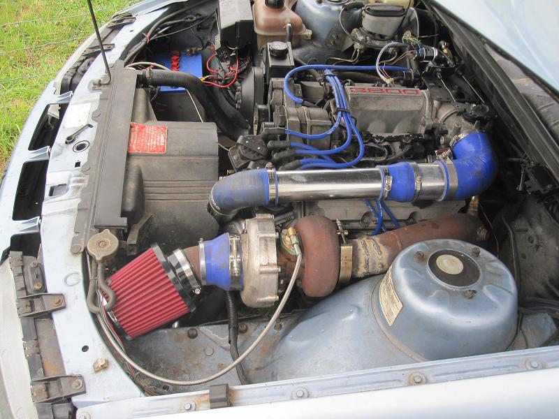

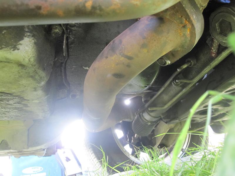

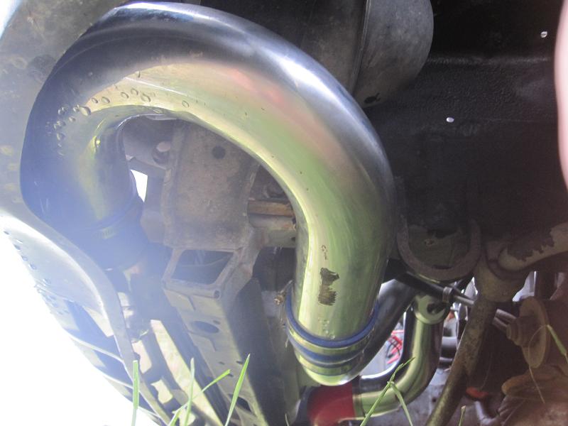

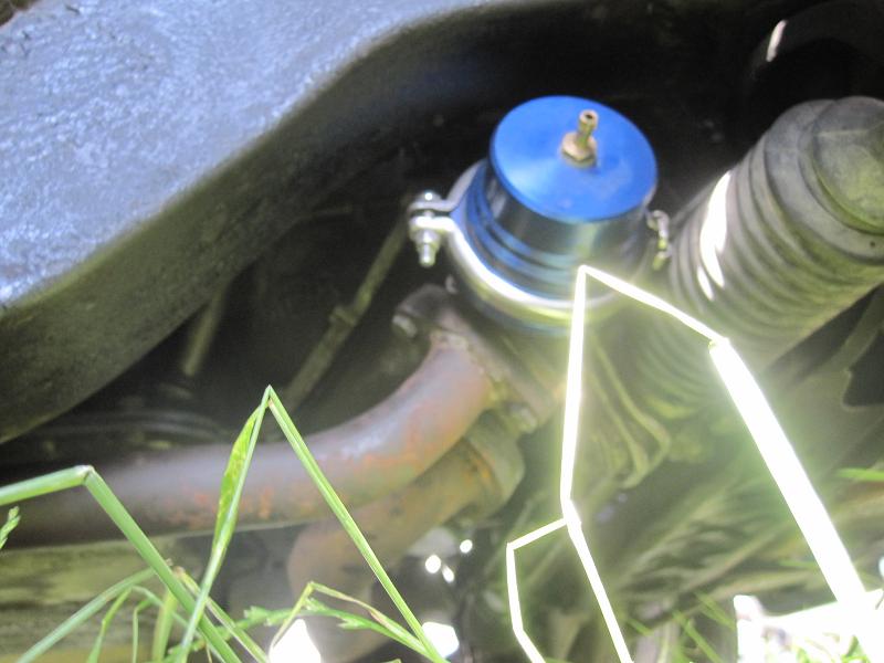

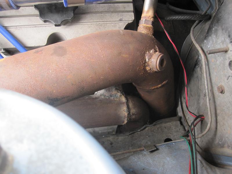

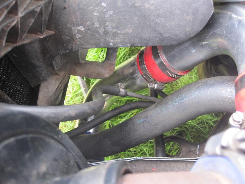

ide be happy at double or tripple stock output :mrgreen: will be a we bit before i really boost it need my new constant pressure valvebody and corvete servo in the auto first so it doesnt just die on day one LOL.few more pics of yesterdays effort not much done today been rebuilding 304 turbo engine only fitted my 39lbers today
