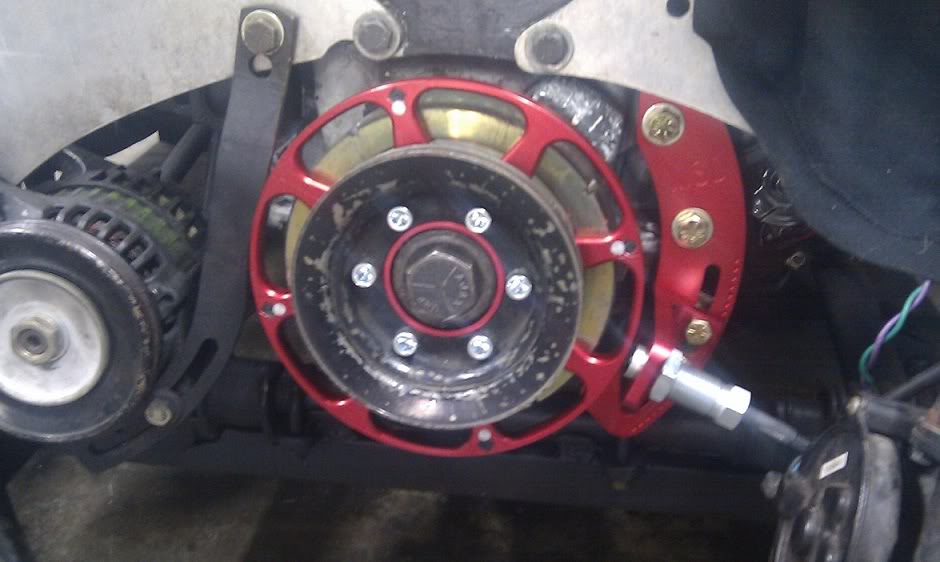

Installed a MSD flying magnet crank trigger instead of the home made one - balancer was an iron alloy, while it was ferrous just didnt have enough meat to be able to get big enough slots and a reliable signal. So now its a wheel with embedded magnets and a non-magentic sensor (opposite to a regular setup).
Only fired it up briefly as there was no radiator installed but testing looks promising. Scope showed perfectly clean signals everywhere and timing light confirmed it was stable, time will tell though when we hit the track next season. Engine will be removed for a freshen up along with a new intake and fuel rail setup before then
One interesting thing was it wouldnt start with the crank trigger. The ECU was detecting RPM (150RPM), injectors were firing (plugs were dry though) but it wouldnt start. TP showed a stable RPM trace the whole time. Went back to the dizzy reluctor pickup, left the fuel pump turned off and cranked it over - shitty looking RPM signal and all over the show. Turned the fuel pump on and it fired right up. Connected the crank trigger back up and it ran sweeeet
I think that with all the noise on the dizzy reluctor the injectors are firing heaps more often than normal and we are getting more fuel than expected - when going to the 42lb injectors have cranking PW tables that are less than 25% of the original factory tables.

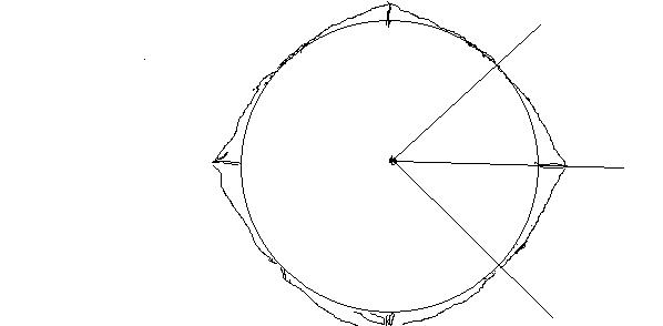

I was going to make a plate for my 5.0lt crank and mount a pickup with a camira module like you as well and came up with this design for a 50% duty cycle sine wave.
- reluctor v8.JPG (13.8 KiB) Viewed 5640 times

Re: The Val
Tried hooking the camira module on the pit bike up to an 808 this arvo,
and vl 400 was right .It revved to 6000 rpm no probs ,but with the camira module only it starts to miss around 2500 rpm.It controls the dwell very well considering the short pulse width from the ruluctor..
