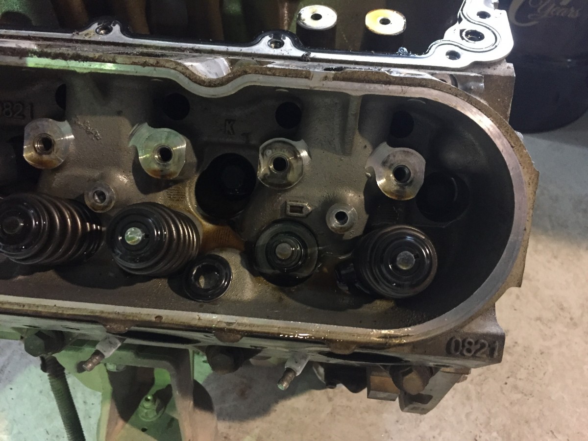

firebug wrote:I'm surprised the belt is still intact... :shock:
that was my first thought too!
Posts: 2612
VE L98 V8

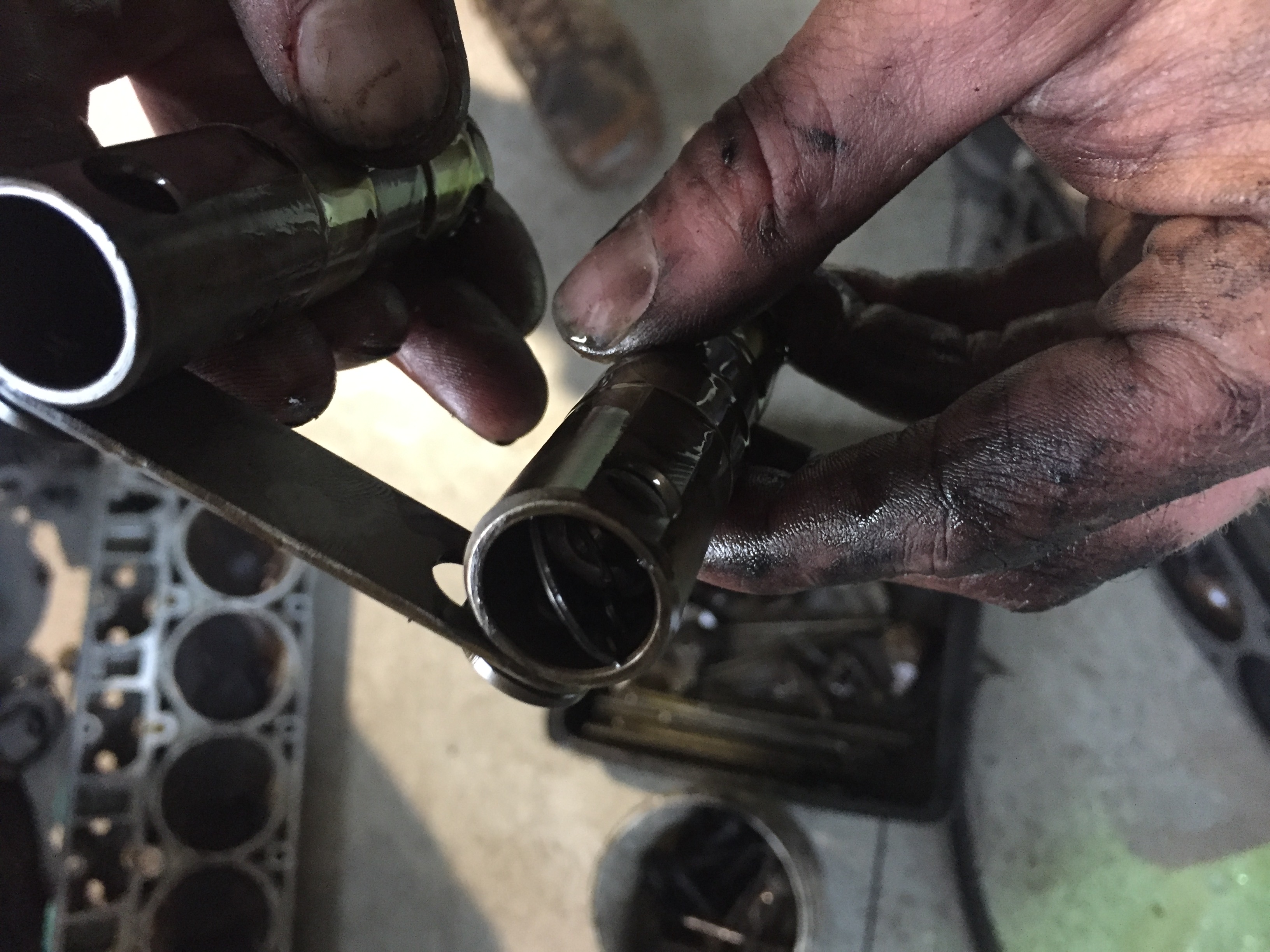

I wonder what came first, broken valve spring or collapsed lifter?....
The valve head was in the inlet manifold :lol:
probably spring and then that allowed the the whole train to pound itself to bits or more likely the piston smacked the valve after the spring broke and the shock up the train destroyed everything else in one fell swoop.

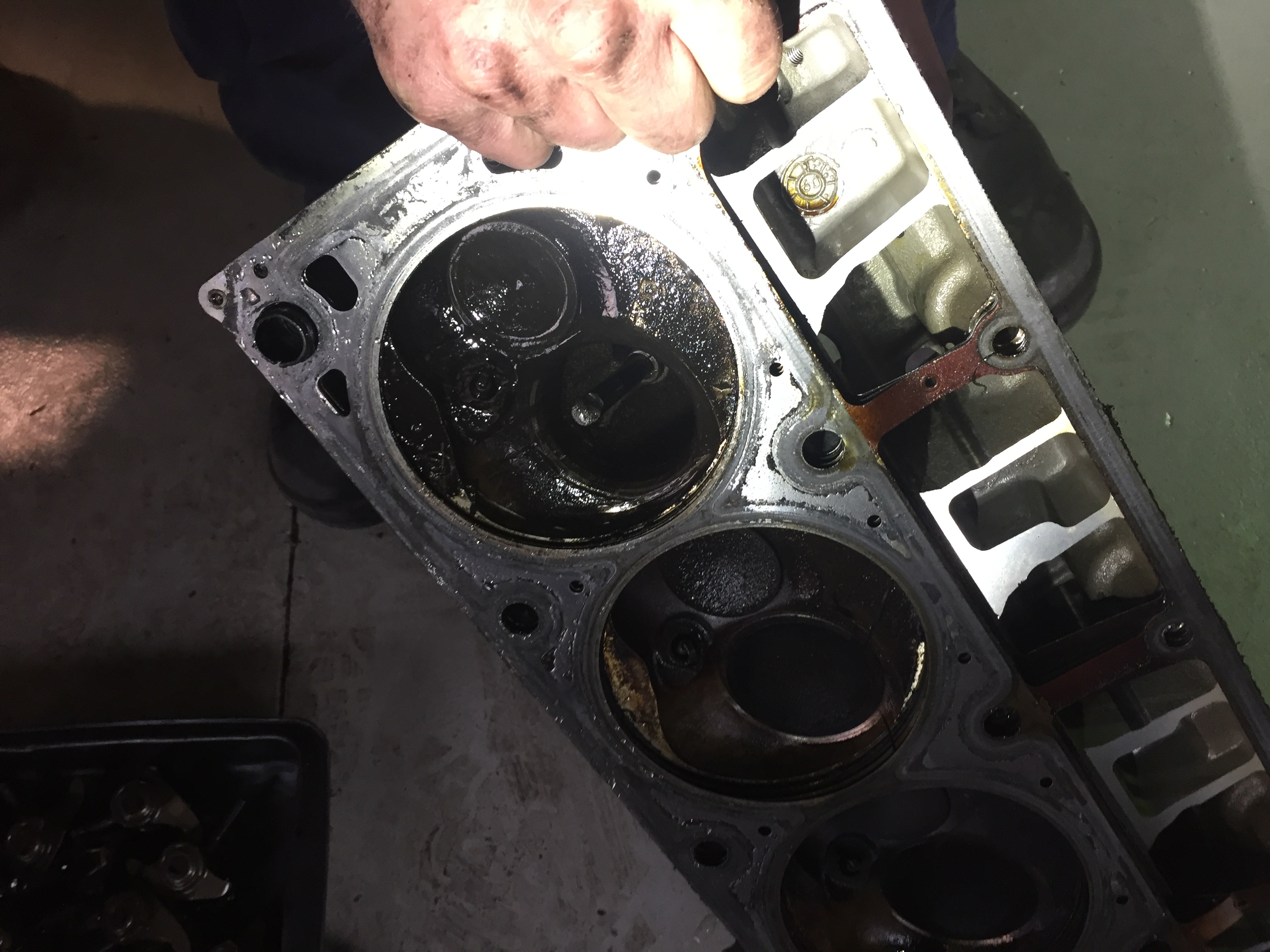

Seen same sort of thing happen in a V6, piston separated from the rod, smacked the valves and that smashed big chuck of metal off the lobes on the cam and bent the valves slightly. Lifters were ok as were the pushrods, cam wasn't though, it was so distinct you could calculate the crank angle when the piston left the party.

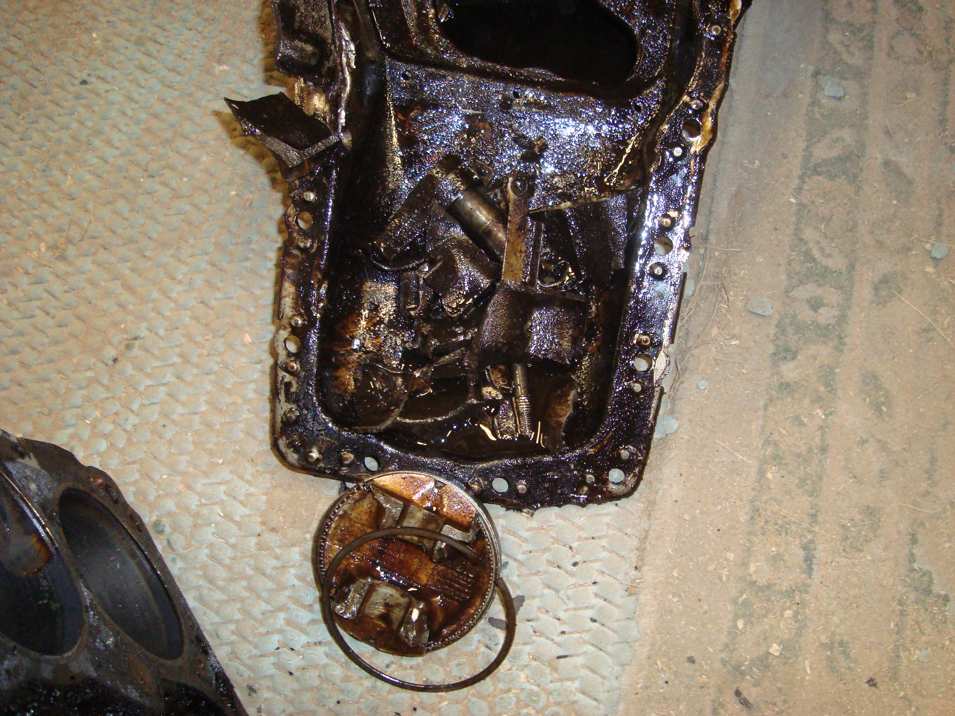

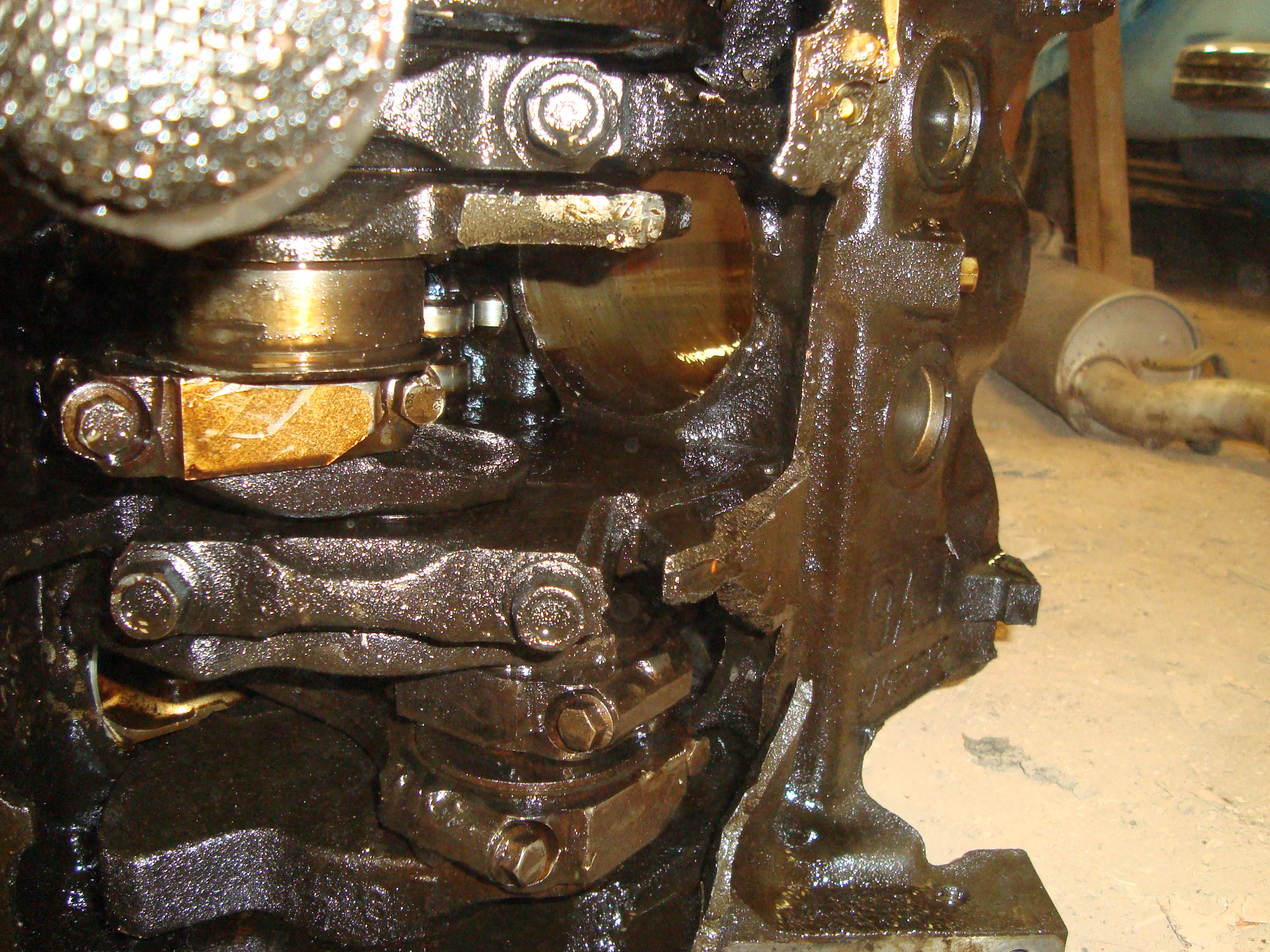

Hmm piston and valve relations always make a mess...
I still rememebr when I lent my VB SLE to my girl friend once day. She drove it very nicely (cable clutch manual M21 with 4.2) got a phoner call from RACV...
do you permit ms xxxx xxxxx to use your membership, yes why, car has broken down and is very noisey. Asked her to patch me through, had a three way conversation, her words were driving along here a big bang, lots of smoke out the back and knocking noise out the front, told RACV to send a tow truck and pick my car up, they stated that they needed to send roadside first....
Roadside got there aand asked she to start the car, she refused and stated that the motor had blown up, he argued with her (probably because she was a girl and what would she know, so he started it, and then promptedly turned it off, then requested the tow truck, long storey short, pulled the motor down to find that the piston in cylinder 7 had crack around the oil rings and turned sideways in the bore, next stroke threw the top of the piston threw the head, rod was ok and everything else was toast. big end bearing had been ovaled as well. Threw the lot out.

Yeah little bit like this one is seems. This is the one that punched the cam lobes. Can't see that in the pics though but you get an idea on the bang this one must of made. Still started first go and seem to drive ok apart from the knocking noise and horrific vibration.
