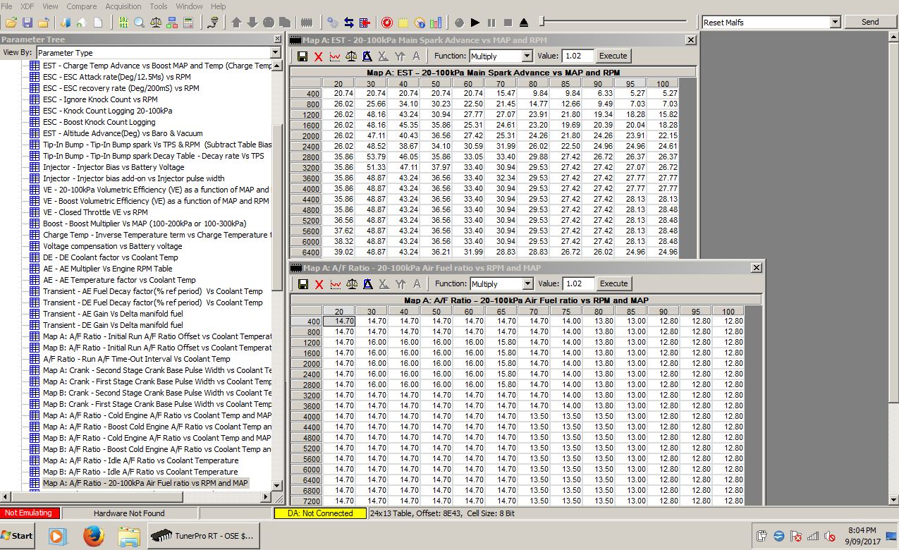

yeah the AFR table had values of 14-15:1 up to full load in low areas, also the timing was only 4º at full throttle under 1600 rpm or so, then jumped to about 9 in the next row. Then at high rpm full throttle the AFRs were at flat 12, so it would be pig rich, so poor performance everywhere compared to whats achievable.
In your new tune its done right and I have also filled in areas in the cruise parts of the map to be 16:1 all of the time then disabled lean cruise. So this basically forces a conservative lean cruise all of the time. Factory used 17:1 which is too lean and ends up loosing torque and actually then uses a little bit more fuel. 15.5-16 is where I found best.

I think I mistaken the row in the spark map as 12P has many more than the factory VN/VP ones. Anyway I put about 9º at the top right cell iirc
You can see the AFR table is pretty bad, the factory one is better, too lean up in the mid/mid-high and very high ends its too rich.
EDIT: couldn't find my tune in the custom tune section. I also have it in my build thread but hard to find with FB pics all missing. So I will post up a pic of the 2 tables later.

here we go.
