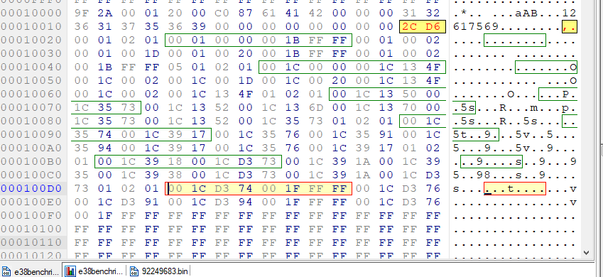

Post by Tazzi »
OS Calibration
Starts at 10000
Ends at 1BFFFF
CVN at 1001E
System Calibration
Starts at 1C0000
Ends at 1C134F
CVN at 1C001E
Fuel Calibration
Starts at 1C1350
Ends at 1C3573
CVN at 1C136E
Speed Calibration
Starts at 1C3574
Ends at 1C3917
CVN at 1C3592
Engine Diagnostic Calibration
Starts at 1C3918
Ends at 1CD373
CVN at 1C3936
Engine Calibration
Starts at 1CD374
Ends at 1FFFFF
CVN at 1CD392
Also note that 6 CRCs actually get noted at location E32E to E339. Infact... they actually appear multiple times in that top FFFF section
*edit
now looking at the top section, can see them labelled. Im pretty sure the values between the segments indicates address for caclulating CRC for each segment
Yeah ok, so it does seg total address then does top part of seg then it skips the CRC 2bytes, and does the remainder of the seg. And finally address is segment minus header to end of segment.
*edit 2
Now I think from memory it only calculates the CRC based on data after the CRC, wrote a app for this but ill be on the old laptop. But atleast its safe to know that all calibrations occur from 0x1C 0000.

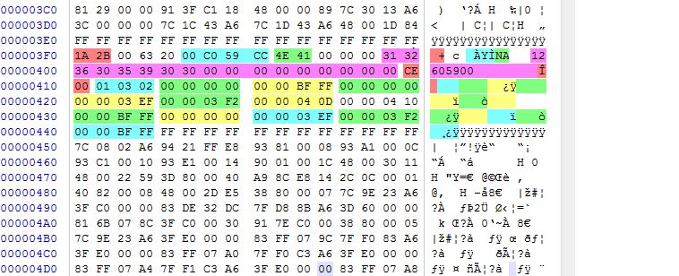

see also
address 0х3f0
it's a boot
its title will show you
how its parts are located in memory
the principle is the same

kostia111 wrote:see also
address 0х3f0
it's a boot
Ok I see that. 12605900, must be the ID for the boot.
I dont see the address in that area of anything else of interest, but its good to know regardless.

see
the header is not always at the beginning of the file
he can describe the memory above and below himself
kostia111
Posts: 57
Joined: Sun Oct 20, 2019 6:58 pm
Re: GM E38 Kernel/Bootloader Deveopment Extravaganza
Post by kostia111 »
I showed the markup a little incorrectly
but I think the meaning is clear
file consists of 2 parts
in the header can be indicated not only the address of the beginning and end
but also the starting address and length
I translate through google
and the translation is not quite right
sorry
0x0000---0x03ef
0x03f0--0xbfff

kostia111 wrote:I showed the markup a little incorrectly
sorry
Thats OK, Im understanding what your saying (mostly)
I see how you have marked it up which makes sense. But what Im saying is there is nothing that is really needed from that section, since we will not be touching that boot segment.
