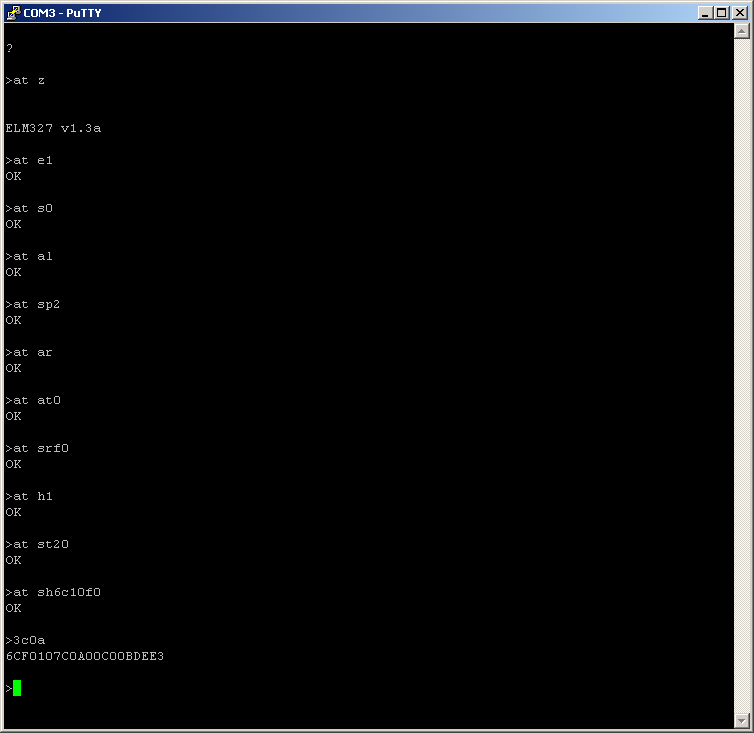

Are you familiar with sending AT commands to the tool from a Terminal Program (Like PuTTY)??
If you are, send the following one at a time.
The 8 x's are the OsID in hex ...
I would be interested in seeing the results.
[edit]
Example of the above Terminal steps with OsID: 12585950 6CF0107C0A 00C00BDE E3
00C00BDE hex = 12585950 decimal.

I'm a bit perplexed, this is basically the same tool I use, the chip version is a bit different, the OBDLink LX uses a STN1155, I'm using a STN1110.[11:00:52:811] TX: STPX H:6C10F0, R:1, D:3C0A
The last line should return the OsID ... looking something like: 6CF0107C0Axxxxxxxx??AT Z
AT E1
AT S0
AT AL
AT SP2
AT AR
AT AT0
AT SRF0
AT H1
AT ST20
AT SH6C10F0
3C0A
[edit]

I'm perfectly willing to do this, provided I can figure out how. My familiarity with terminal programs is kinda seldom and minimal.
I downloaded PuTTY but don't know how to set it up.
I downloaded cmdr and same problem. I know not much is required, it just takes the right steps. I use a terminal program any time I use the milling machine in my shop but that is just as an operator.
I installed and ran these commands on my old laptop back when I was trying to get my new AllPro cable to work. Don't remember which terminal program I ended up using. Never did get the AllPro to make the connection even with the new laptop, though Scott Costanza tried it and said it was fine. Just a little background here. The OBDLink LX worked so I've been using that but I took some time off tuning to construct a desktop simulator and get a laptop O'scope working. Replaced a couple of sensors and the engine fires off now so I wanted to enrichen the cold start compensation. But now I've lost communication with the ECM.
So, since I can't remember how I set up Terminal is there a chance you could help out on that?

PuTTY is light.
PuTTY is simple.
PuTTY is non-intrusive.
That is why I recommend it.
The first time is the hardest, that is setting it up ... though super simple!
First you need to know what COM port number the Tool is using ... In device manager it's under Ports.
Open PuTTY
Don't worry about anything on the left ... Just the following on the right!

Mr. Jim, Are you doing this in Vehicle??
Or on a bench harness following this Schematic??
PuTTY is simple.
Open PuTTY
Connection Type: Serial
Serial Line: COM? <- Adjust this to the COM port of your Tool.
Speed: 115200
Saved Sessions: Type a name to save the above configuration under if you want to save it, then Select: Save
That's it!
Select Open ... You're in.

Re: PCM Hammer Release 012
ATI
ATI
>ATZ
ATZ
ELM327 v1.3a
>AT Z
AT Z
ELM327 v1.3a
>AT E1
AT E1
OK
>AT SO
AT SO
>AT S0
AT S0
OK
>AT AL
AT AL
OK
>AT SP2
AT SP2
OK
>AT ART
AT ART
>AT ART
AT ART
>AT ART
AT ART
>AT ART
AT ART
>AT AR
AT AR
OK
>AT AT0
AT AT0
OK
>AT SRF0
AT SRF0
OK
>AT H1
AT H1
OK
>AT ST20
AT ST20
OK
>AT SH6C10F0
AT SH6C10F0
OK
>3C0A
3C0A
NO DATA

Ok, Now we know it's not PcmHammer, or PC <-> Tool communication.
That pretty much leaves it to a wiring issue or a Pcm issue.
Is this in Vehicle??
I know you're doing something with a MGB, hopefully LS swapping it ...

OK, that's all good news, and I have more of the same. Really something I should have done to start with, live and learn. The problem is with the simulator only and is almost definitely a case of switched wires.
I went out and gave the connection to the car another shot. Good news is, I did a config rewrite with the OBDLink LS and it was successful. Then I grabbed the AllPro cable which I've never been able to get work and got a good connection and a successful test write. The end message said it was a great connection.
So, a better outcome than I hoped for. I'll have to find the problem with the simulator wiring but that should be really simple now that I know where to look.
Thanks for all the help,
Jim

Quick update. Two reasons why I did not have comm with the simulator, both related to replacing theOBD-II connector with one from a donor vehicle. First, when wiring this plug the purple wire goes to the green wire. Not exactly intuitive and I had it green to green. Secondly there may have been some corrosion on the contacts as it still didn't work. Nothing I could see but after continuity checks turned nothing up I repeatedly plugged and unplugged both the Allpro cable and the OBDLink into the connector and was then able to write to the ECU with either device.
Jim
