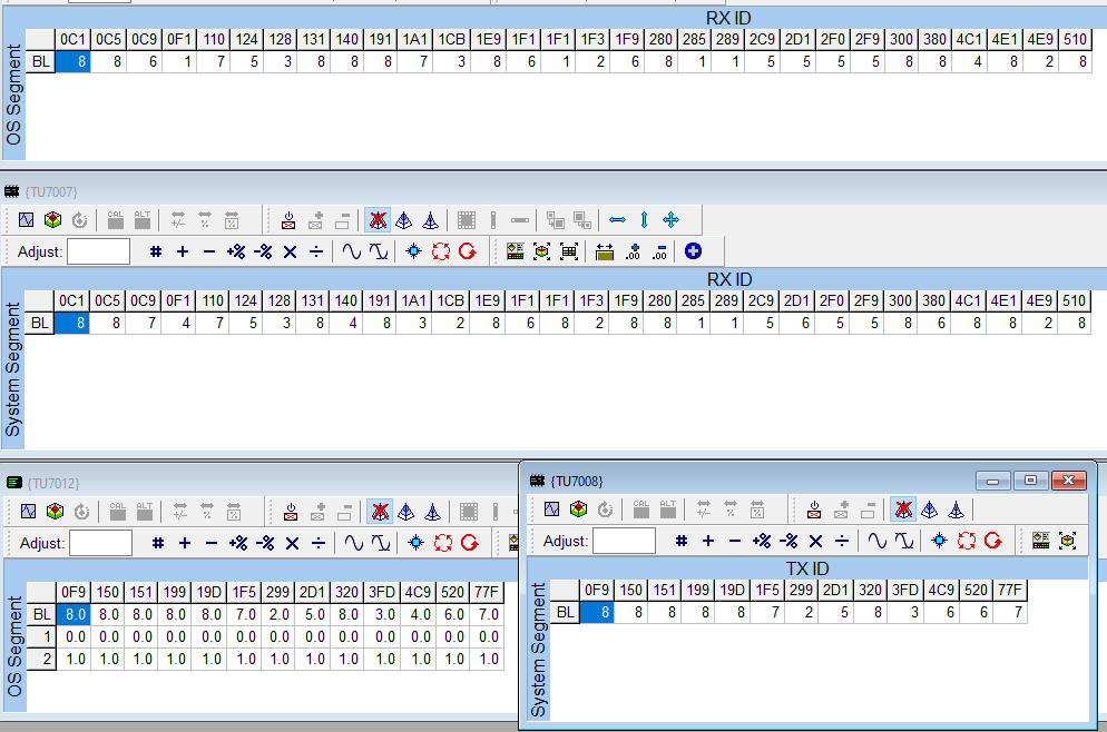

- Tre-Cool
- Posts: 414
- Location: Perth
Re: E67 to T87/T87A TCM interface needed
Comparison between whats in the OS Segment vs System Segment for a TCM
I have a couple of extra cells in the OS TX area because it has a 1 value 2 values after the bit length. I'm guessing a 1 value = Transmit, since the RX area is all 0's.
Obviously OS portion does not change between holden,gmc,corvette platform etc otherwise it would get a different OS number, so the system segment's are changed by the team doing the factory calibration?, but it does beg the question what's the point of having the system area if the OS portion has a lower number & or does it not matter...I have a couple of extra cells in the OS TX area because it has a 1 value 2 values after the bit length. I'm guessing a 1 value = Transmit, since the RX area is all 0's.

Could it be the difference between a bump in the CAN database version vs what the OS actually cares about?
Like the CAN handler needs to know a 7 byte message is valid for error checking purposes, but the OS only reads 6 bytes to look for data that's relevant to it.
