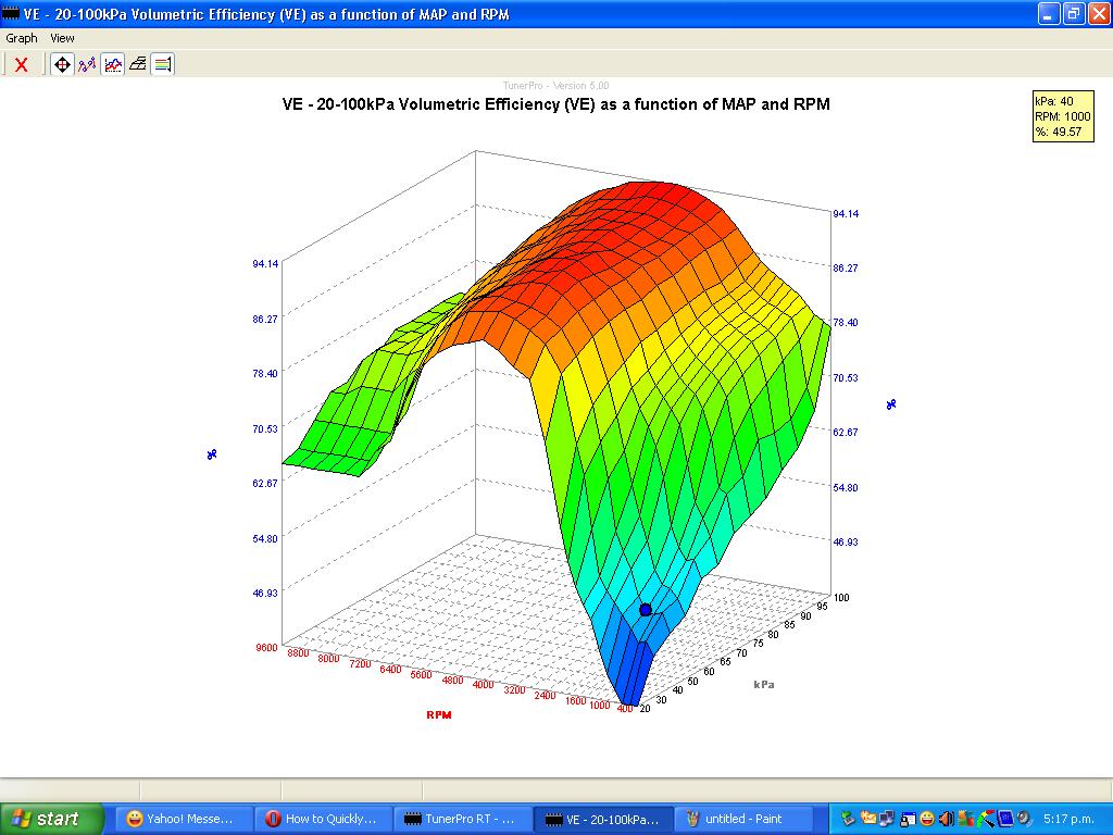

So i was have been making my way through dropping the grams/sec value down to about .08 now and in the 0-100 map for ve im up to around 75 or so. So getting there slowly.

So down to .073 grams now and have the ve in the 80s
Have the of boost ve map driving good and decent afrs
On boost area needs more work thats another story lol.

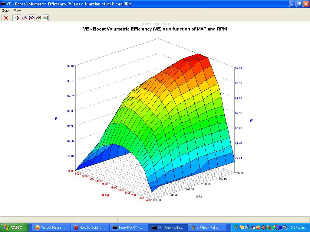

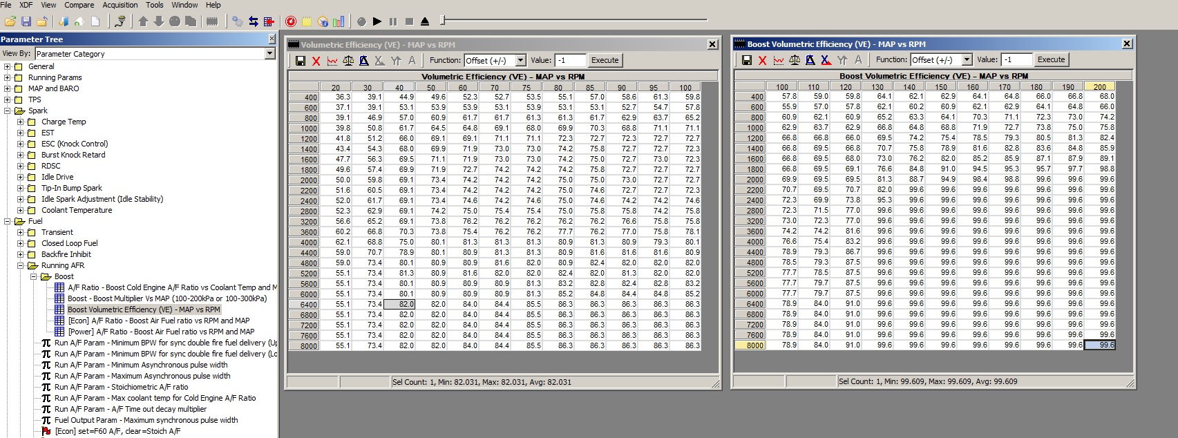

Tho this happened to me today (has happened 3 times now
) after working on ve map for boost not sure what i done clicked but all the right hand side of the ve map as seen below just goes to 99.9
and i lose all the ve data / numbers that i have entered
I am using a moates ostrich and as soon as it happend i download the bin from emulator to tuner pro (to see if i can get my proper ve table back) open up boost ve map again and its all 99.9 in the right hand corner of the ve map
Anyone seen this before ?
