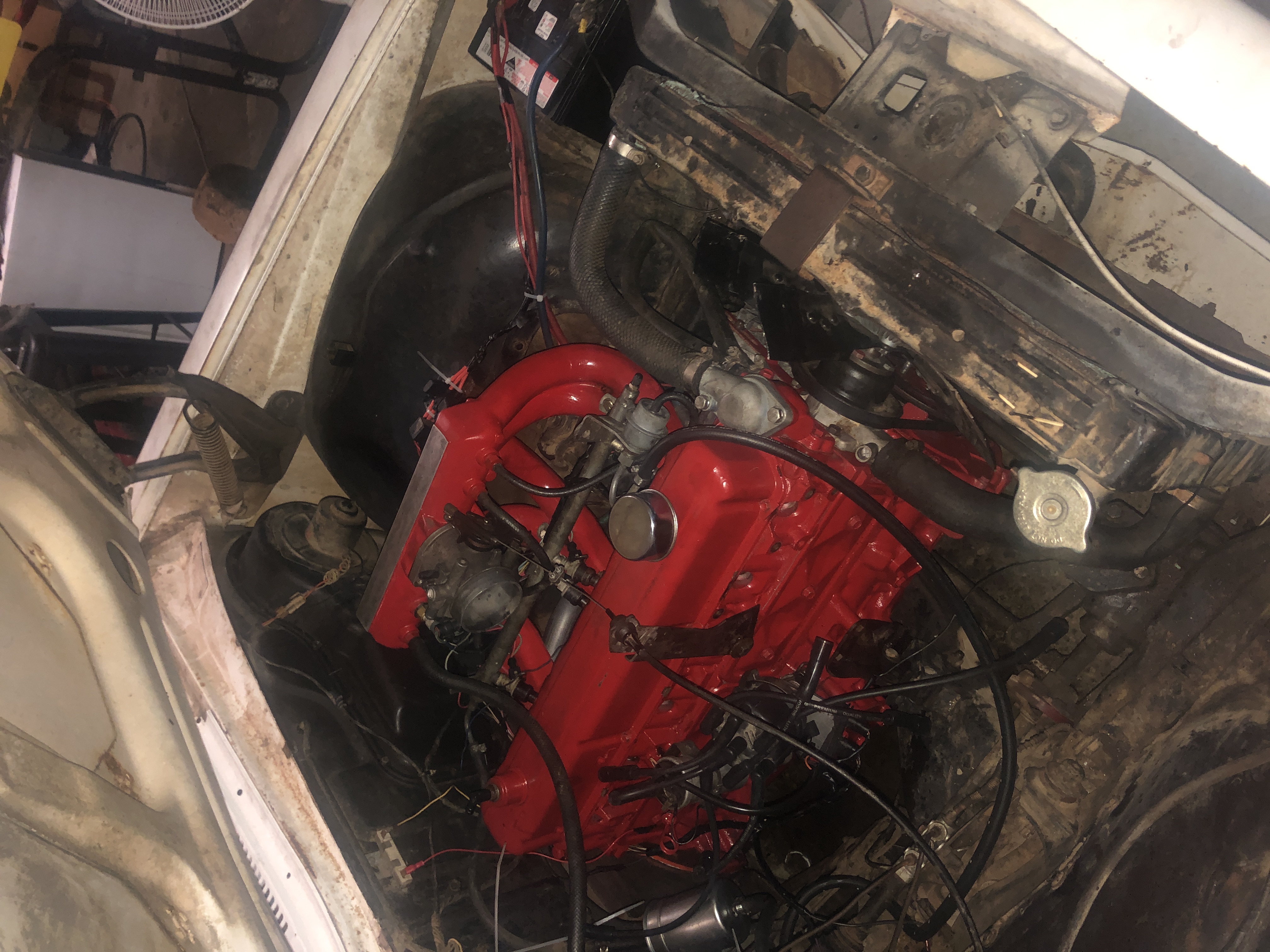

Thank you. But that’s the last of my struggles though. I’ve been trying to get it going on the starter motor for a while now but it sometimes stutters then just keeps on cranking till it floods. I had to push it down a hill and gently clutch start it into third. I have the battery on a charger right now and I will leave it for a couple days to fully charge. Then I’ll try to start it off of the starter motor. If anyone has had the same issue, I’d love some advice.
I’ll post up a YouTube video of it cranking when the battery is done if it doesn’t get going so you guys can see what I mean!

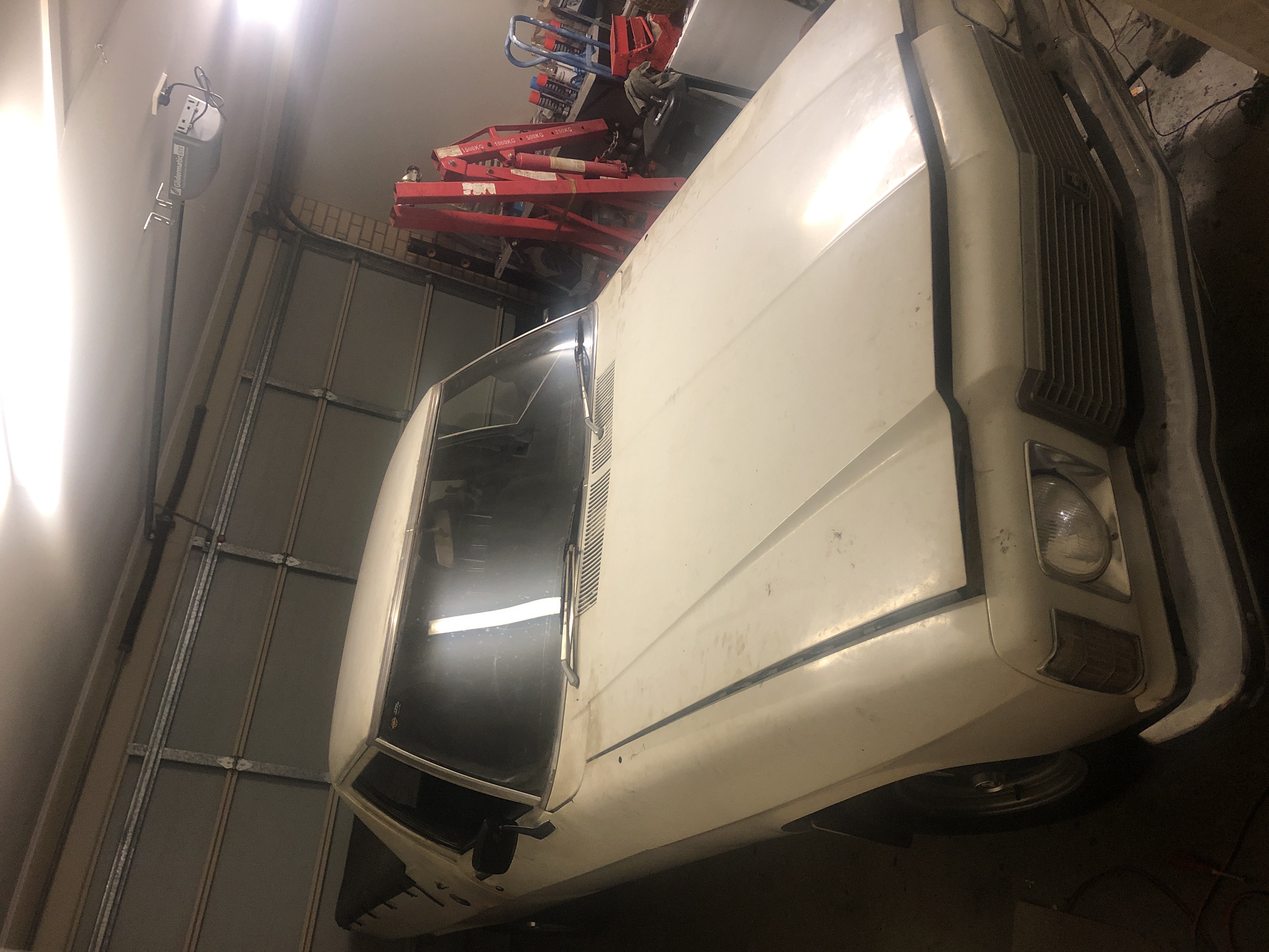

Here’s some photos of my old girl. My first car, got her last year for a steal. Wasn’t running so I thought it would be a good idea to throw myself into the deep end and get it going! Once I got the old 173 running (the stromberg carb wasn’t too hard to figure out) I found that it didn’t have enough bite for me. Hence why I’ve done this hotted up 202 for a school project!
