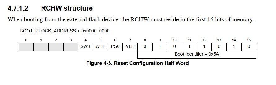

I decided to go looking for the watchdog service routine. I couldn't find it either. But I did find this in the reference manual:
Watchdog Service Code.This field is used to service the watchdog and to clear the soft lock bit
(SWT_MCR[SLK]). If the SWT_MCR[KEY] bit is set, two pseudorandom key values are written to service
the watchdog, see section Section 17.4, “Functional Description”, for details. Otherwise, the sequence
0xA602 followed by 0xB480 is written to the WSC field. To clear the soft lock bit (SWT_MCR[SLK]), the value
0xC520 followed by 0xD928 is written to the WSC field.
So maybe this thing is using the pseudorandom key to feed the watchdog, and that's why the static sequences don't seem to show up in the disassembly.
For whatever it's worth, the MPC5644A in the chassis control module I disassembled has the SWT in the same location. I can't find the service routine in that code either.
Gatecrasher
Posts: 353
Re: E92 PCM Reverse Engineering
Post by Gatecrasher »
If I'm reading this right, both the core watchdog (WTE) and the software watchdog (SWT) are disabled entirely. The first two bytes in the ECM code are 00 5A. Maybe watchdog functionality is left entirely to the slave CPU?
The chassis module is set up the same way. It doesn't have a secondary CPU, but I haven't looked to see if it has some kind of hardware watchdog chip.
Posts: 3558
cars: VE SS Ute
Location: WA
Post by Tazzi »
Weird, Iv never seen an OS intentionally disable the watchdog timers!
