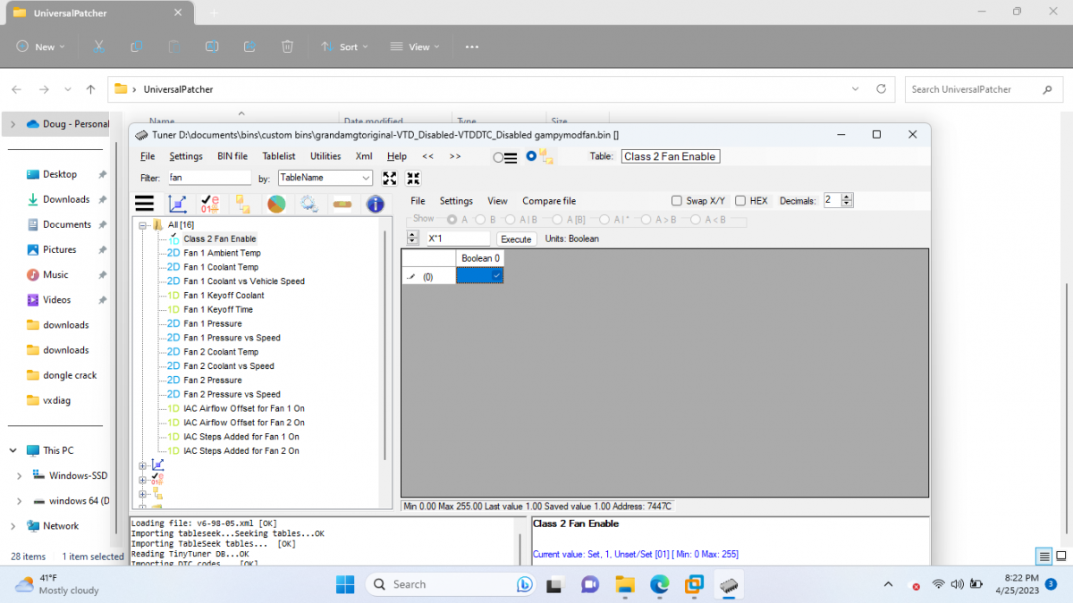

Its checked off in tiny tuner, i thought that was supposed to be checked but i'll uncheck it and then try. i will goto your address and see what i can do. I'm not understanding why the enable will affect everything.
In tinytuner program it is set as 1 in Universal patcher it is checked. In boolean terms 1=on 0=off
In the bin you have that means class2 fan enable is ON, and pcm controls fans by messages on class2 bus.
This Class 2 fan enable does what exactly? I found on hptuners this guy saying the following:"Enable", if I remember correctly, allows for the Climate Control in the car to control the fans. "Disabled" means the PCM controls the fans.
So keep it stock, keeping it as it is won't fix why my fans isnt coming on at 199.976, but 223f https://forum.hptuners.com/showthread.p ... le-Disable this is all i could find.

You have fan_serial_control enabled =Defines if the fans are controlled via Class 2 serial data.
You want to go deeper and explore the logic behind, Make a disassembly of the bin you have with ghidra and trace the function that is skipped by the serial setting. That is the only viable way to find out how exactly fans are controlled by pcm.

"Class 2" means the VPW data connection. It means it'll command another module, probably the BCM, to turn the fan on. See https://en.wikipedia.org/wiki/On-board_diagnostics "SAE standards documents on OBD-II": Item: J1850 – Defines a serial data protocol. There are 2 variants: 10.4 kbit/s (single wire, VPW) and 41.6 kbit/s (2 wire, PWM). Mainly used by US manufacturers, also known as PCI (Chrysler, 10.4K), Class 2 (GM, 10.4K), and SCP (Ford, 41.6K)

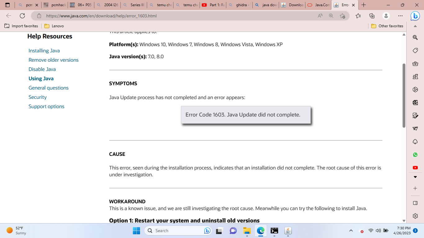

For the dude wanting me to get ghidra and figure it out....I can't even install the damn program. Java won't install and i tried their work around with no avail. Java doesn't even know the root cause and their working on a fix. I was excited to try and figure things out too.
