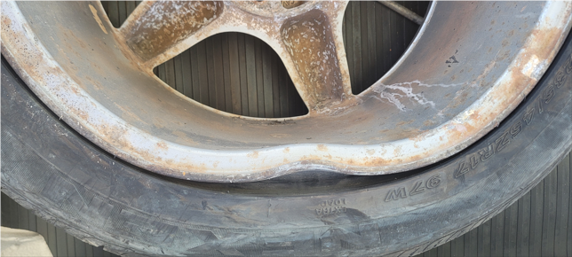

This way on the way home only a few kms out of town. Veered off the bitumen and there was a huge shoulder with a pothole on the edge. Hit that at 90 km/hr. Inside edge of the rim is badly dinted.

Just had a better look in the light of day. Back wheel is damaged as well. Put some air in it and instantly started leaking.
One thing I hopefully have drummed into her is that not to use the cruise control in the rain or on the dirt. Being a ute that is light in the rear end, its all too easy to loose control.

The back wheel is a bit better, and while the tyre looks ok it doesn’t hold air.

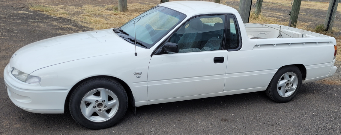

I was in a world of hurt trying to source another set of rims. When you’re not looking for them they seem to be everywhere. When you need them, there seems to be nothing out there so just parked the ute up. The date for the driving test is fast approaching and this ute is the only manual we own. Thankfully a cousin of mine answered the distress call and she has sourced a set of VR SS wheels for us. So yes these are a 15” wheel, but given the lesson we have just learnt with low profile tyres and the roads out here it’s a better choice for a learner driver than the 17” Senator wheels were. Tyres are reasonable but only 205s. No centre caps, and they seem hard to procure.

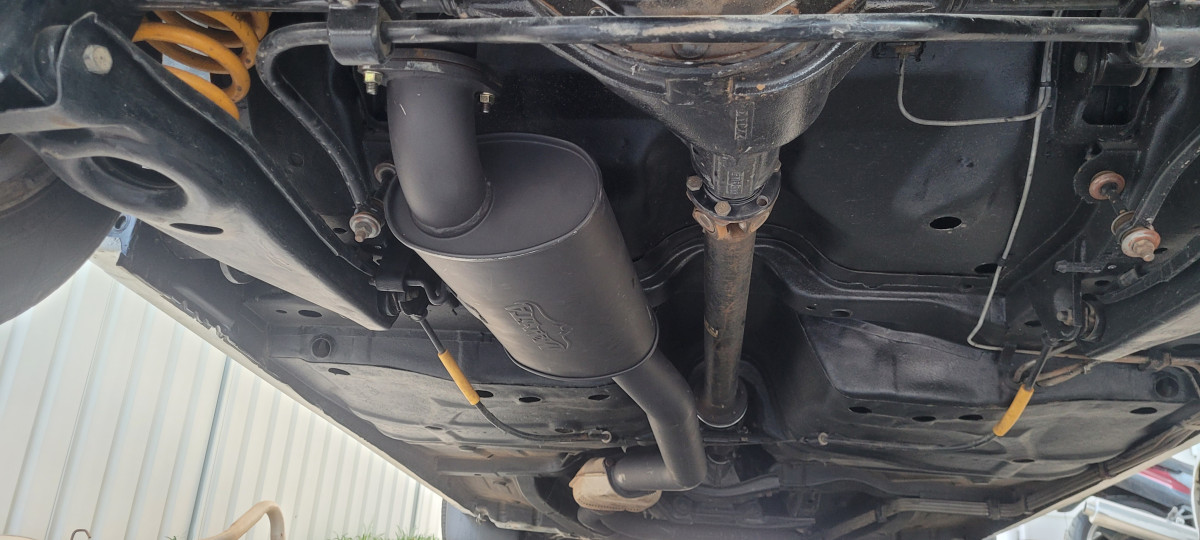

Been lamenting the exhaust situation, and nothing was going to happen anytime soon. Then my nephews managed to grab a 2nd hand 3” Manta catback for us. As much as I don’t like the Manta mufflers, their systems are really well built and they fit really well. Once I had the ute on the stands it was 20 minutes max to throw the exhaust on. Still has the original old cat, but that’s a job for another day. It’s not a twin cat system like I wanted, so still running the Y piece, but for the price of it couldn’t pass it up. No twin system either so the drivers side exhaust hanger will be an ornament for the time being.
Clearly with a single muffler its now way too loud, but seat of the pants is that it’s picked up a bit of power. Has a slight bit of a drone but the exhaust note sounds a lot better than the previous system. I also think it’s almost a given most driving instructors would fail a learner instantly if they rocked up to a test with an exhaust this loud. So will look at getting a 3 inch chambered resonator for the tailpipe in the hope that it will knock the edge of it.

Looks like it its decent fit. All other exhausts I've used all need mods to make them fit better or not fall of with the crappy mounts and what not.
Mufflers are one of those things that I wish there was a way to know what they sound like before fitting. Many sound terrible and all in different ways so you can't put a sound down to a common design, it's all in the subtle details.
And for these cars being so tight for space for mufflers, it's hard to even find configurations that would fit. I have kept an eye out for the front and rear shape and size in a 3.5". Found a few in the US that would fit the rear, none in that offset oval for the front like in your pic.
May have to just have them hand fabricated, but a thing for another day, just nice to know options well ahead of time.

The resonator on my cars at least got rid of that loud and annoying bark that happens at a certain rpm, similar sound to the old thong slapper.
The exhaust guy I used years ago to do my restro mod VP said if you want a single muffler and don't want the bark, to move the muffler as close to the tail pipe as possible. The tail pipe being long after a muffler is what seems to cause that bark. Hard to do in a sedan or wagon, but on the ute I think there is more room?
I started with dual 2.25 with a muffler each in the stock location, barked really bad despite sounding nice at idle and else where, he then merged it before the diff with the dual mufflers left alone (was for diff clearance, dual 2.25 didn't fit) and then a medium sized resonator at the fuel tank, sounded great still and the bark went away completely.
That all said, seems this ute doesn't suffer from that bark at all, sounds really good!
