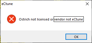

I want to try with e_Ctune.. it wont connect because the vendor ID. I test with c_rome std and gold with standard mode, it can connect and emulating. The datalogging also work.
Vendor Id not the usb one, but in ostrich vendor id.
I used ostrich utility to look into one rom HW info.. as can see vendor id is 0x00 for selected software. e_Ctune software need vendor id set up to 0x01 and serial #.
These I load with e_Ctune .bin

i'll see what i can do.
That's the v0.1.5 flashtool, very experimental.
Does it error the same using the v0.1.4-beta from the first post of this thread?
0.1.4 was stable before I started hacking into it to get the 128K 27C010 working.
0.1.5 ended up messing with the 27C256/27C512 firmwares, it shuld still be fine and i don't think it changed anything drastic.
It may or may not have changed other things that were unintended.
I know the ostrich tool won't work, it's only a compatible communication protocol for software, not actually trying to fully emulate a moates ostrich at the hardware level.
**edit**
Well that's a rabbit hole just trying to get that software to run let alone see what it's trying to communicate to the onerom......
Basically if i can't get the software running, I can't use the debug firmware version and see what it's trying to do in order to even attmpt a fix.
Sorry but i'm not spending hours trawling thru decades old threads just to get the old software working.
If the software is simple to install and get running then I could theorectically patch any comms requests and make it answer what ever is needed.

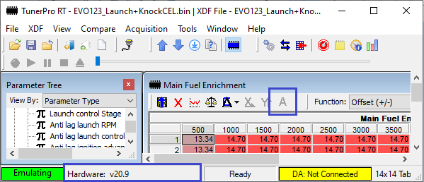

And just asking, why tunerpro rt not work for address tracking, it is because tunerpro rt not detecting hardware as ostrich, or there another reason?

themr.m wrote: Fri Jul 10, 2026 4:54 pm And just asking, why tunerpro rt not work for address tracking, it is because tunerpro rt not detecting hardware as ostrich, or there another reason?
What do you mean by address tracking?
Posts: 10014
Re: OneROM
what tunerpro calls data tracing? I've also heard it called bubble tracing. Usually that's in tunerpro, but the XDF and the ADX together need to be set up for it (and each other), and you need to turn it on here.

jxx wrote: Fri Jul 10, 2026 8:27 pm What do you mean by address tracking?
https://youtube.com/shorts/7licyJOf-VM? ... sUcofvIijn
Address tracking it like datalogging, but no additional hardware like ALDL. But it work with Ostrich or CobraRTP Motronic r6 hardware only. The function button will gray out if not compatible emulator used.

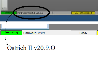

Above I try with Onerom, 27c256 , std mode and disable serial port 2. All working fine, can write and read back from onerom. Either tunerpro rt not recognize Onerom hardware or maybe it another thing not meet Tunerpro rt requirement.
Compare Ostrich and Onerom added firmware, the hardware detect difference name in Tunerpro rt. If firmware can be edit to make Tunerpro rt detect Onerom as "Ostrich II v20.9" maybe it can enable the address tracking button. But it just my theory only.
