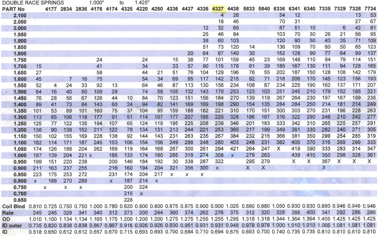

delcowizzid wrote:any idea on the seat pressure of them.
mine where about 120-130 from memory.
vlad01 wrote:yeah thats them. I have nos ones too but ecotec ones, they aren't the same. So these buick ones?
these I bought for a VR motor but never used them. they were sourced from holden but that was about 7-8 years ago!
no idea, crow are useless for listing info.

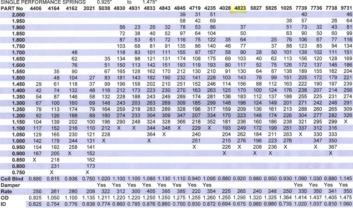

not quite, I have a sheet i'll see if I can find it, shows all the spring part numbers and installed heights and bind heights and pressures!
found em in paper form and scanned :)
I thought I had the 4823, but just looked at the box and I went with the 4327's in the end because the 4823's wern't going to work properly for my lift, most installed heights were about 1.520-1.540 and we just shimmed the springs to get them all even. and I my lift was .507in / .533ex
Single Performance Springs.jpg (306.02 KiB) Viewed 5165 times
Double Race Springs.jpg (378.47 KiB) Viewed 5165 times
Posts: 5633
yeah 202 and v6 install height is way different hence the different spring.

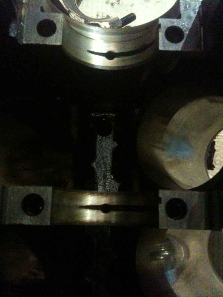

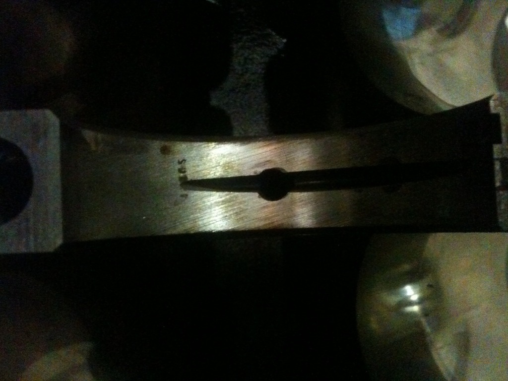

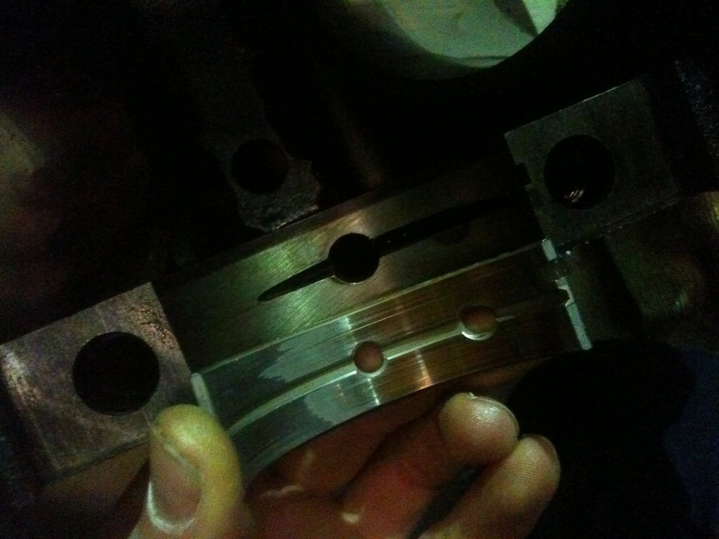

removed the old crank from the block today, looks like No1 main is out of alignment has copper worn though on passenger side of both shells, all other main bearing have worn more or less even with no copper showing.
will need a tunnel hone me thinks :think:
Also looks like the old crank has run out on the No1 main as well, that would cause the wear pattern but would exacerbate the wear in general.
The old crank is more sad than I though when i got all the caps off today. all have fine scores and bearings have small bits embedded in them.
But I have a good one and all should come up great once the machine work gets done.

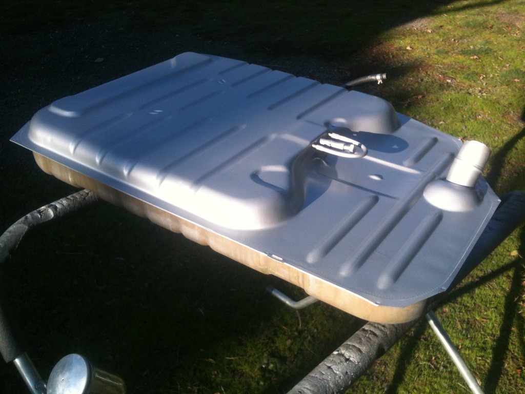

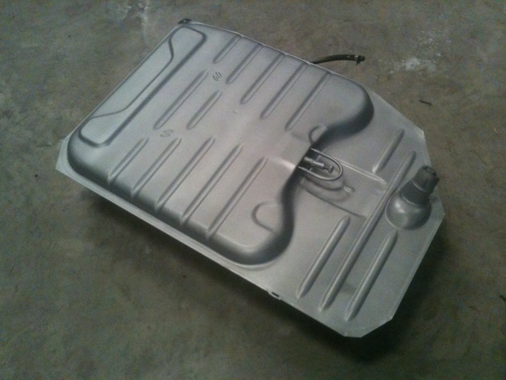

was such a nice day I preped my tank that I got blasted and got one side painted in rust bullet.

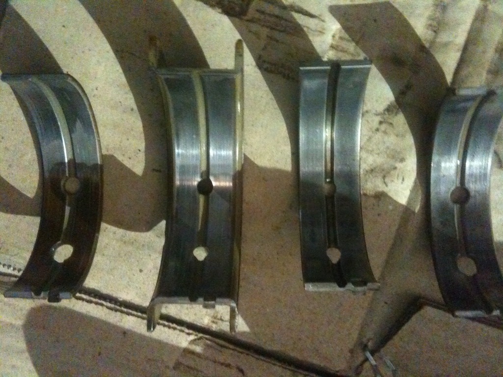

Also had a look at the bearing and oil galleries. Interesting is the galleries are different sizes as well as the oil holes int he shells.
I suspect the outer # 1 and # 4 are larger due to more end to end load from the natural unbalance of the V6, needing more oil supply to protect the bearings, but not 100% sure if thats why?
galleries go from 1-4. 11mm, 7mm, 7mm, 8mm
#1
#2
# 3 and 4
bearings 1 to 4 from L to R
