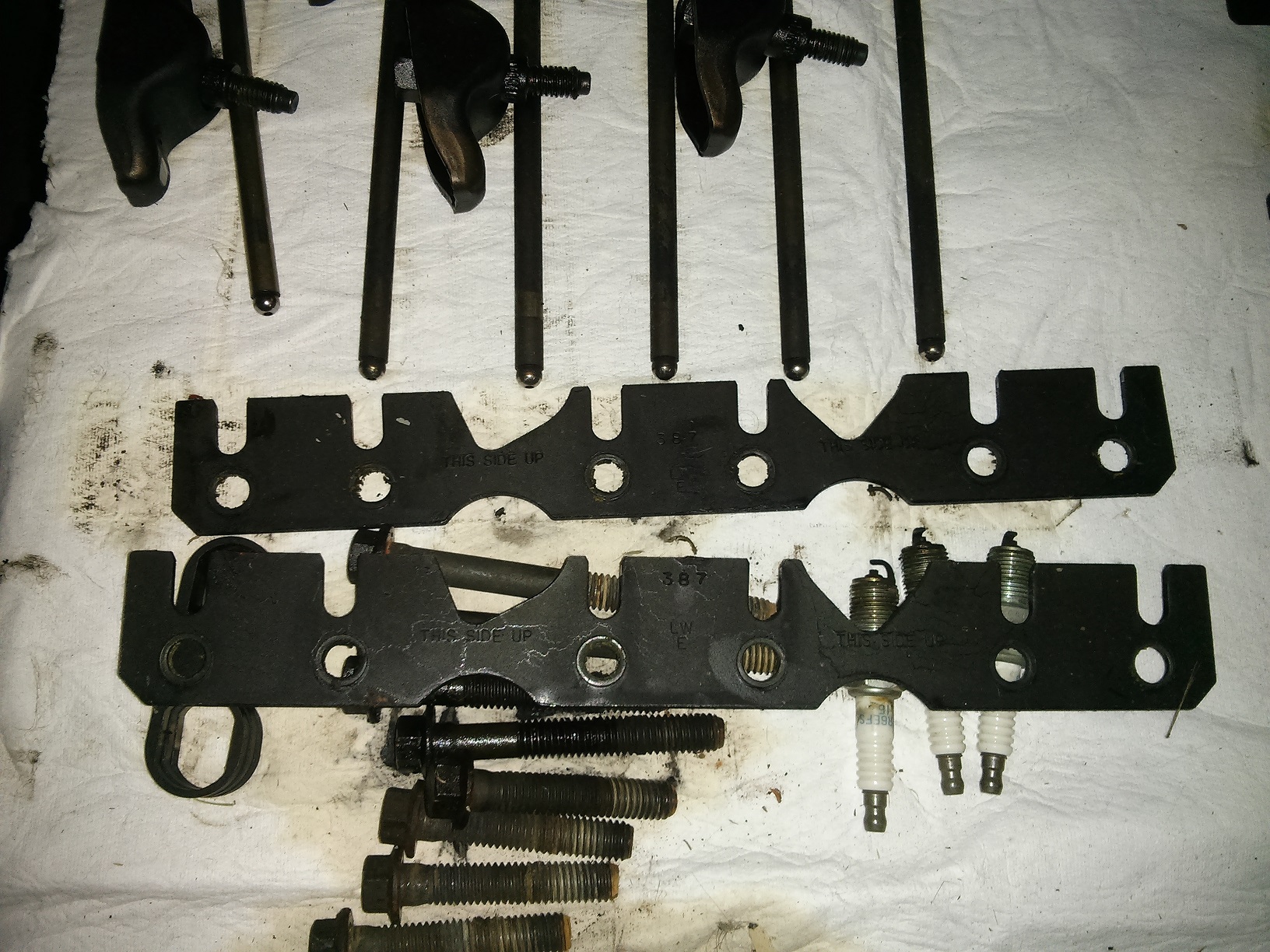

It's from a standard VN series 1 engine. I just dumped a complete valve train with those plates.

delcowizzid wrote:i stumbled accross 1 of these today first time ive seen one in a v6 commi pushrod guideplate.im trying to find a 2nd one for the starlet so i can run posilock style stud mounted roller rockers.has anyone else seen these in any holden v6
Hey delco I have a 1988 series 1 vn v6 manual motor in pieces and it has those plates as well!

so many little changes in the S1 that ive obviously never seen this version LOL.opens up a world of adjustable roller rockers at a real low price wooot

so the next question, is there enough room to machine down the rocker pedistals for screw in studs ?

theres enough room as is to wind in chev studs and use posilocks now that i have a guideplate and dont need to make them LOL.ill borrow 6 1.65 chev rockers during the week for mock up
