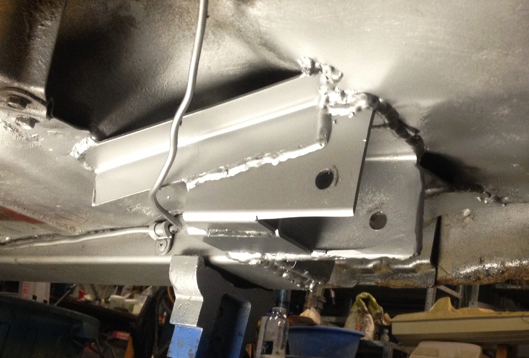

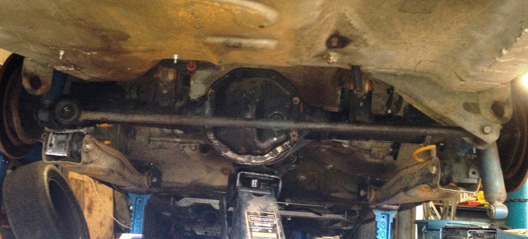

well all the hard work is done!
both sides are in and working, other than needing to be fully welded and some gussetts added.
I measured the pinion angle with the diff about 1.5 inches lower than ride height and from there to the bump stops the pinion changes 1 degree downward, so im pretty happy with that!

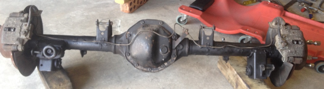

lots of progress but not a lot to show!
this once used to look like a Gemini diff modified with commodore upper arms and brakes, but now its really more looking like a short commodore diff :P
so the mounts are all fully welded up, and all the old mount points ground off and such, ready to go back in now.
I have also been working on the strengthening of the floor mounts, gusseting and such, so hopefully a bit more work there then it will be time to start putting it back together!
im pretty sure with the strengthening I've worked out its either going to work fine or if it comes out it'll be ripping half the rear end out of the car!!

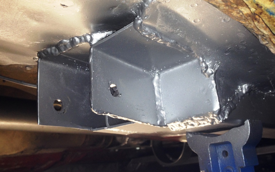

Re: My Delcoed Rides
well the driver side is completed! might not be the nicest looking but I'm fairly confident its going to be reasonably strong!
now to finish off replicating that on the passenger side and re-locating the exhaust then we can race!
