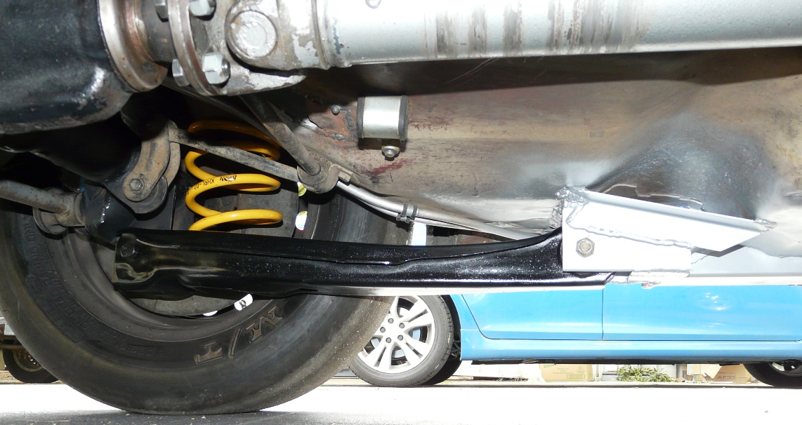

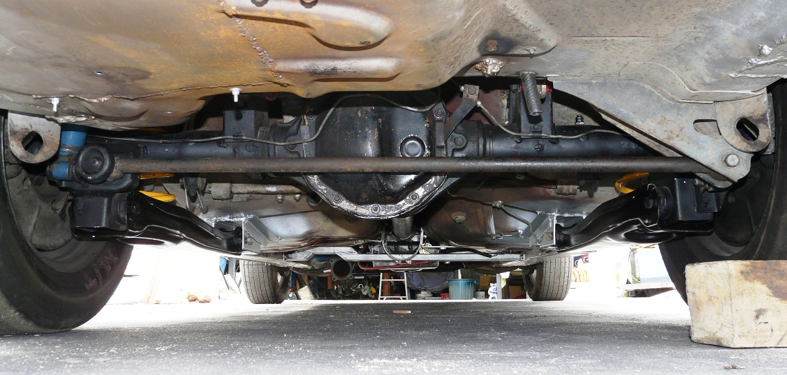

Diff's all done!! :)
very happy with the end results!
Only problem is it sits too low and lightly pushing the bum makes it hit the bump stops, but I have a set of commodore springs that are thicker and longer so i'll be sorting that issue pretty quickly :)

That's the same diff I put in my LB Lancer. I bought a diff from a Nissan Pintara which has the 3.89 ration and 4 stud axles and narrowed it down then swapped the short axle to the long side cut the other one down and got it resplined. Added an extra leaf spring and a LSD centre and it works a treat. It would have been nice to set it up with 4 link like your one but with leaf original it's a big job to convert.

I think in a way I would have preferred leaf spring hahaha much easier! although I know ultimately what I have now is better hehehe

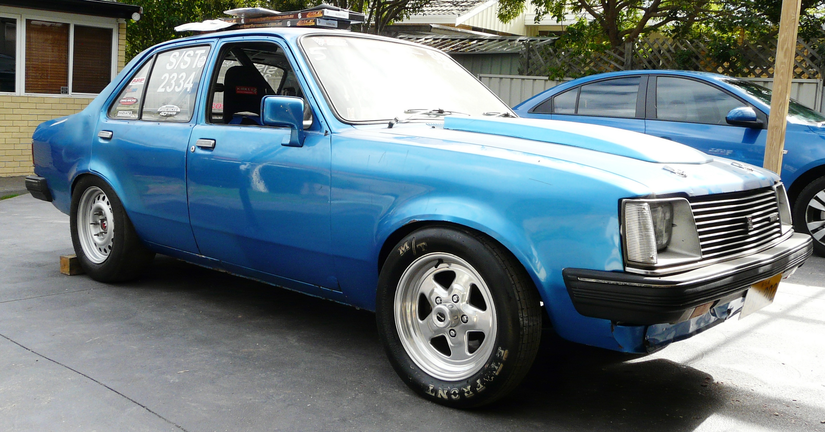

Life of luxury that concrete must be :lol:
The new trailing arm setup looks much better, nice work.

yeah man sure is, first time I've had the Gemini out on it :D its awesome!

The leaf might be easier but having no room for tramp rods the only way to reduce axle tramp was to add the extra leaf. Amazing how much stiffer the suspension becomes and the springs still wind up under acceleration. I was chasing a knocking noise under acceleration and it turned out to be the tailshaft lifting up and hitting the handbrake cable flicking it sideways into the tunnel so I would definitely like to go 5 link but don't want the rego hassles with another engineers report.
