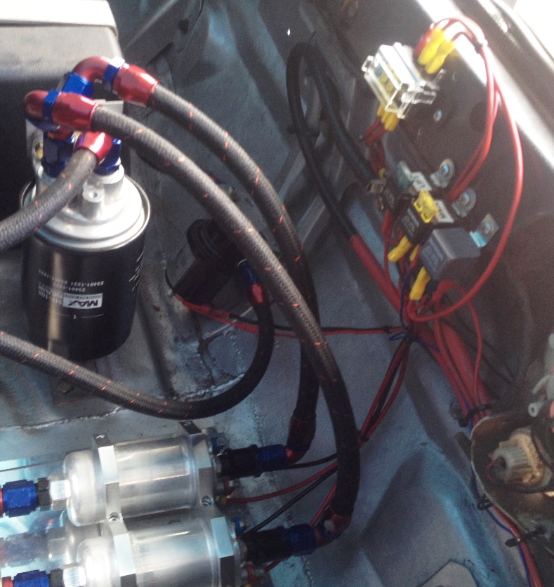

well I have been liaising with VL400 and trying to work out ways to run my twin 044 pumps only on boost....
initially started with a pwm interface to slow them both, but ended up frying that, I have a feeling that was my fault, either way it wasn't real successful, so then I tried 25amp solid state relays, these actually worked perfectly from a controlling the pump point of view, but after about 10 minutes of running they were red hot and subsequently supplying full power to the relays all the time even with the motor and ecm turned off!!
found out later they are supposed to be mounted on a big heatsink!!
so in the interest of keeping things simple going 4hrs from home to race next weekend I decided on using one pump on all the time and then have the second pump activated via a normal relay and the flex table, so I've set it to turn the pump on above 107kpa and over 3500rpm, this is usually well before I hit full boost (4000rpm ish) and its usually only higher in the revs I see a major drop in pressure....
either way I can adjust the on settings If needs be, and at least if I see a dip in pressure before the second pump comes on i'll know its making a difference!
2 x 044 flex setup.jpg (218.9 KiB) Viewed 3825 times
so the lift pump and one of the 044's come on with the ecm control, then the relay for the main pump also provides power to the second 044 relay, but then the ground side of that is only on when the flex output commands it, so this way I have flex control over the second pump and also safety in that if the engine stops it will cut them all off, as well as making the flex not active unless the engine is running.
while I was at it I re-wired the whole lot (it had been cut and changed a few times with all my trial and errors) so I have gone for oversized 10 gauge wire from the battery through fuses and to the pumps so i'll never have a lack of power there!

oh and with the second pump running its holding a perfect 66psi from the start of the run to the end! so obviously the pump was a major issue!

also the second fuel pump has made a good difference, able to hold 66psi fuel pressure for the entire run!! it was droping to about 45-50psi before i think so thats good!
