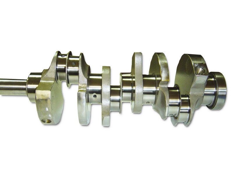

they dont like over 6500 the stock cranks even preped, shot peened and balanced. short burst should be ok but not sustained 7k lol
You want to use a forged crank like this one.
http://www.sicsix.com.au/tech_specs.html
And a billet knife edge one.

yeah thats the one i wanted but my budget doesn't allow for it so ill just have to keep an eye on it unfortunately there pretty pricey

vt3.8lt wrote:yeah thats the one i wanted but my budget doesn't allow for it so ill just have to keep an eye on it unfortunately there pretty pricey
how much are they? 1500?

Post by vt3.8lt »
got quoted 3k for one or 2.2k for a second hand one so ill just go with out and keep an eye on things
The answer is always... boost!
Posts: 8550
thats pretty expensive but not bad in the grand scheme of things as many more engines cranks cost way more for billet versions.
My understanding they are custom made for them only? I have not seen any US vendors selling cranks like this.
