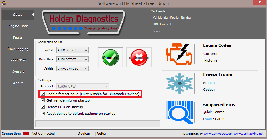

But, you can disable as seen in the image below, untick "fast baud"

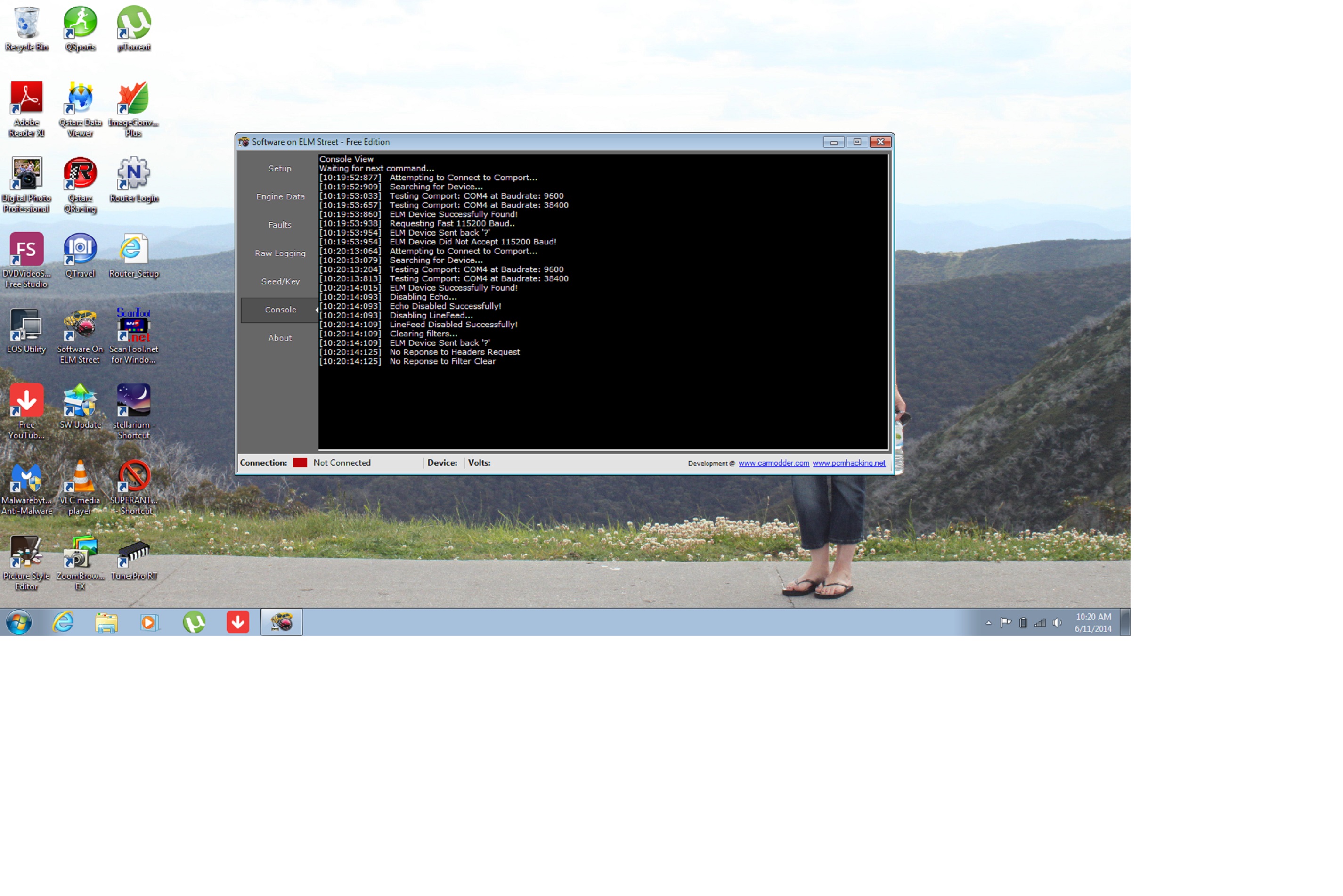

Also, from the console log, it looks like your ELM doesnt support the "Clear filters" function (which is: ATAR). So it sent back a "?".
What version number is your ELM? Any idea?
The ELM must support filter clearing since I utilize it heaps in the application!

I just tried the latest version and no go on my side.
I did uncheck the "enable fastest" and no luck with either versions.
Not sure what version my elm is...how can I tell?
I opened it up and its version 2.0

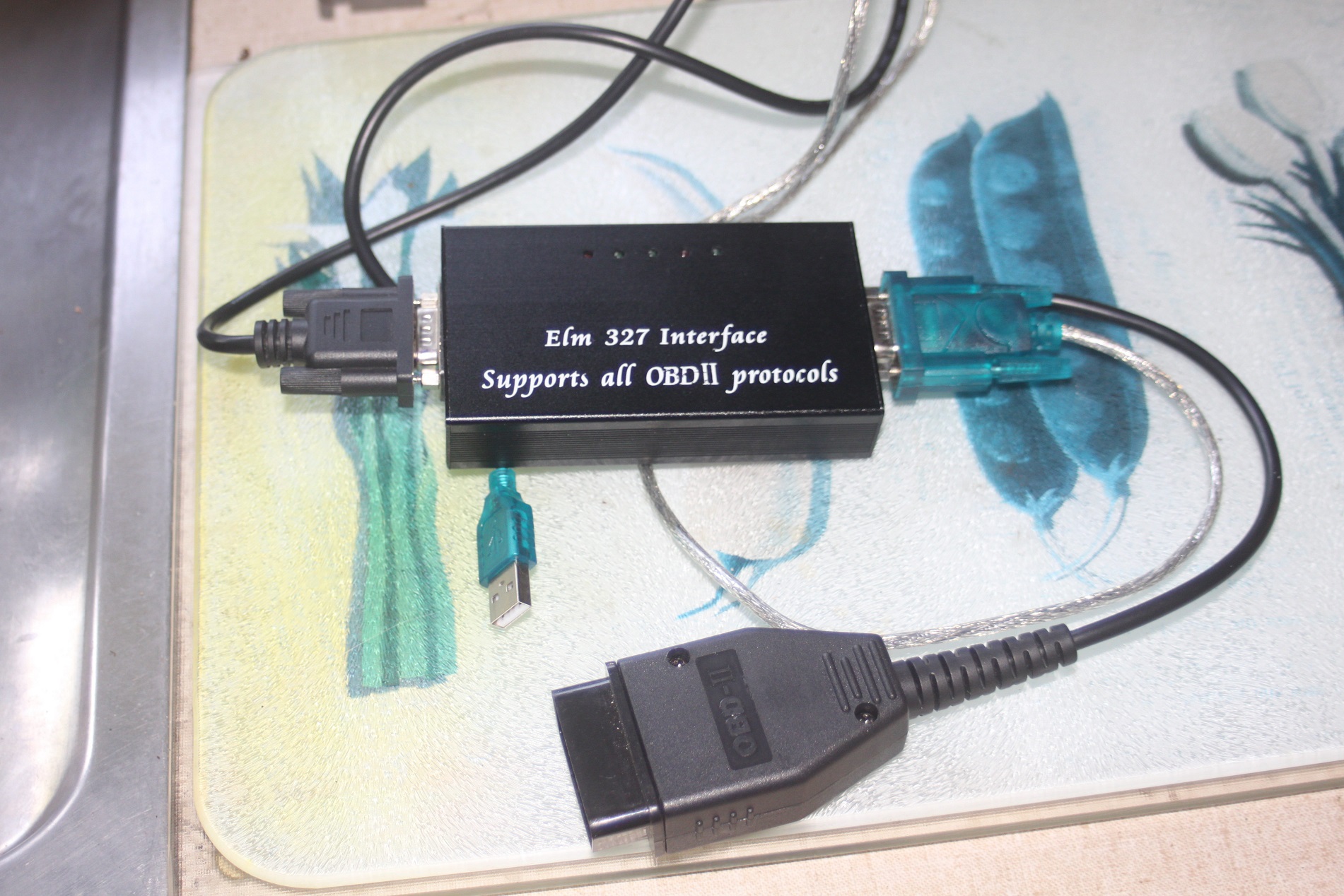

Mine is a china job that came with scantool software.

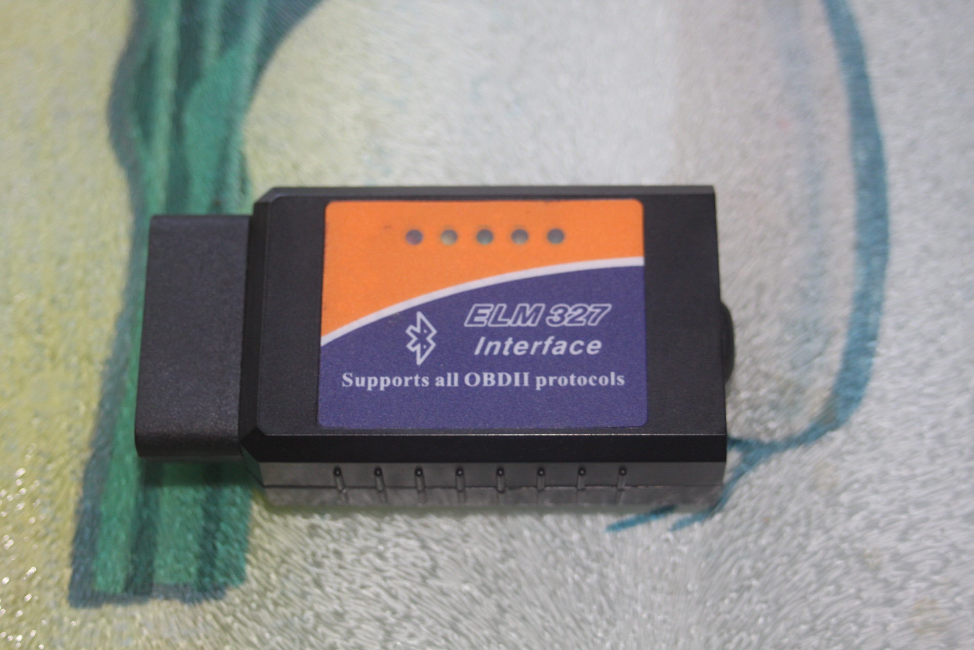

I also have a Bluetooth one as well which I haven't tried yet as I haven't added the device to my lap top but i'll give that a go too.
I have installed the FTDI drivers as well.
That first image... wow.. that looks ancient haha. I highly doubt.. even with any firmware updates, that device wont work with SOE unfortunately.
As much as I reaaaaaalllly disagree with the bluetooth devices. It should work, just make sure to have the "Fast baud" checkbox unticked
Not doing that can cause the ELM to go haywire and cause weird annoying issues to the car (But nothing unhooking the battery doesnt fix)
