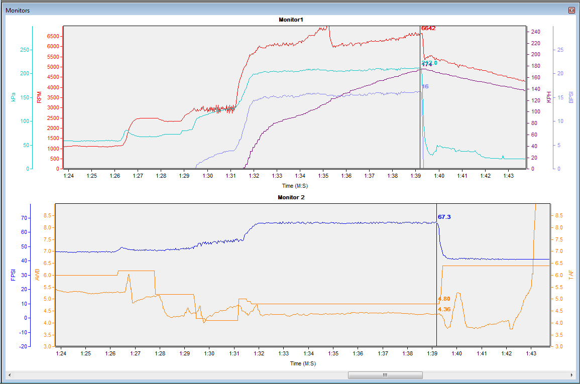

And finally holding fuel pressure once it gets on boost

on a side note, figure i should post up the log i emailed you VL400 so they can see what we are talking about.
so for those not in the know, the 1:29-1:31 is holding it on the 2 step limiter (and on the brake) on the start line, from there on is the run, also the speedo is not accurate, its supposed to be 150kms at the finish line!

Nice graph i figured that was the rev limiter. You must have a high stall convertor.
Just wondering what you used to measure/graph fuel pressure? I assume that's what it is.
