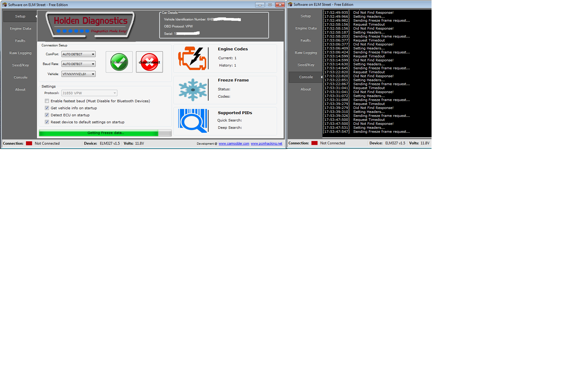

Ahhh, could you copy/paste the console log when it fails? So I can see where it is failing?
Remember I built the software based on "bench ecu readings", so when getting "vehicle data" the ecu might spit out something that I have not yet received!

Yeah that would be great mate. I can almost guarentee it will be getting stuck on the freeze frames stuff.
The freeze frame stuff is quite difficult to get working on the elm. Ill have to think about whether to remove it or not since the elm is pushed to its limits to pull that info from the ecu's hence it can fail on that part easily.

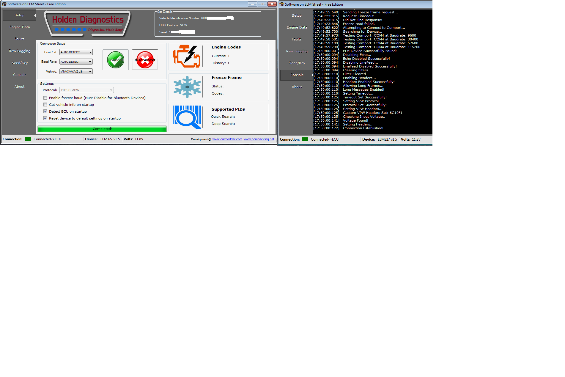

I connected up tonight and had no issue with SOE connecting to the same port as the elm ie com port 4 but did have an issue with the lappy losing the device driver.
Last time my lappy showed the elm as com port 4 but SOE searching for com port 7. This time the l/top was still on com port 7 but I had to change the port setting to 4 and
re-install the device driver.
After the above,SOE found the correct com port 4 to the device com port...so all good there.
These are the steps I took....

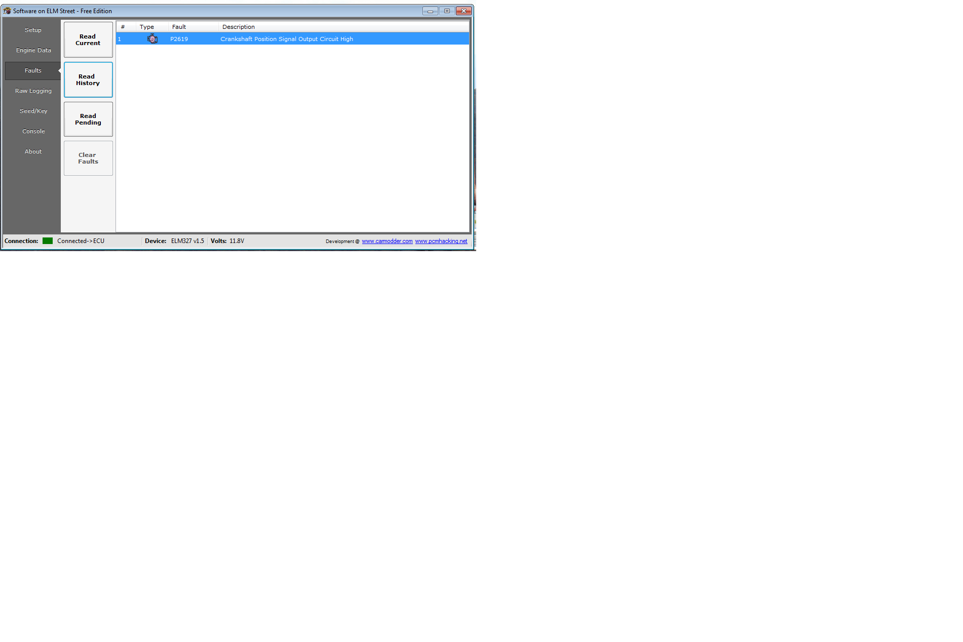

I also had this fault code but i'll have to check with my tech 2 if its an actual fault code present.
Def a freeze frame issue.
Let me know if you want more testing :thumbup:

Yeah definately a freeze frame issue there. Looks like it's grabbed some information.. But failed right near the end.. Hmmm... I'll have to add in some more error catching there to narrow down the problem.
Stupid freeze freeze frame is causing issues in both the can and ls1 protocols!
