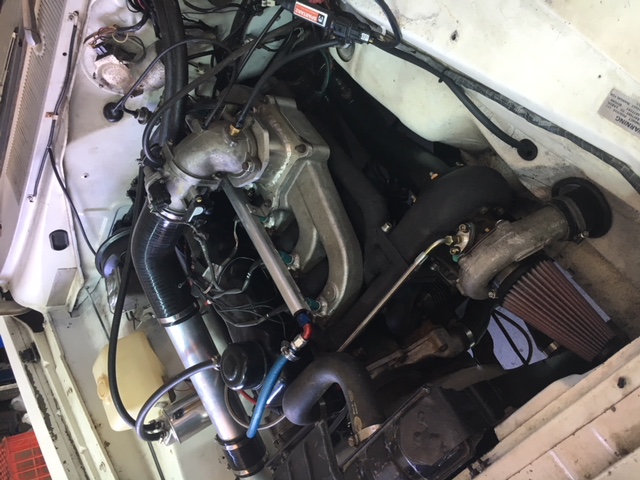

Looks like it would be a good option for the VP to be track car. So far I have dropped 8Kg with AC system removal, next is the 20~kg from the tow bar, then another 35-40kg from the sound deadening. Another 7kg from the battery would be good.

It all adds up. There is lots of scope to further reduce weight in the Dodge/Valiants , a lot of the brackets are way heavier than required. Also seats are heavy.

It’s alive, I drove it from the exhaust fitters to the mechanic and it was hard not to give it a hammering but I was watching the AF gauge and it was leaning out under acceleration so backed off. I love the exhaust note with the 3” system. Not as loud as I was expecting which is good but still a gutsy note. Once I replace the injectors and the tune is updated I will post a YouTube lip.
