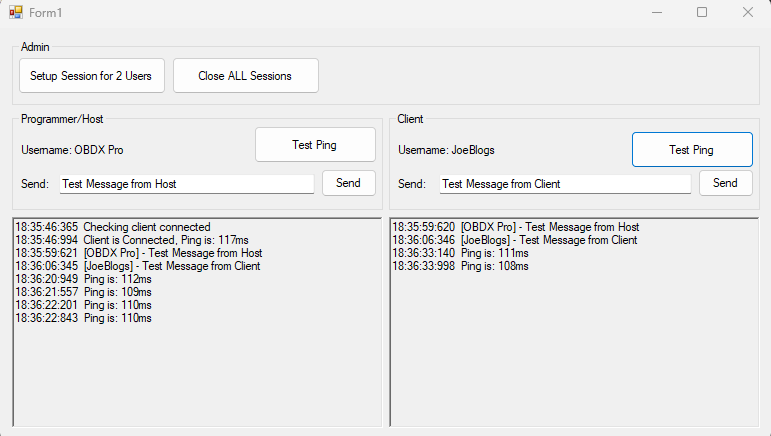

It might not look like alot... but theres some cool stuff going on in the background here
This is just a template socket application using Azures setup which I have integrated my own command structure to allow performing individual actions, so far we have:
1) Ping check which is the total time to client and back (Not just the server).
2) Chat Message to allow live communication between host and client.
3) J2534 Commands which are how we pass the J2534 requests
I implemented the chat section since in the event of key cycle or specific commands needed, this can be communicated via the chat live instead of relying on 3rd party apps.
The ping 'seems' high, but I typically see a latency of around 25ms when I connect to a server in Sydney (As I am in Perth), so its 25ms to the Azure Sydney server, 25ms to the client, and then the same time back to the host again. This does indicate the importance of which server to be using. Azure apparently has a ping bot that I can test off to try automate server connections.
But as this is sending data in chunks, the latency is not as bad as when other solutions may be trying to emulate/simulate a USB port over the internet which does result in severe latency.
The whole system is being built completely off of a JSON string setup, so efficiency is not exactly fantstic, but due to the complexity of the J2534 structures, it will be the best option for now.
Hopefully in the next couple days, I will be able to demonstrate some live programming examples using remote J2534 with the new Azure setup
