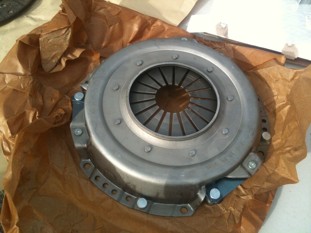

Ford AU pressure plate.
standard Holden plate.

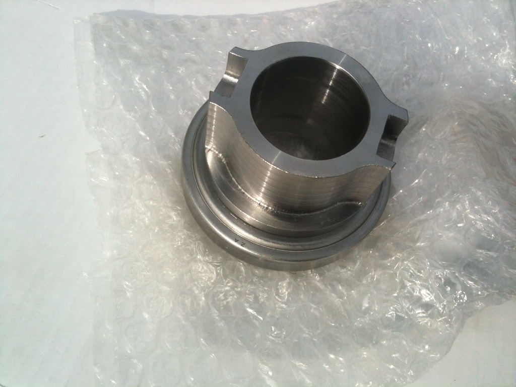

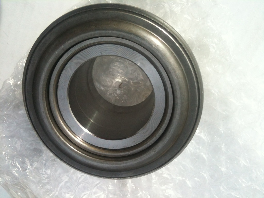

this was real nice. I wish I knew about these like 5 years ago. Soooo much better than standard plastic shit.
billet steel carrier.
here is the part number for those who might want one next time. Not cheap, 150 just for the bearing, over double the plastic one.
worth it if it lasts twice as long though!
so why the ford pressure plate ?
yeah it will last more than twice I reckon.
As for the clutch pressure plate, AU one has good clamping force and not too heavy compared to the V8 ones on offer for Holden.
AU makes lots of torque, much more than the standard V6, AU makes about 370-380Nm. My engine should fall close to that range.
This was a recommendation by Jim Berry at race clutch.

Nice carrier, you should never have to replace that again, just change the bearing on the end of it
:thumbup:
