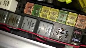

in the engine bay fuse box have a look at the top of the efi relay if it has a heat mark on it like a brown stain swap it out with 1 of the other relays i have seen this on many vt-vy commodores cause the problem you describe.

thanks vlt304 will check that out as well. good intel
