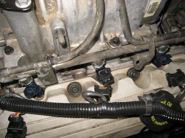

Hurrah, my new injectors arrived... but the missus needs the car for the rest of the day... boo!
Somehow oblivious to the fact the listing said 8 injectors... I have two spare now. :mrgreen:
Worked out $AU140 .. bloody cheap ... oh, and another 40 odd for the ev6 adapters.
The next mission is ready to play with. Probably shouldn't get so excited, but hey. This engine has grown on me.
Cheers!

Interested. Where did you get all the injectors & ev6 adapters from ? Are they sized to suit L67 or N/A ecotec ?

about 40lb at 3.5 bar

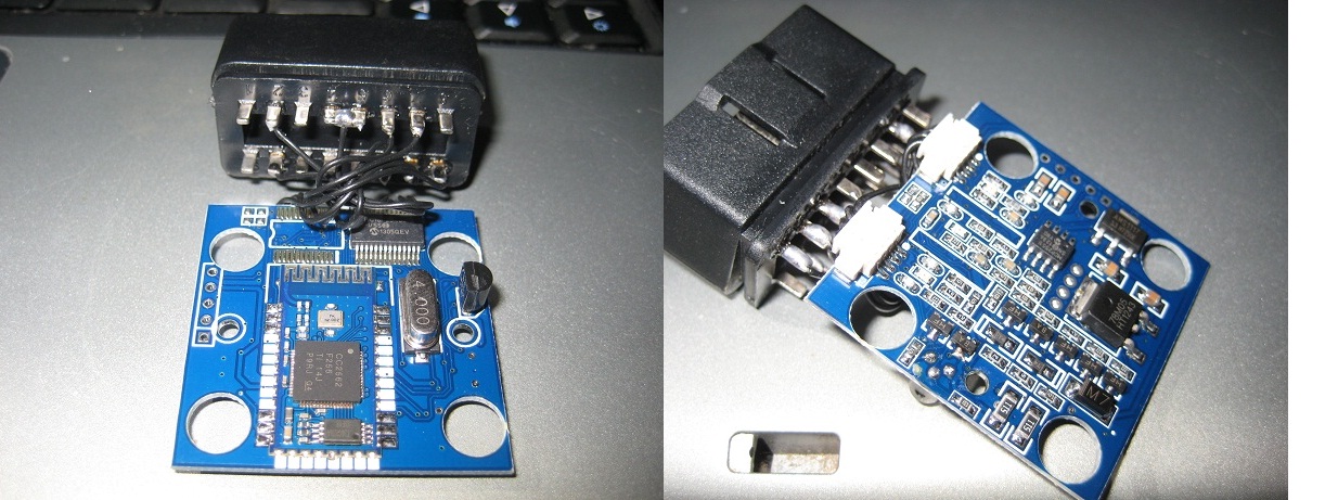

In other news, I went looking to see what my Bluetooth OBD adapter looked like on the inside... is it wired to aldl/J1850 or just obd2/ISO9141.
If I'm not mistaken thats the protocol type vs pins.
Its wired to all three, CAN J2284 too apparently... I'm now wondering why ALDLdroid didn't see the ECU.. might try debug mode too see if any comms are happening, might be something fixable.
It was only a cheap $10 adapter, but so far it has paid for it self on a VZ V6 with Torque... so its not complete crap. And common.
Also confirmed my other 'not working' usb-obd cable is a simple ch340 to obd2 only... not so useful for me.. could modify it, but no need.. FTDI chip instead!

First drive of new injectors
Still have a small miss fire.. will try some fresh BPR6EF plugs after a visit to town this evening.. hopefully the tighter gaps will cure the last of it.
new_inj_1.zip
VS_SC_$51_Enhanced.adx req'd
Started better from cold, drivability seems 'normal' , but the BLMs are still a bit mad.. but too early to tell.

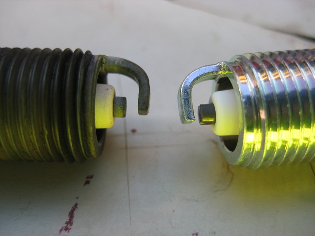

Was pleased to find out the plug gaps I want are off the shelf.
Cheers.

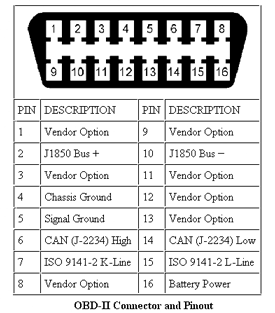

ralcool wrote: In other news, I went looking to see what my Bluetooth OBD adapter looked like on the inside... is it wired to aldl/J1850 or just obd2/ISO9141.
Note that ALDL is not J1850.
ALDL is also known as UART, is 8192 baud, and is on pin 9 which is not connected in your photo.
J8150 is also known as VPW and is one of many OBD2 protocols. Its the older one used by '0411 pcms.

So I put the new plugs in today, such a difference in gap.
Old ones were some spare BPR6EFS-15's adjusted to 1.3mm... they've all opened up a bit to over 1.4mm, memory effect?
The new ones are just BPR6EF, they all measured 1.0mm inside the V-groove to the electrode as supplied.
Go for a drive a bit later see how they went, yesterdays logs showed the BLMs settled nicely- both banks seem happier.
Hopefully miss-fire cured.
:driving:
Edit, Well that went well. :punk: Back to full power... use Clarksons voice for full effect.
