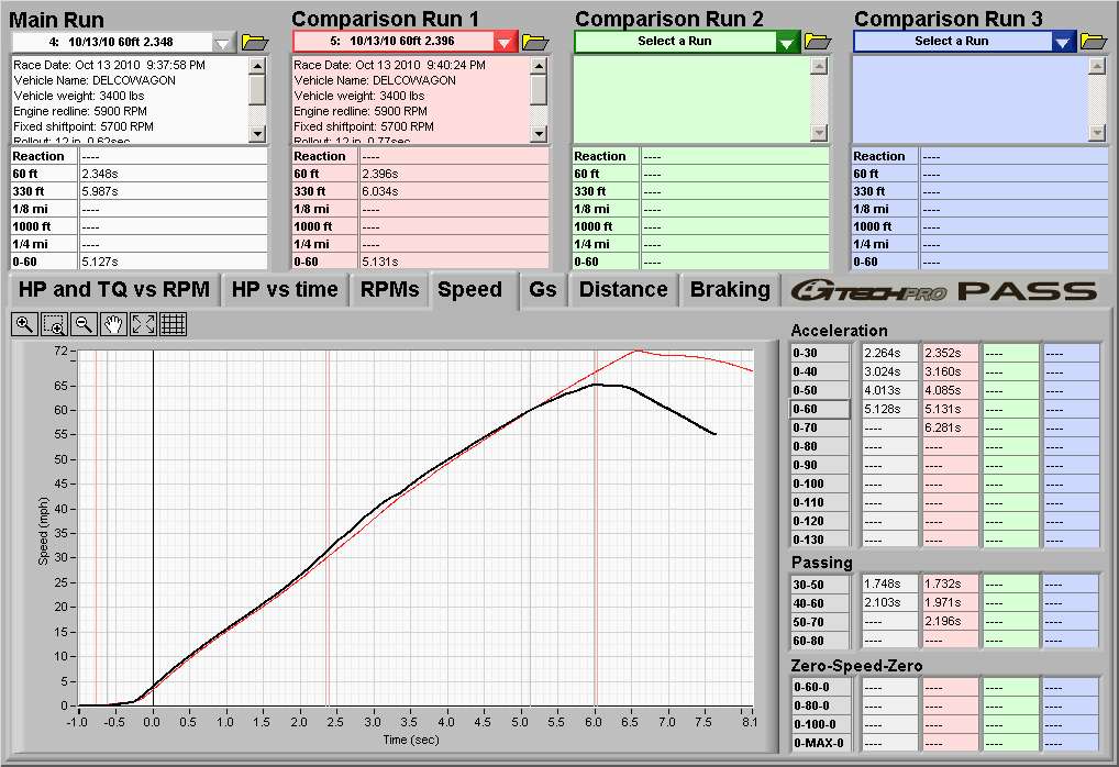

yeah now to crank the boost back in :mrgreen: and gtech it for 0-100 time :driving:
Posts: 5714
Re: DELCOS NEW RIDE
so close to sub 5 seconds
