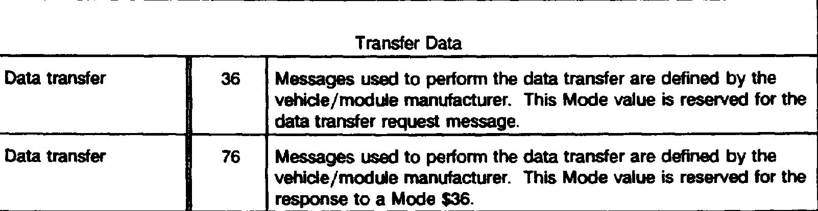

There's this...
-73-
BLOCK TRANSFER COMPLETE / NEXT BLOCK
This response code indicates that a block transfer operation has been completed successfully.
-78-
BLOCK TRANSFER MESSAGE CORRECTLY RECEIVED
This response code is used to indicate that the block transfer message was received correctly,
and that any parameters included in the message were valid, but the action to be performed
may not be completed yet. This response code can be used to indicate that the message was
properly received and does not need to be retransmitted, but the receiving device is not yet
ready to receive another block transfer.

}There's this...
-73-
-78-

In-Tech,In-Tech wrote: -73-
-78-
It appears you found the lost document, where did you find it?
Thanks
