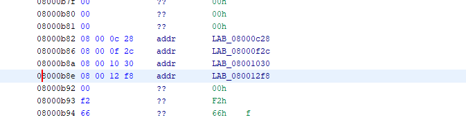

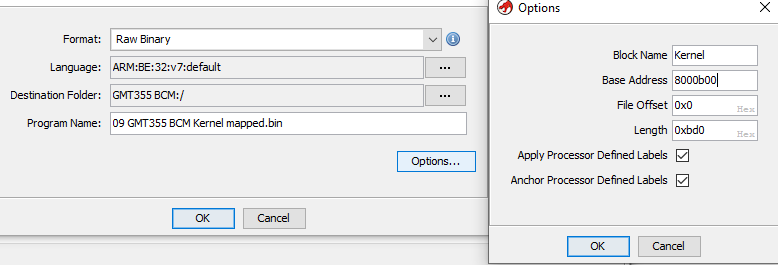

You're right on with all of that. I threw the attached file together yesterday. It's the flash kernel remapped as it would appear in RAM. Load it into Ghidra with the following settings:bbmike wrote:The B0 in the utility file is a download to ram instruction that creates the mode 36 message. The 40 is the module ID the next byte is the routine to download from the end of the utility file. Next byte is unused. Then the next byte tells to download and execute or just download. 00 means to just download. The B4 is similar to B0 but is used to download calibrations. I think the AE command just before the first B0 command jumps the program code to the bootloader and waits for the ram downloads then the calibration downloads. The utility file never sends a download with an execute command. From reading the data sheet I would think the ram downloads are downloaded to 0x08000B82. The bootloader must add the 80 onto the address because the mode 36 only use 3 byte addresses.
Let it run the auto analysis if you want. I don't know if it matters. When that's done, go to 0x8000b82, and create four address pointers (P key). That'll give you the entry points for the four main functions in this thing.
Then you can go through the code, and see what a vague mess it is. It's nothing like the truck EBCM TMS470R1X kernel that I took apart. That one followed the TI example code almost exactly.
It makes no damn sense to me. If someone else can figure it out and post their findings, I'll be the first one in line to buy you something really nice to drink.
