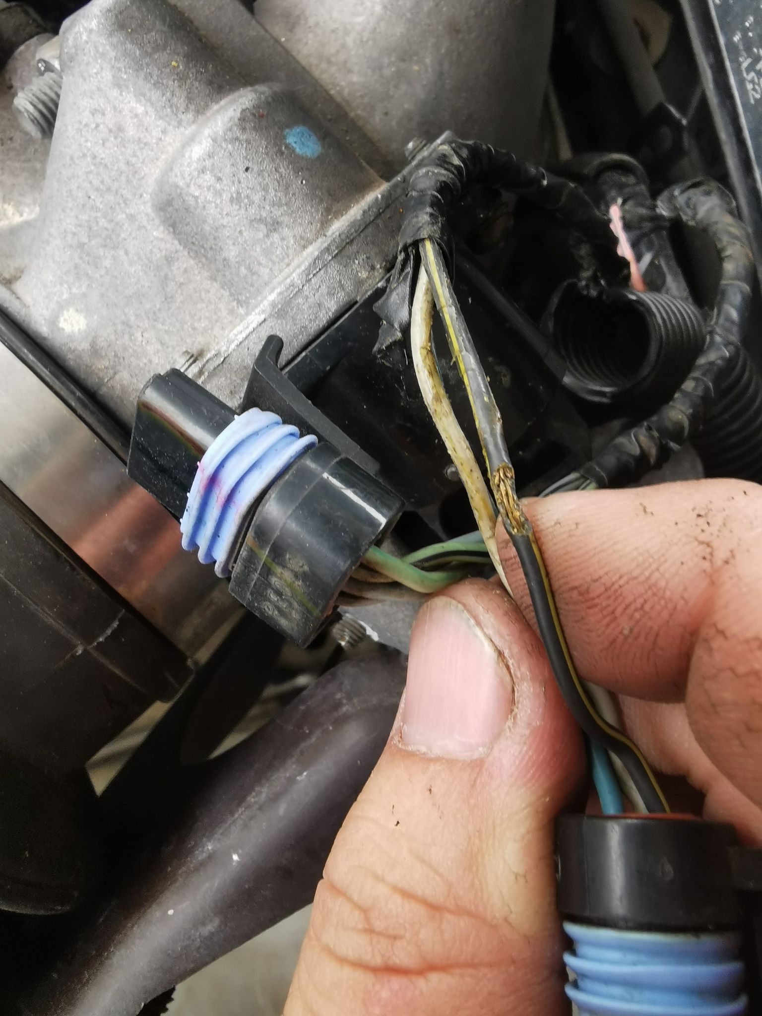

So had a look at my tps wiring today and stumbled across this taped up. So fixed it up hopefully fixes my tps issues.
Edit 10km into my drive to work today and while driving I got the usual weird thump from trans and it went into limp mode again fml
no check engine light comes up for the Tps fault also?
