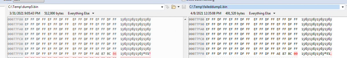

something really strange showed its face the other day as well with the JTAG. when I disconnect the JLink interface and reconnect it....the bytes that I wrote new data too in the flash revert back to original. I found this by comparing flash dumps. One dump its there, unhook and reconnect, next dump it's gone.
So basically anything I feel like I may have learned from shooting bytes in with JTAG is probably not true...

I did confirm on a failed canbus cal only write that the data does make its way to ram, just the controller is stuck in a dead poll and switches canids to the recovery IDs.
maybe the routine for the switching of canids would be useful to decompile? just a thought. normal ID is 0x643. recovery is 0x328.
