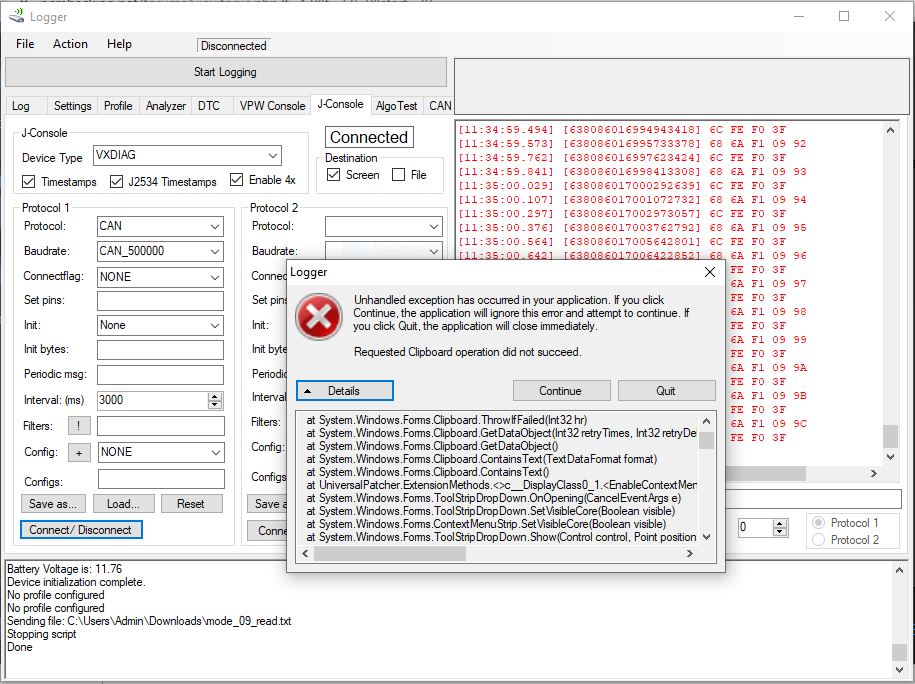

Re: Universalpatcher with Logger & Analyzer
got nodda
- nodata then error.JPG (152.98 KiB) Viewed 12516 times
The script you are trying to run is for class2 pcm, not sure why it crash, it may not like the message format.
I can only guess you are using a vpw vehicle and try to connect to it via CAN, since there is no data comming after you connect to CAN.
You can use vpw console[tab]->connect mdi from settings got to vpw console tab mark all checkboxes and you should see data flowing, than you can send scripts and custom commands. I see battery voltage read is almost as zero. could be the mdi is not powered from obd2 connector.
ive got it on my table hooked up to a e38 with a y splitter harness while programming, yeah my second obd plug isnt powered. i will power it and see what happens
Without bus power mdi will likely not log anything.
