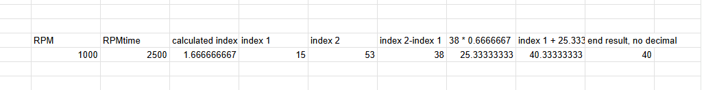

pman92 wrote: Wed Jun 11, 2025 12:15 am I've got wrapper functions that use those lookup functions as well. Eg
   uint16_t EGT2_millivolts(uint16_t egt2_temperature){
    return (lookup_2d_linear(egt2_temperature,
                            calibration.table.outputConversion.EGT2,
                            TABLE_EGT2_OUTPUT_CONVERSION_SIZE,
                            TABLE_EGT2_OUTPUT_CONVERSION_MIN,
                            TABLE_EGT2_OUTPUT_CONVERSION_MAX)
I'll definitely come back to that at some point.
To interpolate cheap, I'll probably get my index number (0-31), save it, save it plus one(1-32), pull each of those VE/spark numbers, then use the decimal (from result of {(2,500,000 / (RPMtime * 600))}) as the percentage scaler between index and index+1.
Numbers pulled from stock LM7 tune.
Don't stress specific units.

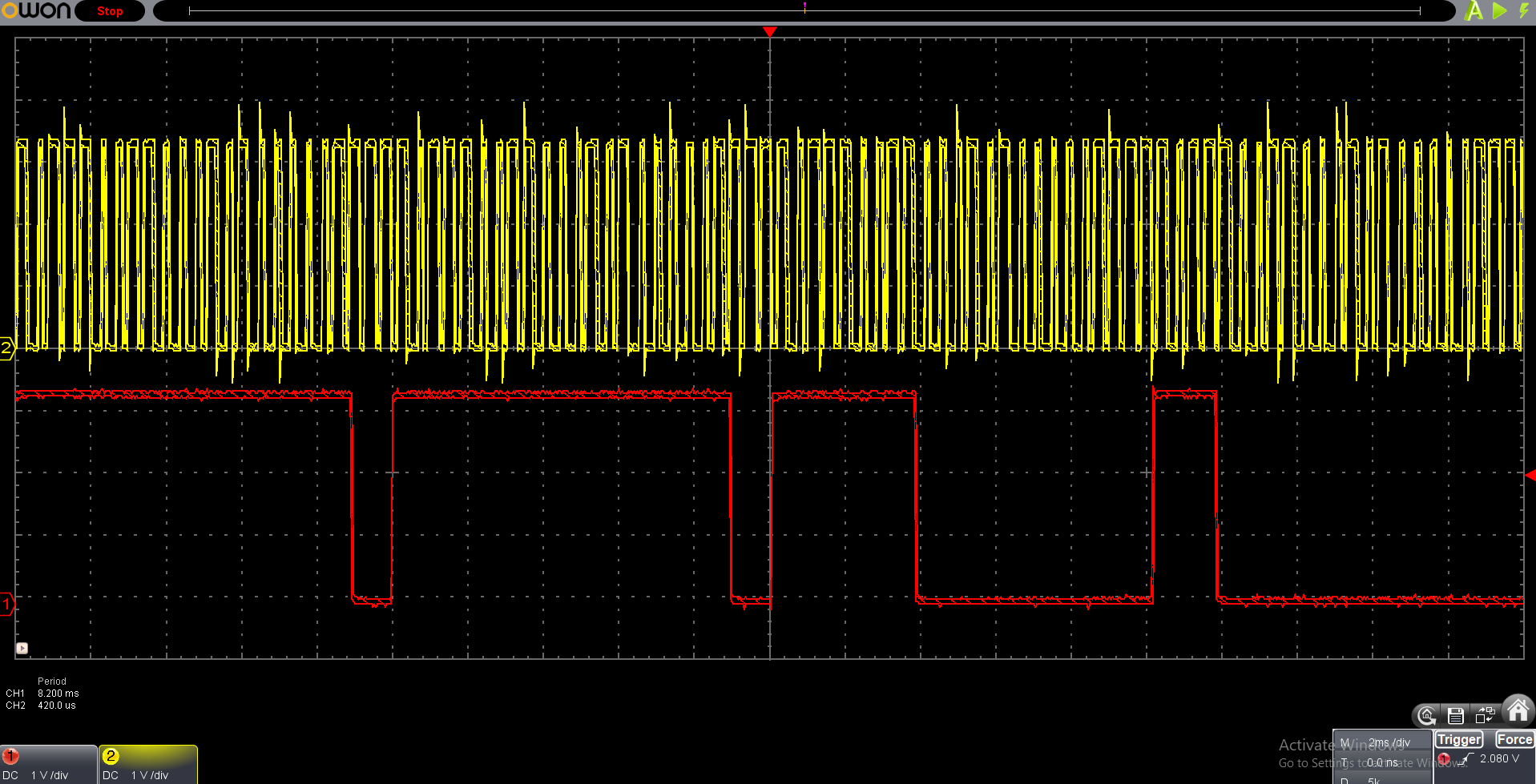

Hooked up oscilloscope. Most recent code change didn't softlock. Rewrote array for RPM based change to test that.
somewhere between 16,000 and 26,000 RPM it gets pretty bad.

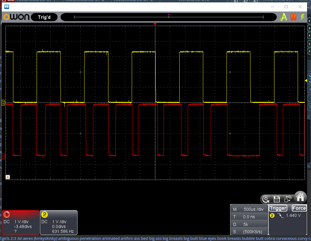

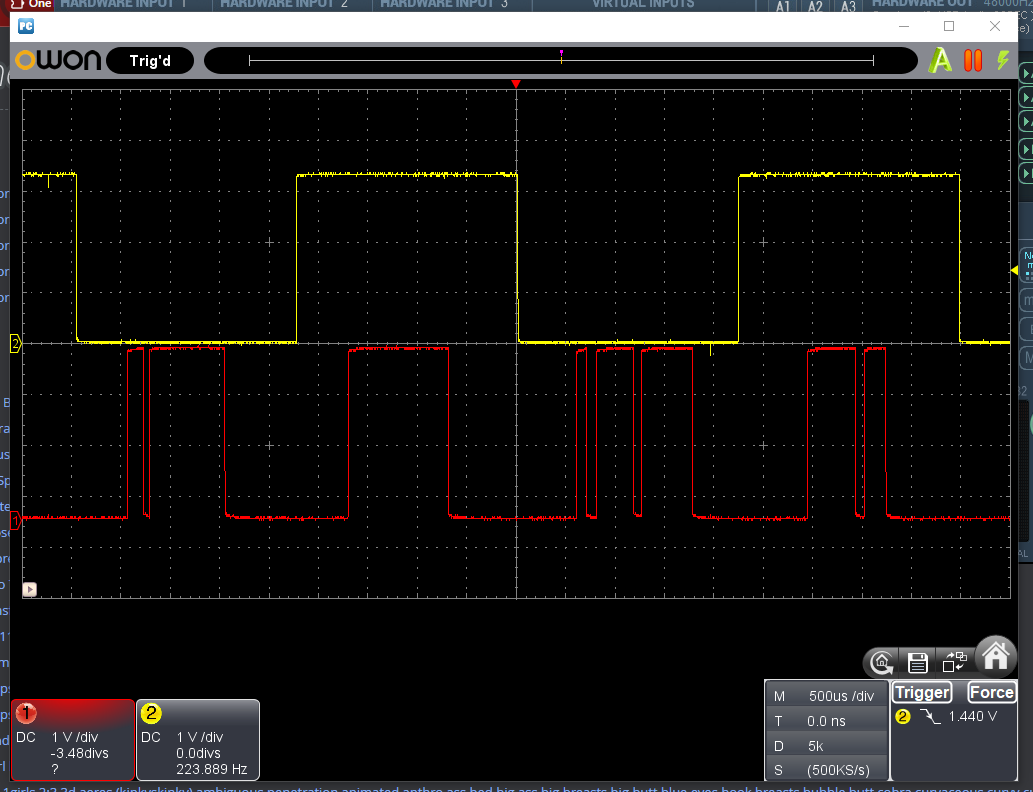

Alright, addressed a little code
RPMTime = constrain(RPMTime, 134, 125000);
That 134. Was 125 for 20,000 RPM; but array maxes out at 18,600 RPM now, which can be changed of course.
And zeroed out on delay (Istart array). (Wonder if that little bit could help the OEM ECUs hit higher numbers.) The ways it messed up looked similar on oscilloscope.
Now it's somewhere between 39,000 and 75,000 RPM before it even gets a little flakey.

Seeing ~ 50 maybe as much as 100 microseconds of slop regardless of RPM.

Between 5,952 and 6,037.2 measured RPM, I see some very messy and Inconsistent scaling. Like swinging between the 2 adjacent values and sometimes in the middle. Maybe I need to limit decimal places in my floats (Frac). Not sure what to make of it yet.
https://www.youtube.com/watch?v=A4_zRVw8nag

Maybe I'm dumb. I'm getting results as if Frac is randomly anywhere from 0-100.
Yellow is crank signal (for better visual resolution), red is injector output.
