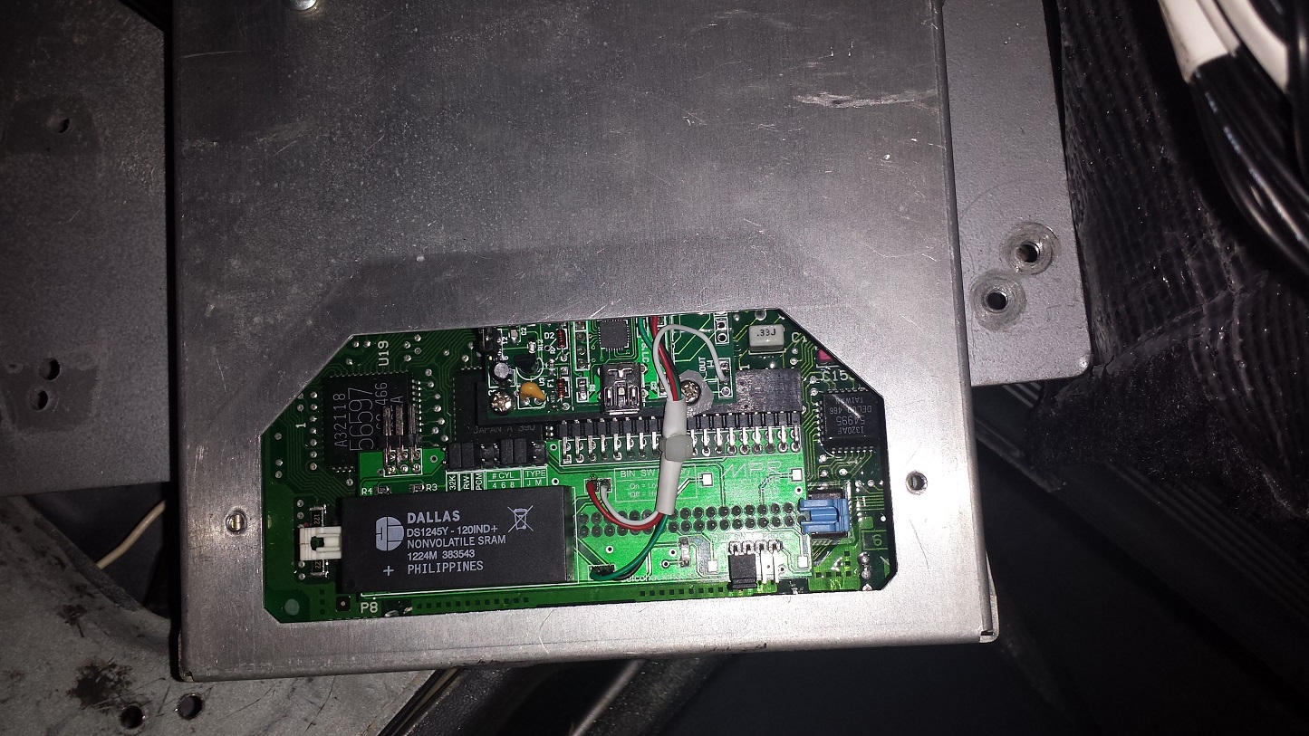

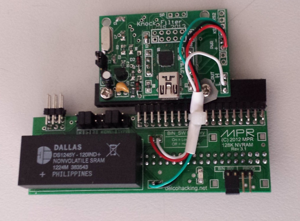

Installed a festy knock board (http://pcmhacking.net/forums/viewtopic. ... 820#p18897) sometime back and have only just recently started to look at setting it up. Managed to make it fit on an NVRAM board..
And installed in the PCM..

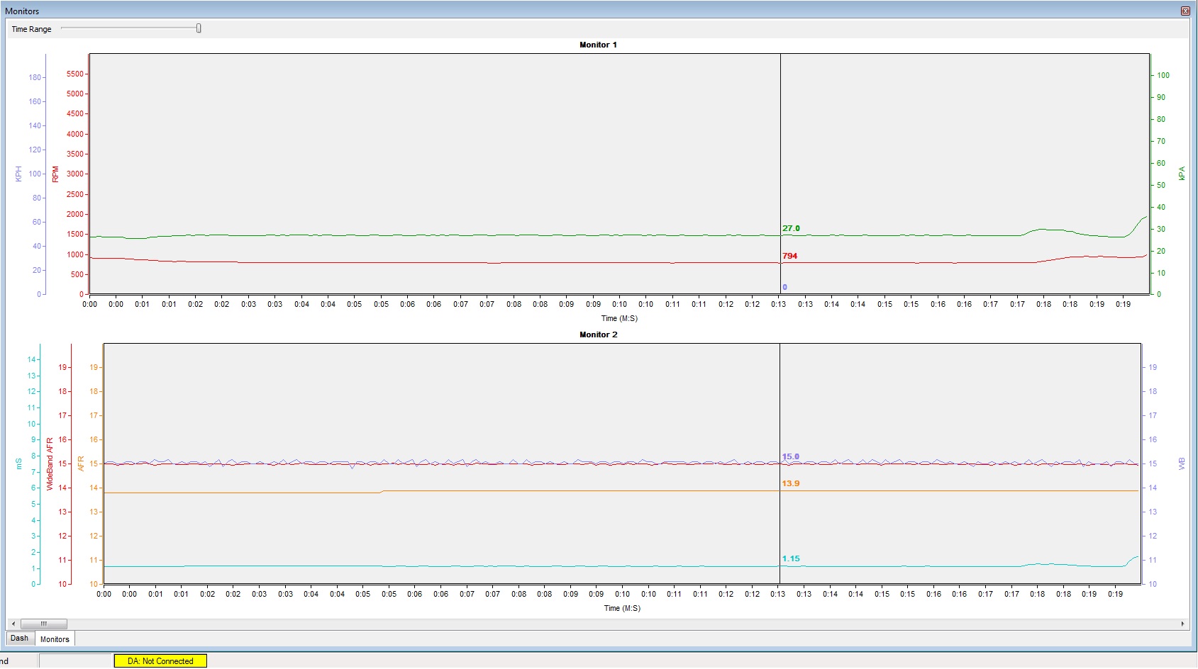

Of course, suspecting the ignition system first then the 11P code. Spent ages on the bench, scope on the car, timing light etc. First thoughts were a misfire is happening but cant hear or feel anything. Swapped the sensor to the other bank in case it was a vac leak or exhaust leak but got the same results. So set the MTX-L up to output a constant 2.5V or 15.0:1 AFR and went for a drive to check if its just the infamous analog offset problem.....
Not great but software filters it out nicely with the logger analog input (bottom monitor, red is filtered logger input and blue is the raw). But its no where near as bad as the jumpy crap in the first picture.
