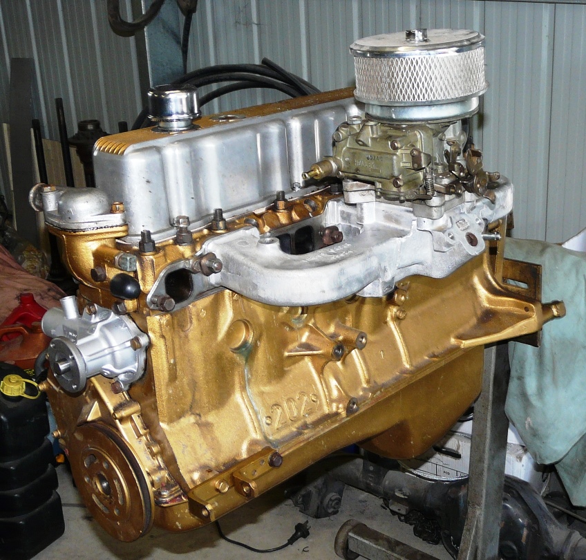

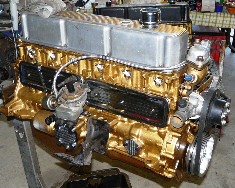

on the gemini i have my dash gauge in the rear of the head driver side, as for the ones near the exhaust ports, especially with boost, you'll find that it reads up to 20 degrees hotter than the engine is actually running, because of this i have moved my ECM sensor to the bottom of the thermostat housing ... but looking at that thing you have a commodore thermostat housing so you might not be able to do it, but if you get an earlier one you can do one of the two options below
this one requires drilling and tapping the thread for it, and squaring off the hole end. this one is more of a bolt in job if you can find the right thermostat housing with this hole in it, normally has a big ass temp sender in it.

sweet ill mod the housing LOL im seeing 103*c degrees solid once warm .800rpm idle 25-30 psi oil pressure 1500rpm 40psi must be in ok nick ide like to raise it a bit though
