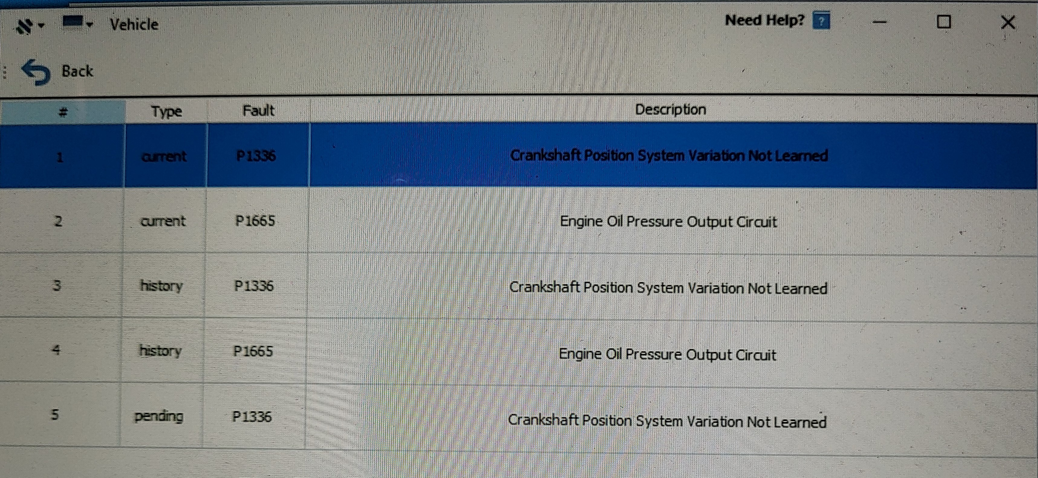

Oh yes this is much better. Not a whole lot of chance to play with it before the kids got up, but it looks like the correct codes are coming through, and I like the new graphs. I did notice that the pid list is still sortable, and I think at least one of the codes that I have has the description incorrect. (P1665, evap vent. It says something about an oil pressure output). Super interested in the histogram interface, that will make tuning much simpler.

Yeah, P1665 is listed as "Engine oil pressure output circuit", when it should be evap vent circuit. Having a 96 c1500, the evap system is only partially compatible with the 0411, and the vent solenoid is left unplugged. Image attached, sorry about the photo of a screen.

The definitions I have match that of GDS2 (What they use for GM diagnostics on all new vehicles) which indicates P1665 is related to engine oil pressure?
I wonder if your specific vehicle uses a different fault code list??
