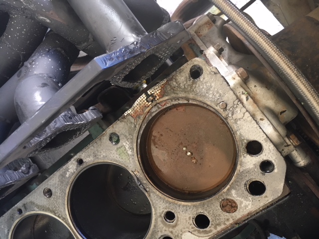

This is the offending gasket failure

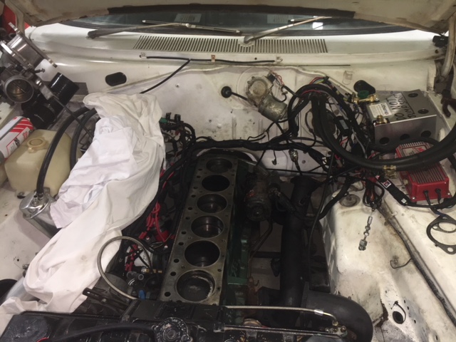

To make a positive out of a negative removing the head gave me the opportunity to clean up the wiring looms with Techflex braided sleeving.

Sure looks like detonation, wow that gasket sure got push out hard.
Good idea to get some knock ears and listen out when tuning.
Posts: 5634
Re: 265 Hemi to efi
Next cylinder took a hit too.man those steam holes it blew into are close to the cylinders

vlad01 wrote:Sure looks like detonation, wow that gasket sure got push out hard.
That was my bad, I was trying to see if it was still blowing smoke so gave it too much pedal pre tune and heard a kind of pop. The reason it was blowing smoke was because some idiot pressurised the crank case (not me) when setting up the oil catch can. So kind of a ship of fools. Well you live and learn

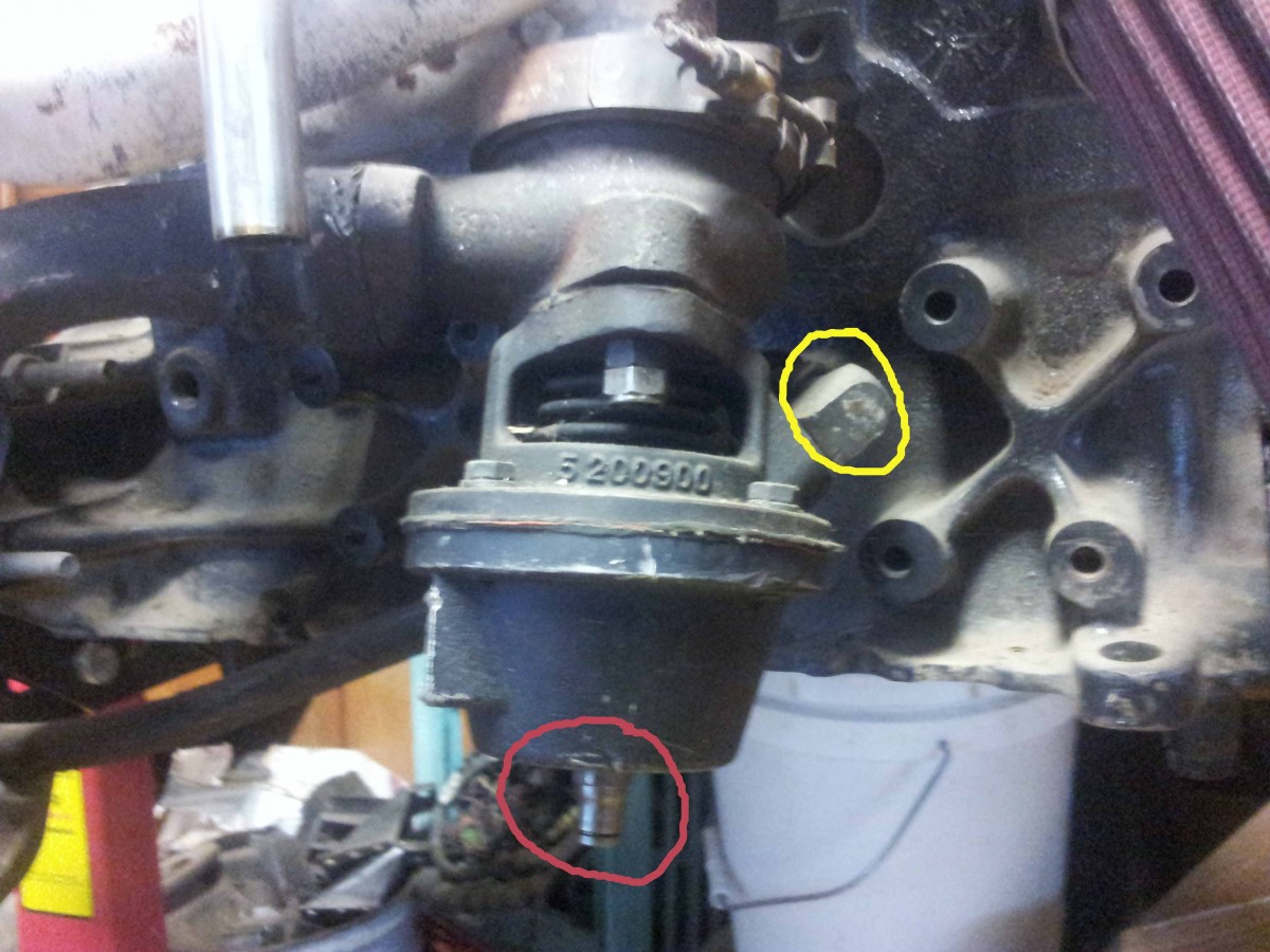

heff0018 wrote: On another point has anyone had any experience with manual boost controllers. From first looks it Seems like a better option than changing out springs bet are there any negatives? Any input is appreciated.
This is how we use to do it back in the old days (pre EFI).

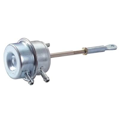

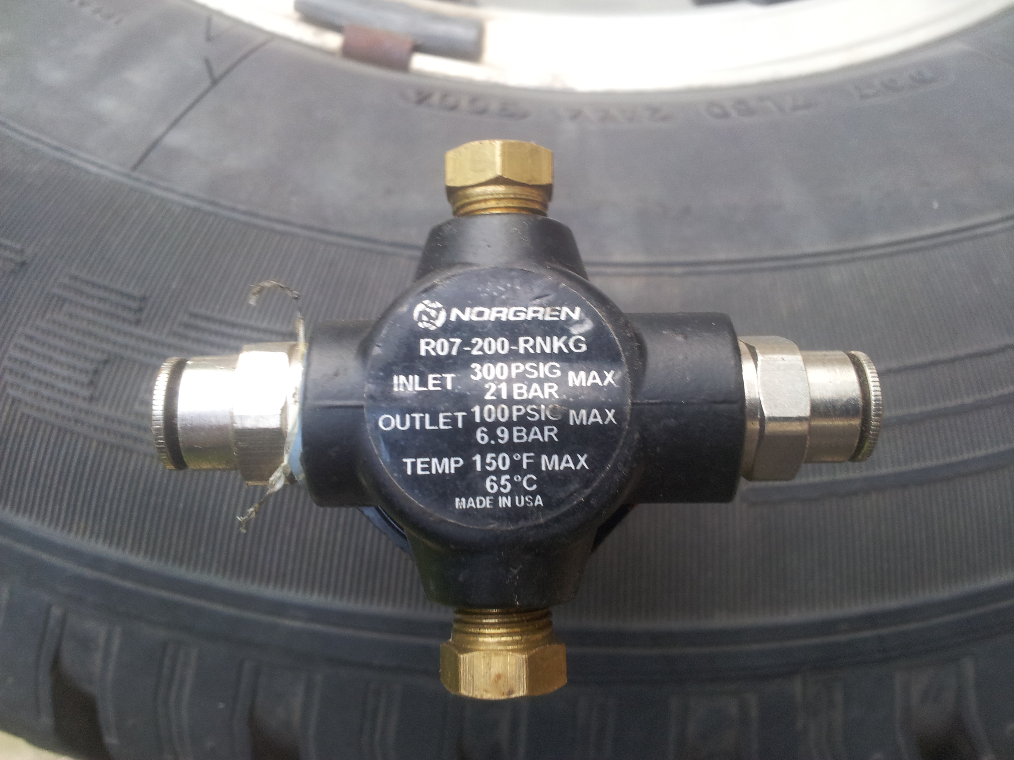

The yellow circle is your normal boost hose used to open the wastegate. The red circle is plumbed to the other side of the wastegate diaphragm. By using a pressure regulator located inside the cabin you add boost pressure to the red area whenever you like by simply turning the knob of the pressure regulator and your boost changes instantly to whatever you like. This effectively increases the pressure required to open the wastegate. Minimum boost is determined by the spring in the wastegate (9 PSI in my case). Maximum boost is set to whatever you desire by turning the pressure regulator knob in the cabin and it can be adjusted at any time to any pressure while sitting in the drivers seat. If going down this path the pressure regulator in the photo is the one you want as it is fine enough & accurate enough to allow for small increases (1 PSI) at a time.
You can do the same thing with internal wastegate by using an appropriate actuator such as the one below.
