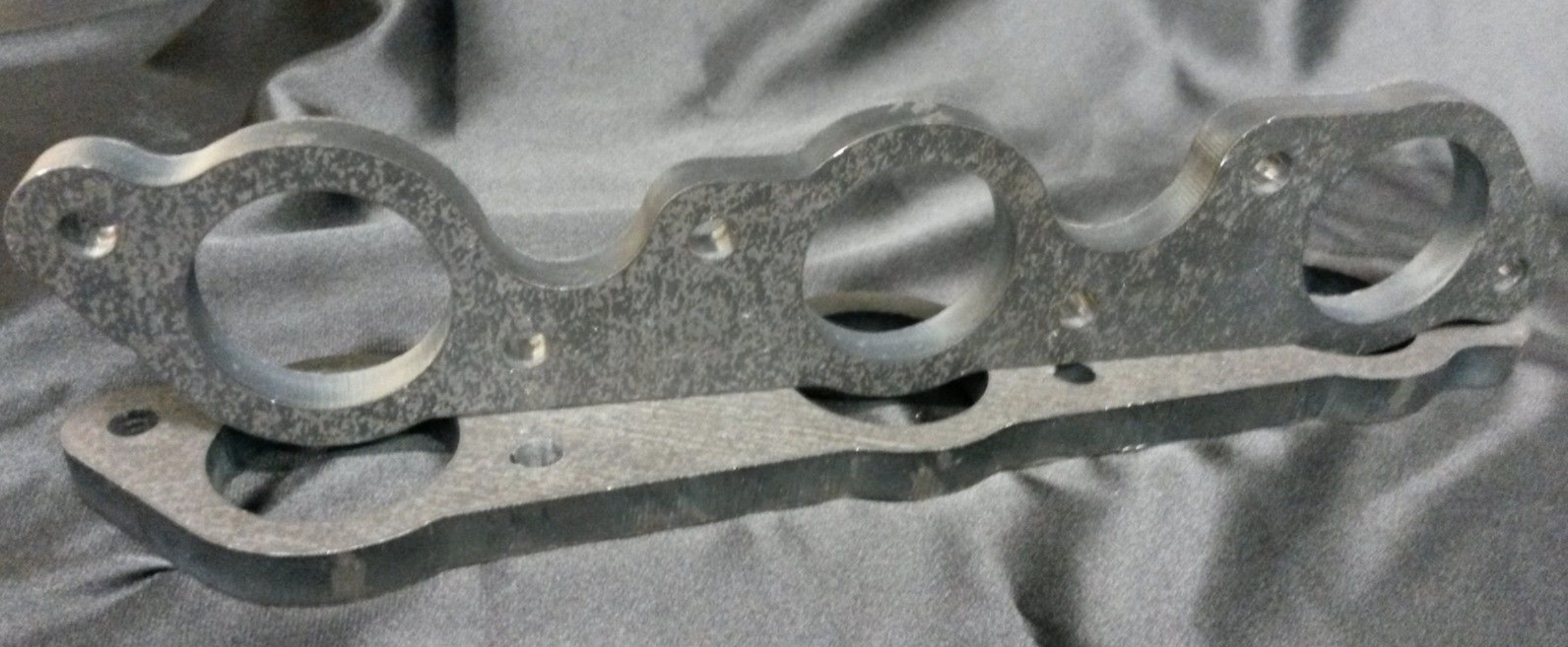

this. is a thing. a thing due on friday.
i have had (forever) a china turbo sitting in my back shed, t03 flange and a heap of weld els (sched 40 bends) and respective -10 hose and weld on fittings, 1/8NPT and dash 4 braided line. i think my weld on fitting *might* be ms and not ally for the ecotec sump though. not that that is much of a problem.
scheduled to go on the VT race car / other VX looking thing i have.
someone said why don't you have anything modified. DAMMIT.
also ; looking for a VN V6 loom, does anyone haz one they do not need?
