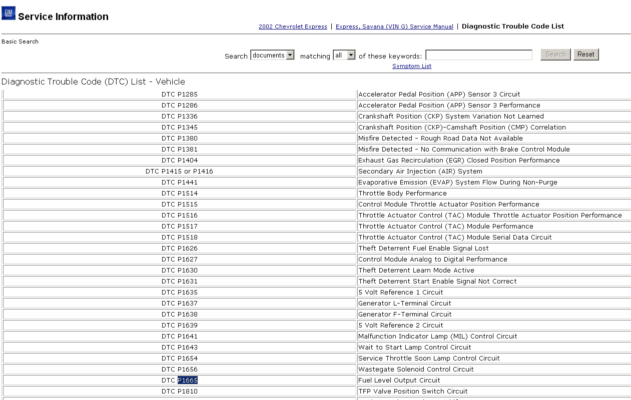

Wierd. Everywhere I google, P1665 is evap vent. My truck is nothing special, its an 0411 swapped 96 gmc sierra, running os 12212156, so it thinks its a 2002 express van with a 5.7.

Odd, could be an error int the documentation I have. Id have to simulate it to the tech2 to confirm. Or even a workshop manual should also confirm actually.pmcquay wrote:Wierd. Everywhere I google, P1665 is evap vent. My truck is nothing special, its an 0411 swapped 96 gmc sierra, running os 12212156, so it thinks its a 2002 express van with a 5.7.

This is an old DVD based copy of SI. Should be accurate enough for a 2002 vehicle.
For reference P0446 is Evap Vent System Performance and P0449 is Evap Vent Solenoid Control Circuit. I can't find an engine oil pressure code for this engine at all.
I noticed similar discrepancies when I was looking through some DTC tables in Universal Patcher.

Very odd!Gatecrasher wrote:This is an old DVD based copy of SI. Should be accurate enough for a 2002 vehicle.
Must be a mistake in the documentation I have!

It looks like GM changed it, maybe you'll need to do a VIN lookup by year, or list it as both.

I actually see the option where it allows redefining the meaning of certain fault codes, its not common but it does appear to actually happen, I have never paid attention to that before!antus wrote:It looks like GM changed it, maybe you'll need to do a VIN lookup by year, or list it as both.
