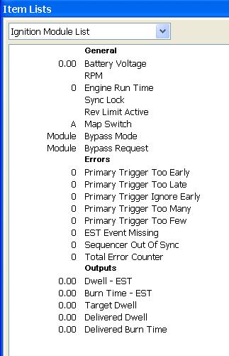

What ignition module parameters do you want to log?Holden202T wrote:So I asked the question about weather the data logger had the ability to log the ignition module and the 808 at the same time ...
- VL400
Re: My Delcoed Rides
Will be logging these things from the ignition module...
