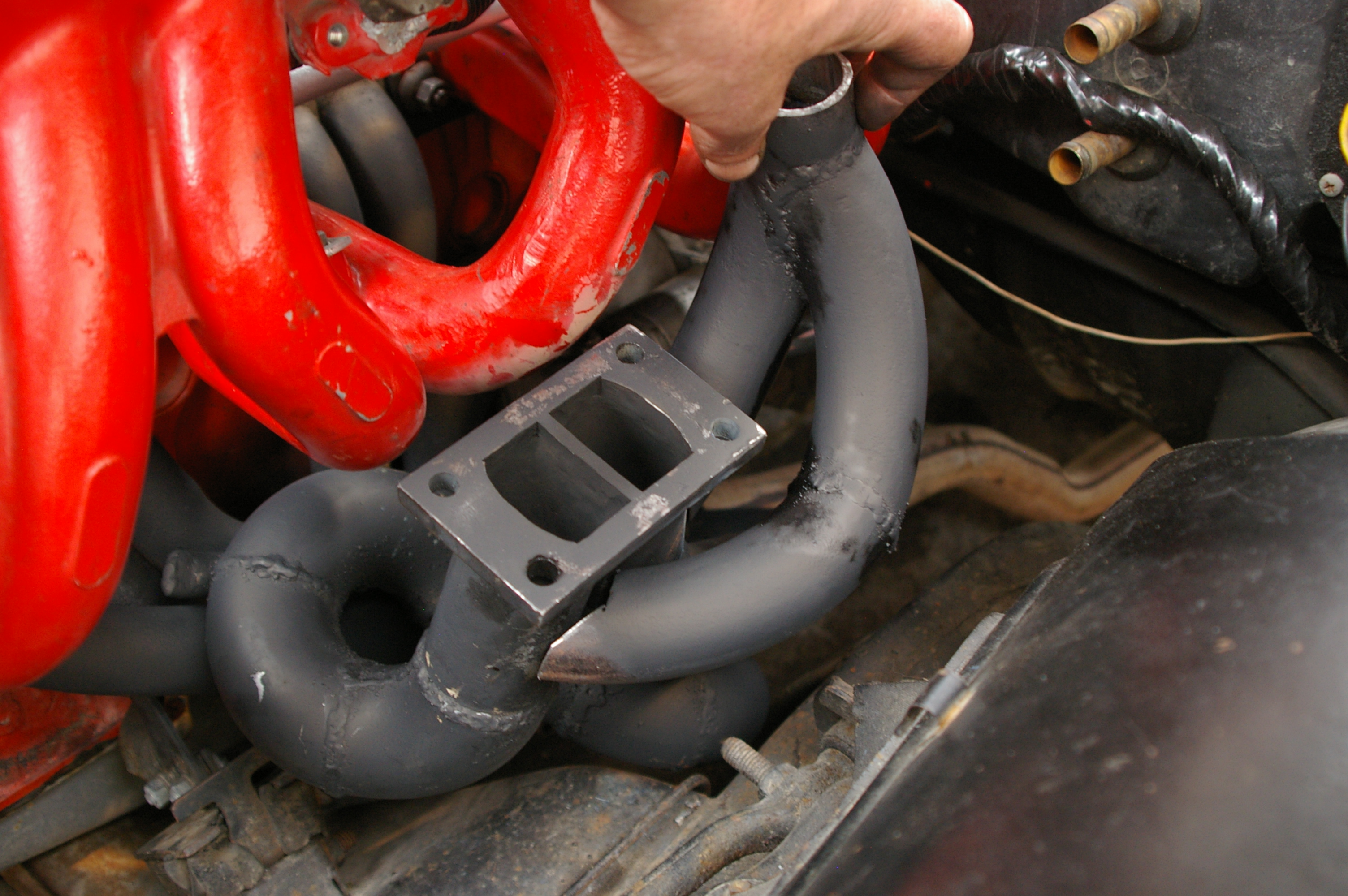

Interesting way of making the manifold, looks good :thumbup:

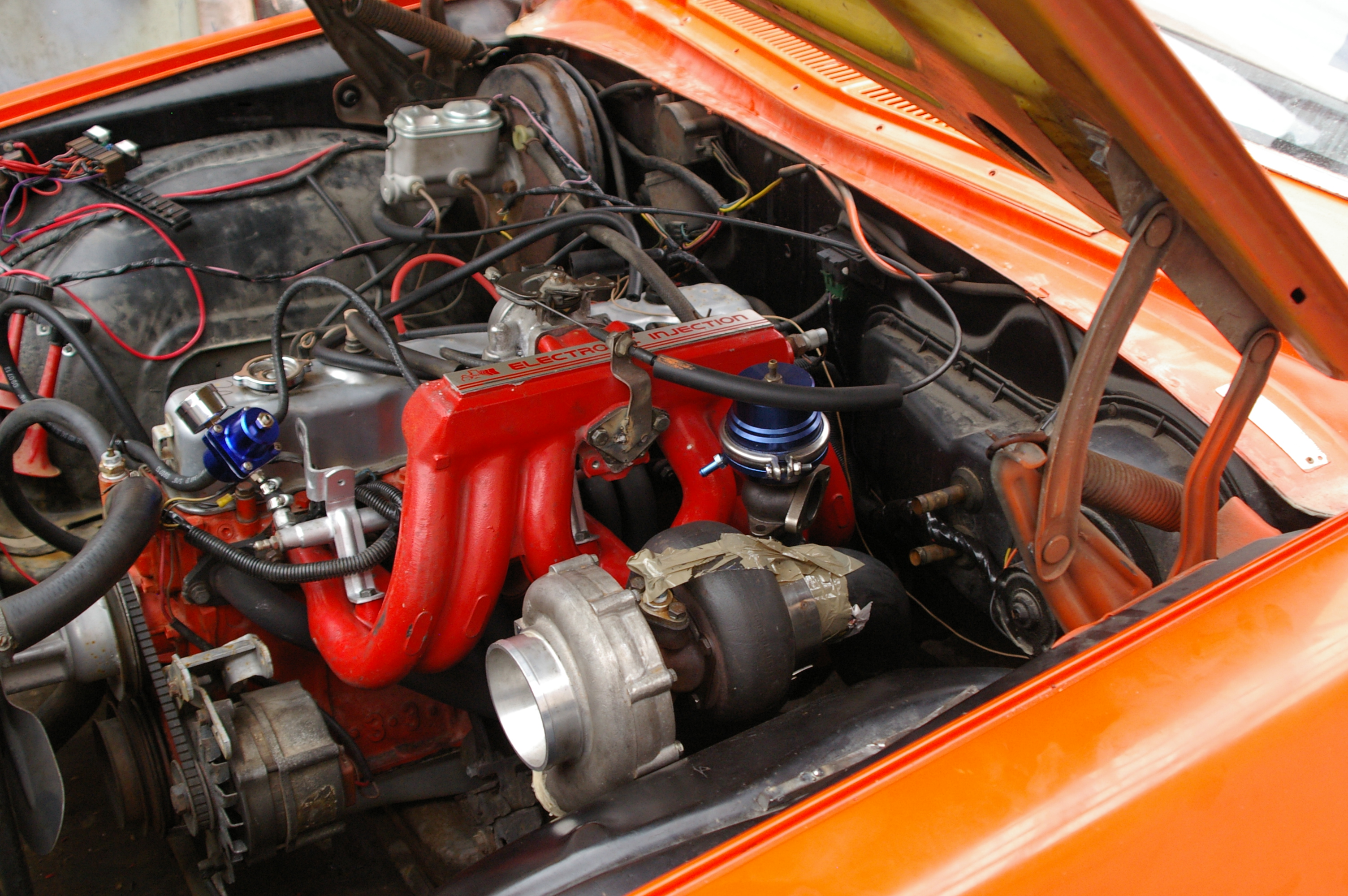

Yeah and thats ar 43psi running pressure think tune needs even more fuel .60lbers arrived yesty that wil help

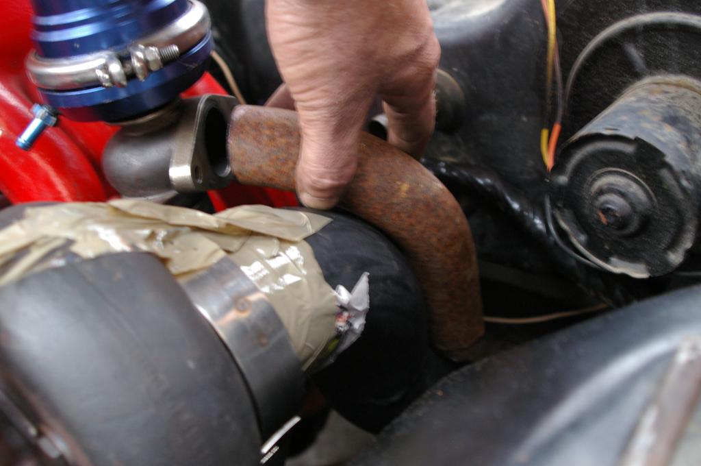

wastegate merge done ready to bore holes and weld on and fit a flange .its not pretty but you dont see most of it with turbo on and i was fast running out of space LOL

some nice lookin pipework there!
Re: DELCOS NEW RIDE
so whats the go with that going to plumb back into the rear of the turbo ?

Re: DELCOS NEW RIDE
like so .excuse the tape lol

Lookin good :thumbup: Sure do run out of room once everything is installed.

if i had of built a completly new steampipe manifold there would be a heap more room .adapting the headers has meant ive used a wastegate spot down out of the way .its all good looks ok and should work and gives everyone somethinng to look at

wastegate outlet be merged back in way down there somewhere
