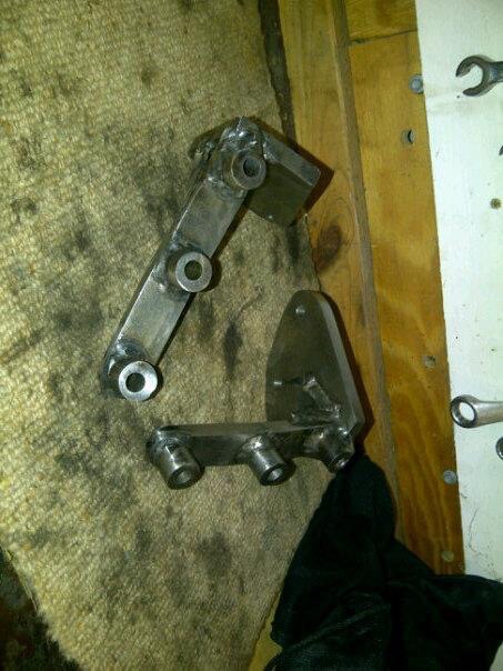

I'm contemplating on using an ecotec sump, does any one have experience will adapting one to pre-ecotec? whats the best way to add the dipstick and I think Ill need to source another for those rocking horse shit T5 ecotec support brackets.
- TdracerTd
- Posts: 488
- Joined: Mon Aug 19, 2013 10:39 pm
Mitsubishi Evo IX
I made a set of those brackets once.
- Posts: 8124
I got originals so maybe I could copy a set from my own if I cant find any.

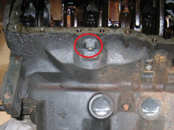

- Posts: 3676
- cars: VH, VN, VS, VX
The V6 engines did have dipsticks in the side of the block for the US market, there is a plug in the side of the block so it may be fairly easy to adapt a ecotec type dipstick.
